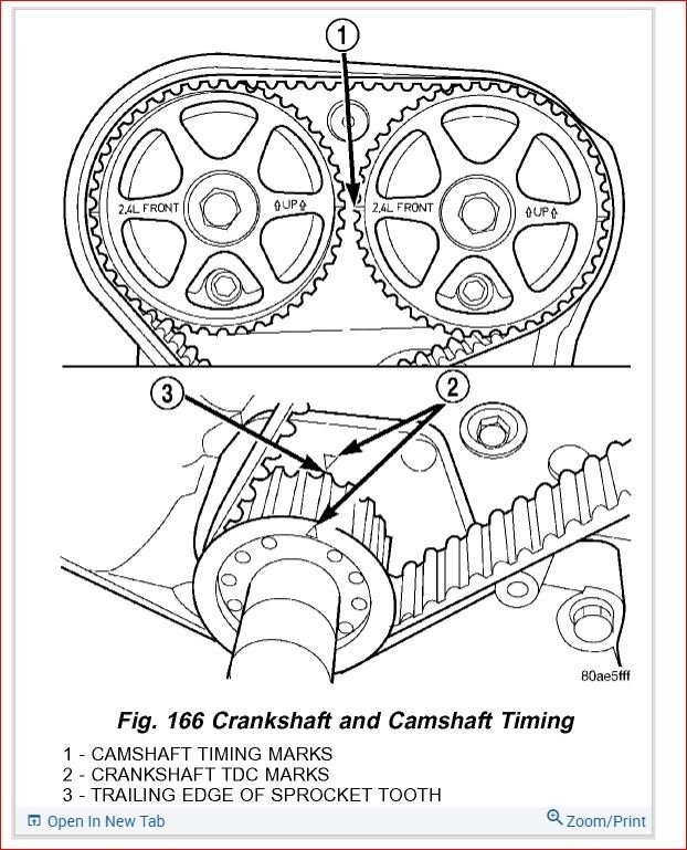

When I bought the car it was going through compression, and it did not turn on, the head was removed from the engine and it was rectified. Then he turned his head, adjust the time and when I started I found this problem.

Can you elaborate on the resetting of the timing? Why did he remove the head again (if he did) and what do you mean by turn the head? Did he mill the head or in other words, cut it down to remove a warp?

I only removed it once to cut it and reinstalled it.
Not two times as the text was translated.
If necessary, if I can correct the synchronization.

Okay. I completely understand.
The thing that worries me is if you milled or cut the cylinder head so that it was no longer warped, that you have effected the timing of the engine.
Do you have any codes in the computer?
When the engine was timed, it should have looked like the attachment. You may want to remove the cover again and check timing. If you cut the head down, you should have offset that difference with a thicker gasket. I guess this can be done even though we don't have a specification but the piston to valve clearance has to remain because this is an interference engine which means they will hit each other if not timed correctly. Clearly they are not making contact but we still may have a timing issue.
Also, we have a rev limiter on this engine that should be set around 4,000 RPM. You are not getting there so that tells me the computer is possibly inducing this issue.
