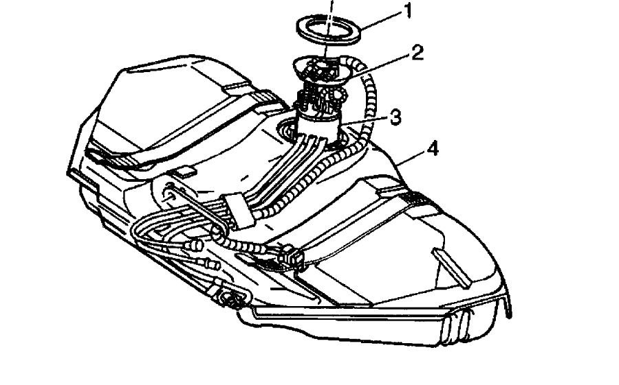

Engine shut off while driving and will not start
LISA1234
  • 1999 CHEVROLET CAVALIER
  • 2.2L
  • 4 CYL
  • 2WD
  • 160 MILES
It is turning over with good power. It acts like no fuel is getting in. Checked fuse in dash and the F/P-INN 15 fuse Keeps blowing. It has blown three times now.

Good afternoon.
The fuse failing tells us you have a short circuit somewhere and that fuse controls the fuel pump.
I would disconnect the fuel pump at the tank and see if the fuse still fails.
Never, never, ever use a larger fuse than what is called for the circuit.
The connector is at the right front of the tank.
Here is a video to help you change the pump out.
https://youtu.be/Lhd0vd8pdBU
