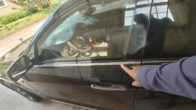

how do I replace the front and back doors Sealing Strip? Front and Rear Side Door Window outer/part numbers are GM 15224676 and GM 25812177. I have them and no instructions to remove the ones off of my car. it's the ones on the door up against the windows.

Can you upload an image of the weatherstrip? If it is the one at the top of the door panel it is part of the door panel. If the weather strip is for the complete door (all the way around) it just pulls off and presses back on.

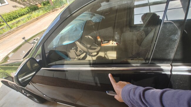

this is the one i need to replace. I got great ones from pull a part for 1.95 each. so, I got two for each window I replaced the driver side rear however the driver side front looks a little more difficult the cars I got them from were already taken apart with mirrors off and inside panels off.

Yes, to replace this weather stripping you will need to remove the inner door panel, mirror and possibly the window itself. Thanks for the images, they helped.
