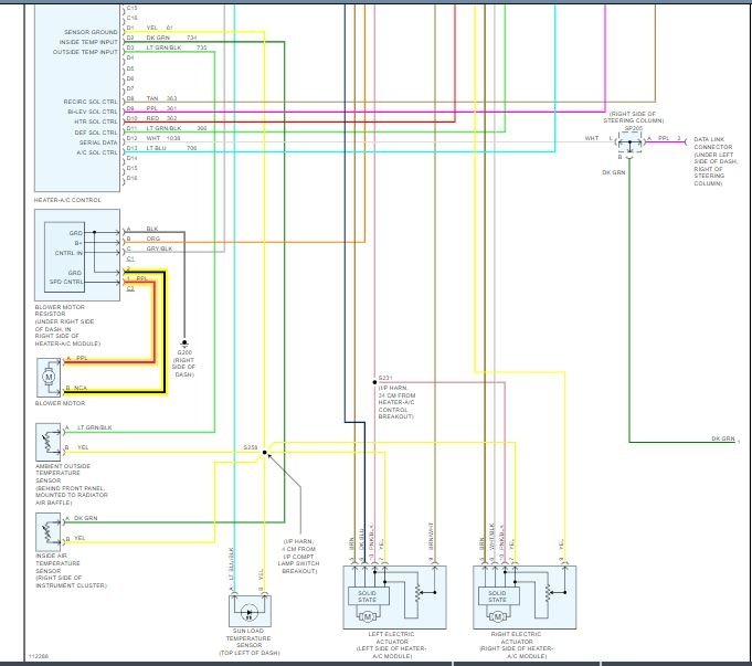

The digital climate control heater lights up fine, but nothing seems to come out the vents and no sound at all, the defrost and heater doesn't work, no heat. I replaced thermostat last month. all fluids are fine, I use 50/50 anti antifreeze, What are estimates if i need parts or if i can easy fix myself how to fix it myself? please get back to me soon, please include a video so i can watch. thanks Alicia
Please show me what steps to check before all repairs thanks.

Good morning,
From your description, it sounds like your blower motor is not working.
https://www.2carpros.com/articles/low-or-no-air-flow-from-vents
https://www.2carpros.com/articles/blower-fan-motor-works-on-high-speed-only

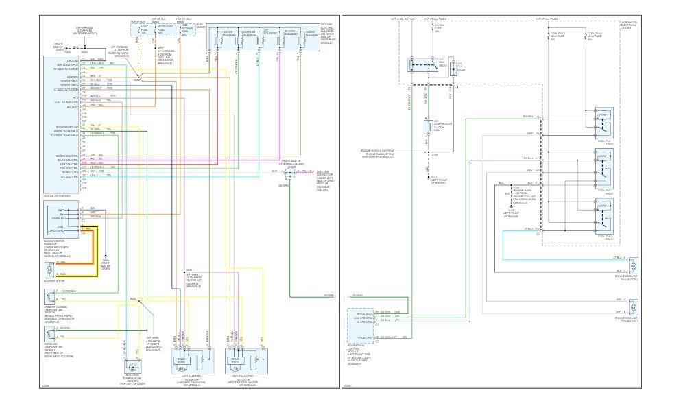

I will attach a wiring diagram for you to view. You will need a voltmeter or test light to do some checks.

Thanks Roy, I just got done fixing the problem, the only differences was with the new heater motor blower is there's two different holes to attach the rubber hose that connects to the motor blower and then hook it back behind the blower that the diagram didn't show in your message, but I figured that part on my own. LOL
But it does kind of work, it just doesn't hard enough through the vents after I installed it. I made sure all vents are opened and they are. But the defroster works but not coming through the front vents as hard as they should come out like they do for defroster? If you have a suggestion, I'm open to hearing what you have to say. Thanks Roy. Alicia
Mar 7, 2019 at 6:22 AM
How does the air blow on the floor?
Do all the blower speeds work correctly?
