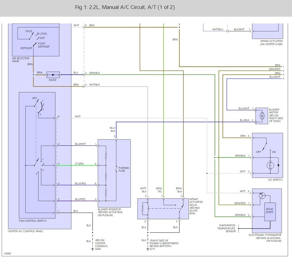

the dashboard fan stopped working. when you turn it on the fan does not come on. do I need a new fan put in? Or do I need a new fuse for the fan?

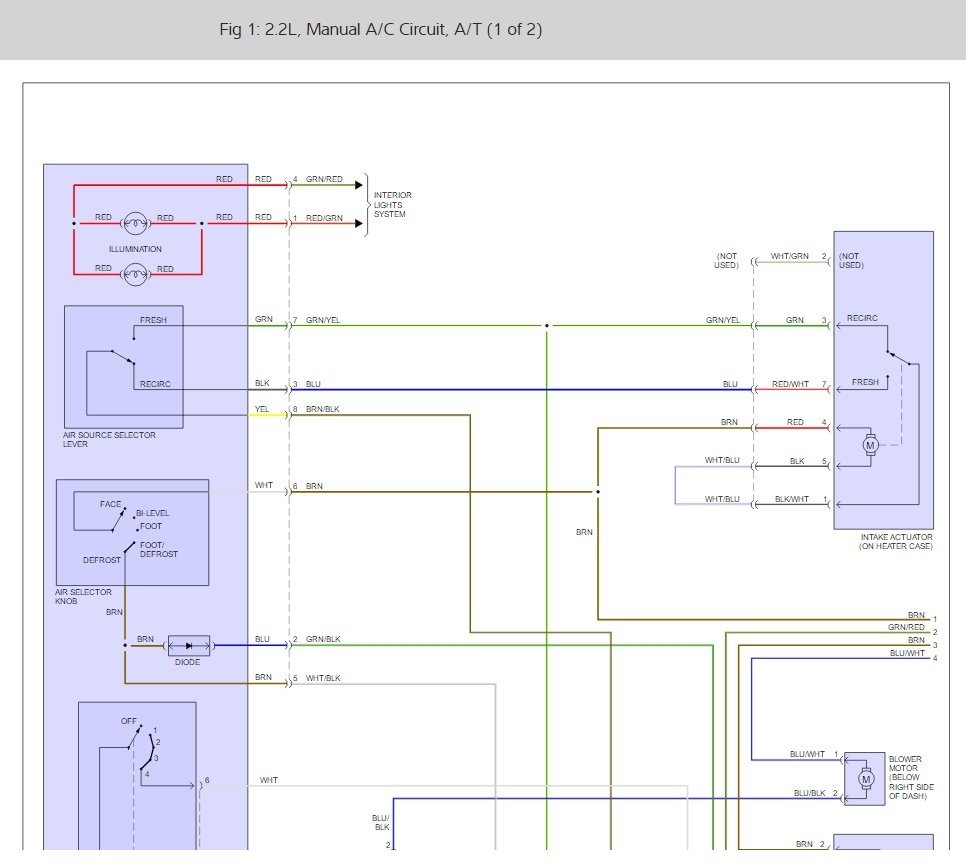

It sounds like you have a blower motor that has burned out. Here is some guides and a blower motor wiring diagram (BELOW) that should help you get the problem fixed.
https://www.2carpros.com/articles/blower-fan-motor-works-on-high-speed-only
and
So you can do some testing
