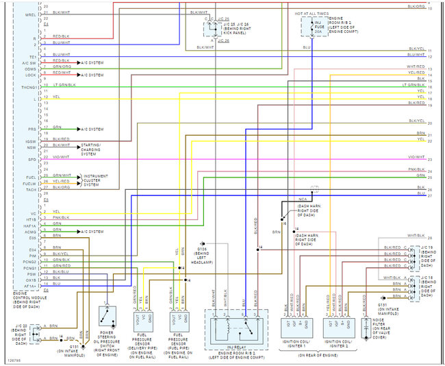

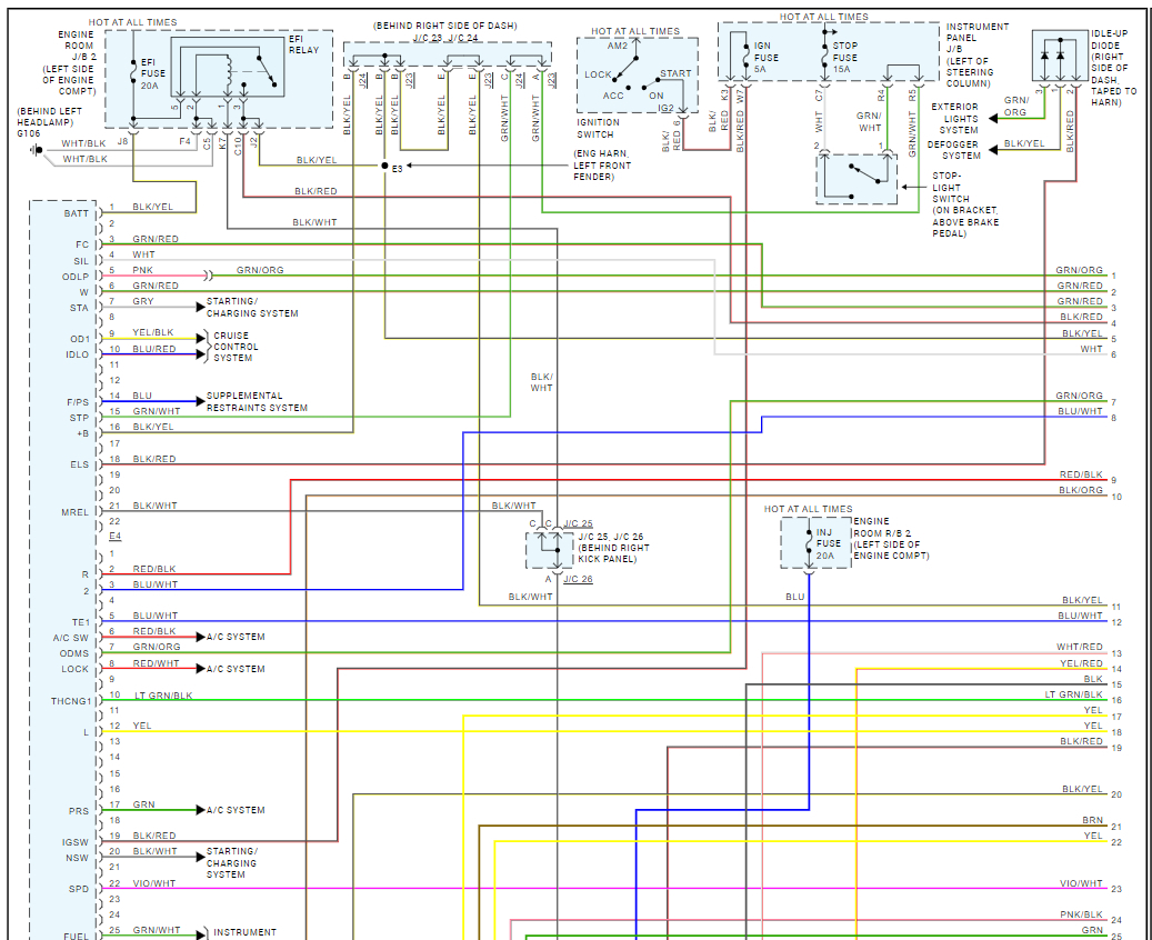

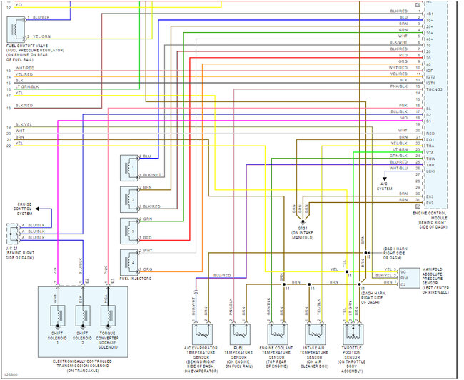

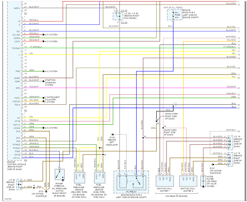

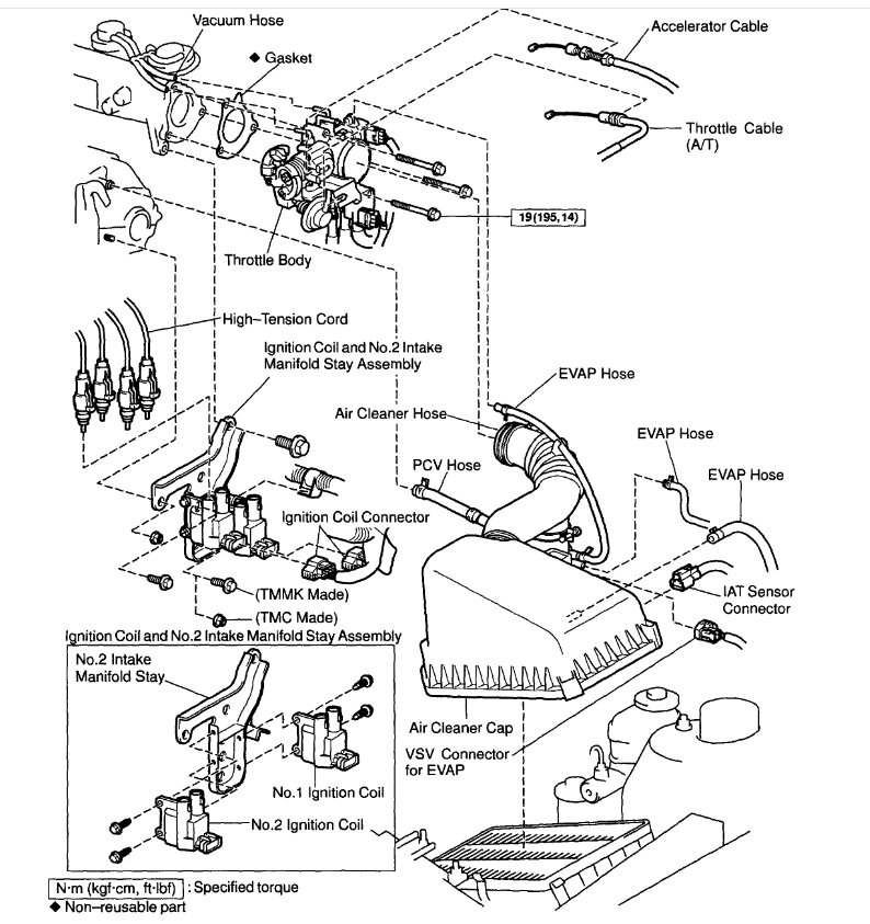

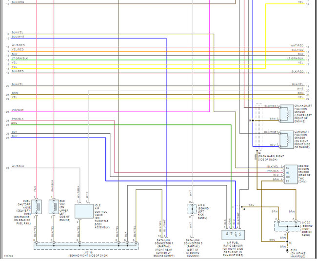

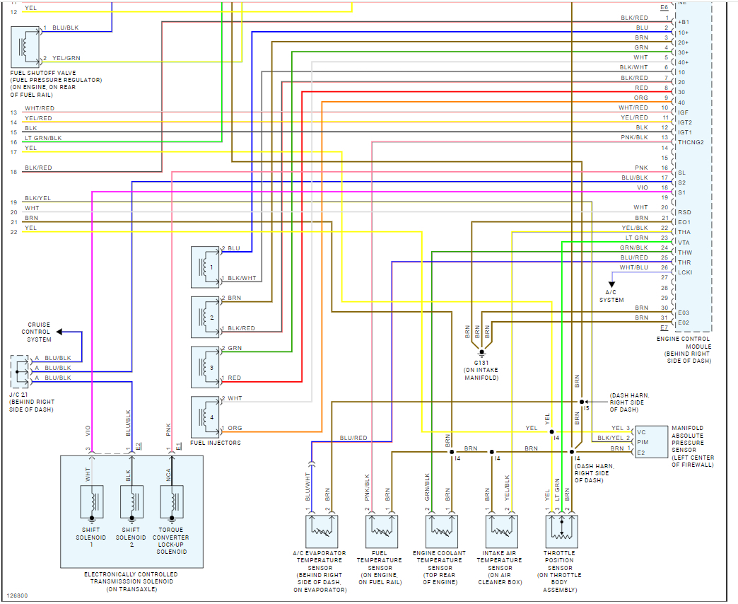

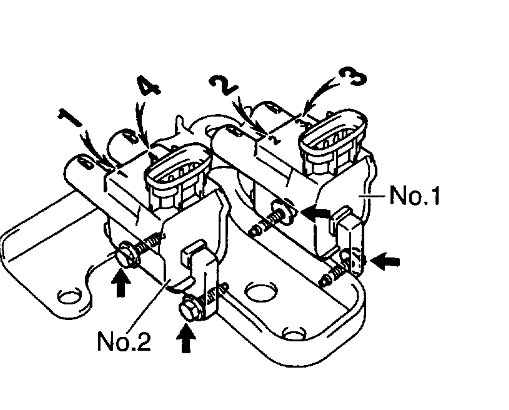

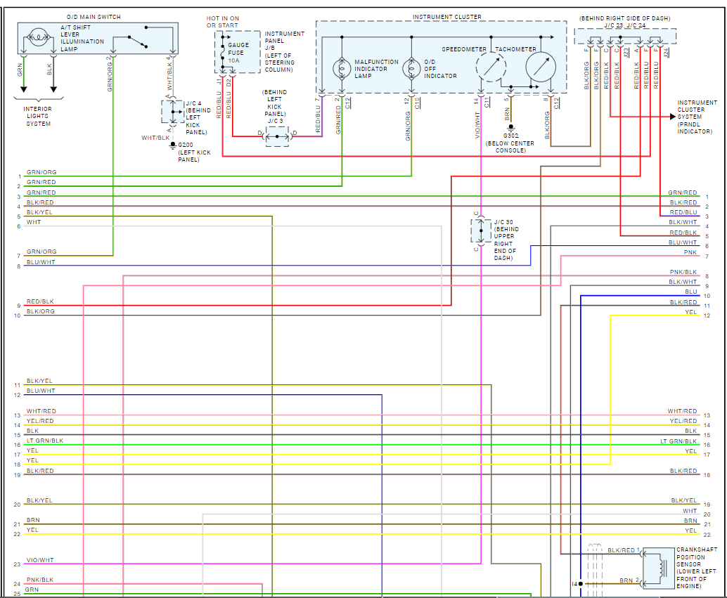

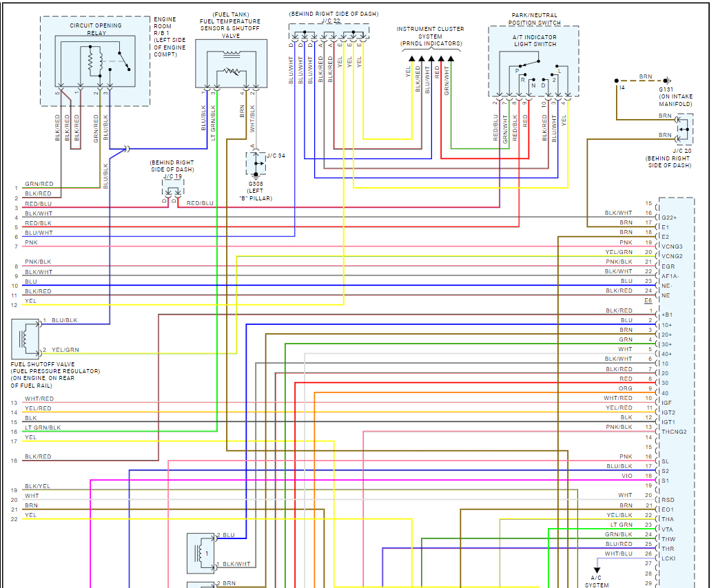

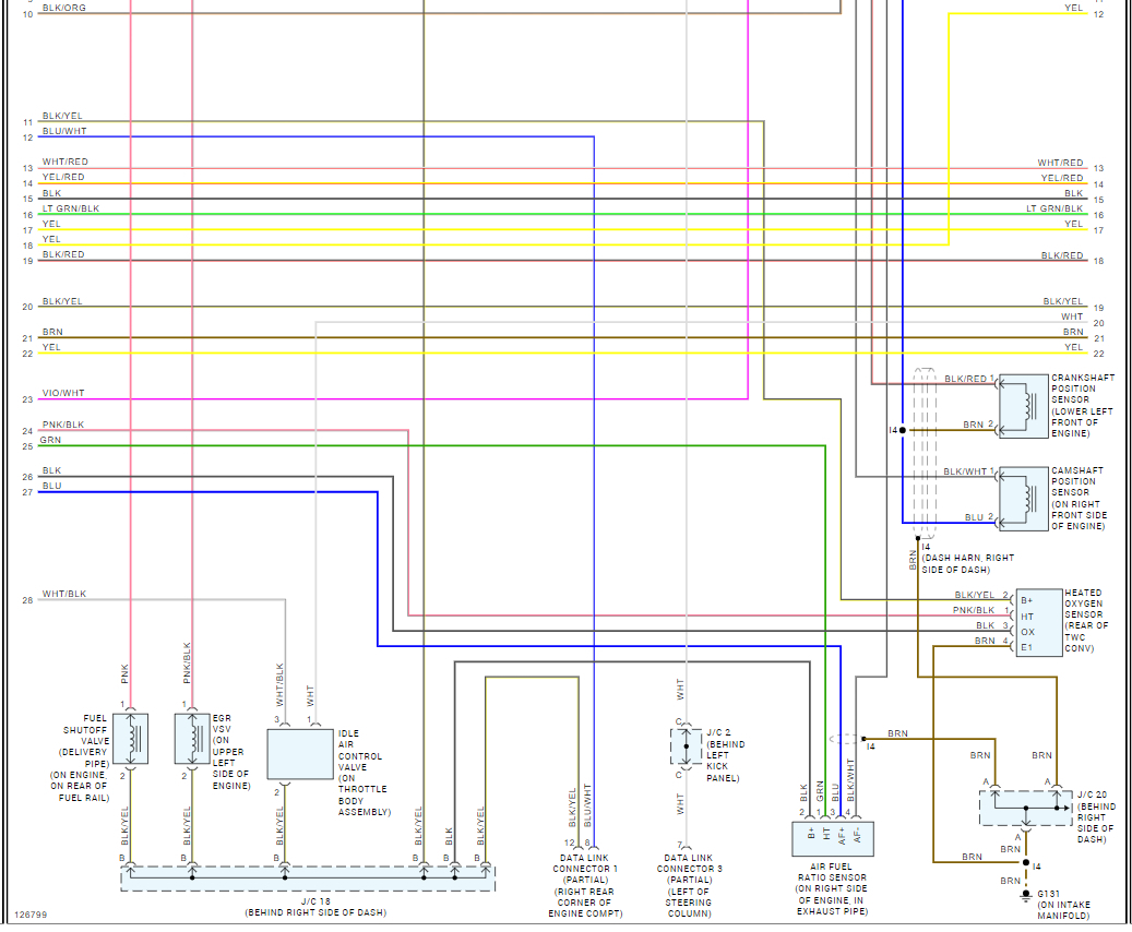

Hello, cylinder number one and four are not contributing power to the engine. It seems that there is a problem with the wiring. Could I have the wire diagram for the ignition system?
Oct 5, 2024 at 2:14 PM
  • 55,220 POSTS
It sounds like one of the ignitor coils is not working or the plugs wires/spark plugs need to be replaced. Here is the engine and ignition system wrong so you can check it out. Also, this guide can help with the engine misfires:

The major problem was that cylinder 1 fuel injector was partially bad.
