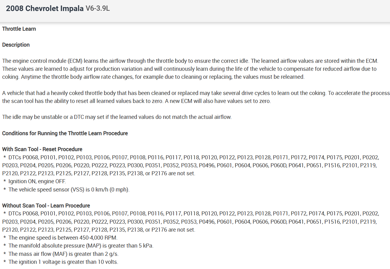

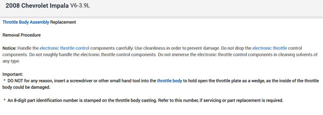

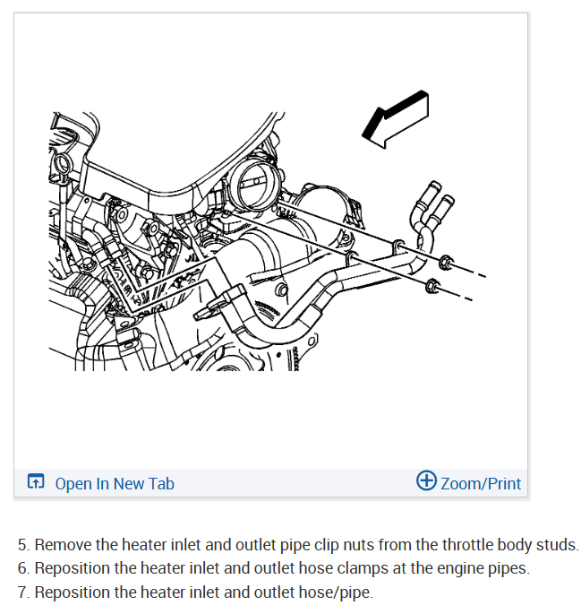

  • 55,423 POSTS

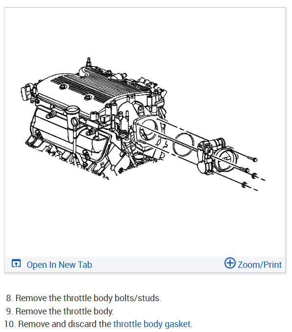

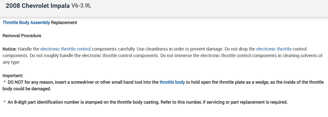

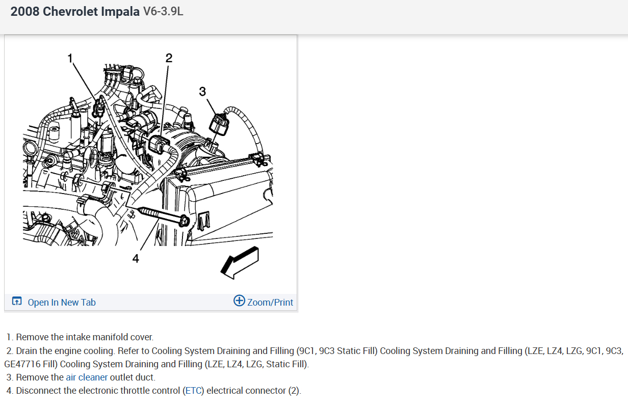

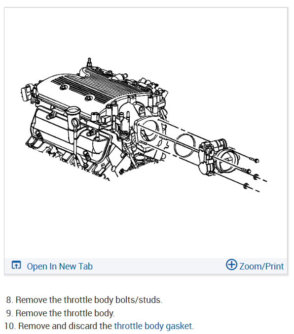

Please give me the code numbers so I can help you. I can tell you that the limp mode can be caused by a bad throttle body or if it needs to be cleaned which you can try first.
Here are two guides to help us while you get me the code numbers:
https://www.2carpros.com/articles/reduced-power-limp-mode
and
Here is how to service the throttle body on your car. Check out the images (below). Please let us know what happens.
Dec 7, 2024 at 3:23 AM (Merged)

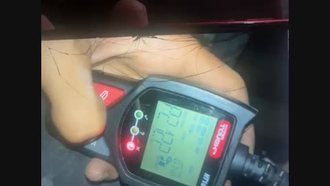

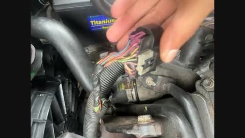

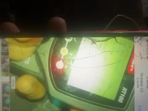

I have a couple of codes, here’s the video I’m going to go check the codes again when I get off work, I haven’t been driving car since then.
  • 55,423 POSTS
Sounds good, I can't read the codes. Can you please list them in your post?
MERE
  • 17 POSTS
P2122
P0452
P0641

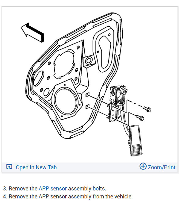

  • 55,423 POSTS

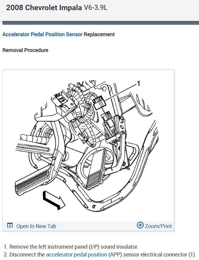

So the first code will cause the problem and the third code, let's try replacing the accelerator pedal sensor and then clear the codes.
P2122 - Throttle/Pedal Position Sensor/Switch 'D' Circuit Low Input
P0452 - Evaporative Emission System Pressure Sensor/Switch Low Input
P0641 - Sensor Reference Voltage 'A' Circuit/Open
Here is how to replace the part in question. Check out the images (below). Please let us know what happens.

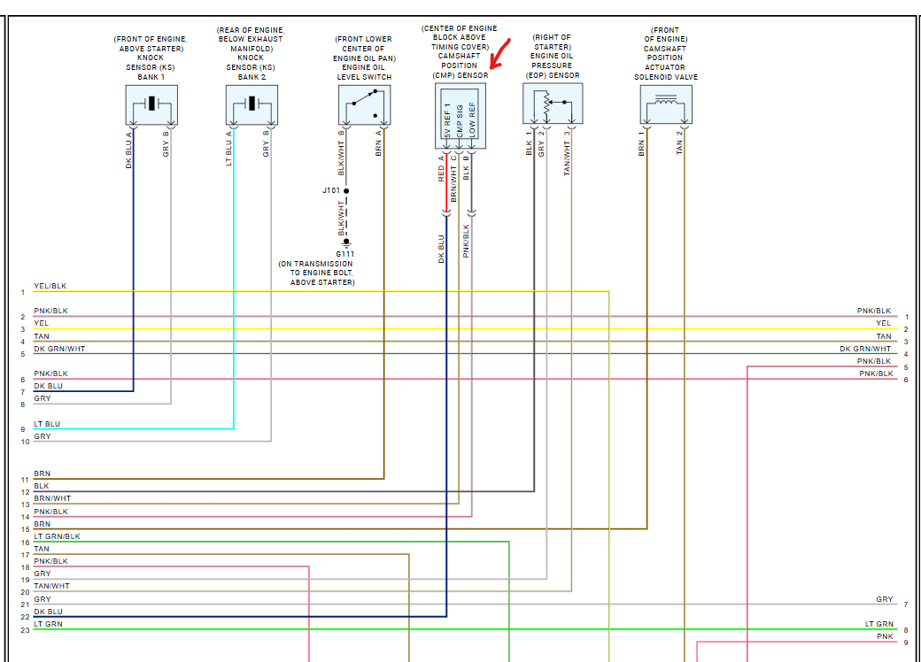

  • 55,423 POSTS
Here is the camshaft sensor wiring.
Dec 7, 2024 at 4:17 AM

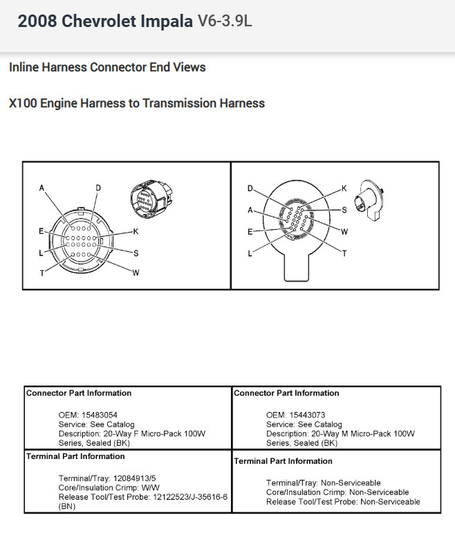

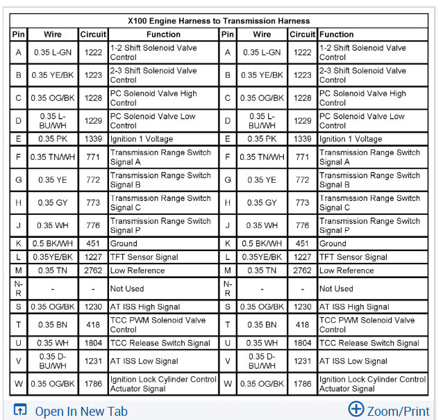

I know I have that. thanks, though I cannot find what wire color the x100 connector is, any help on that?
Dec 7, 2024 at 4:19 AM
  • 55,423 POSTS
Sure, can I ask what the connector plugs into? here is the x100 connector info. Check out the images (below). Please let us know what happens.
Dec 7, 2024 at 4:50 AM

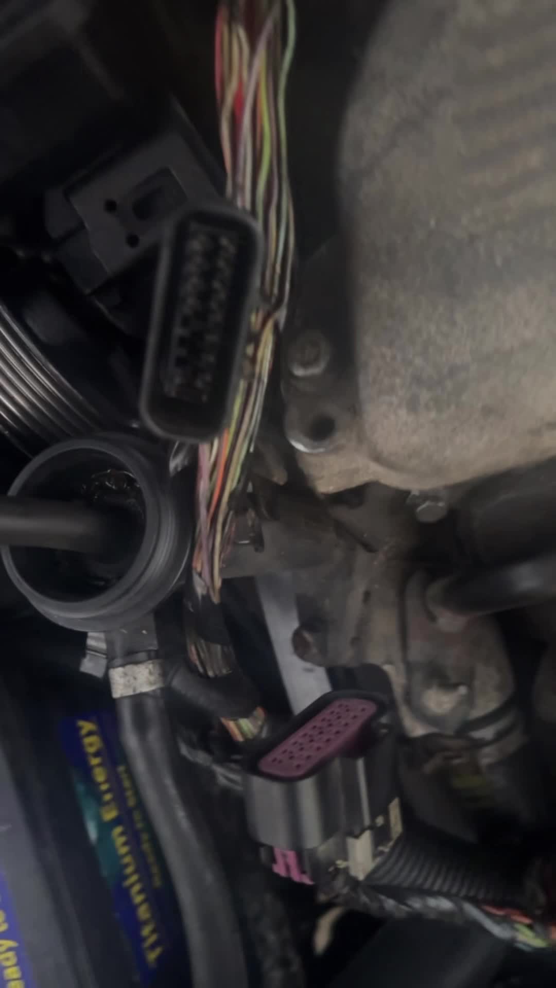

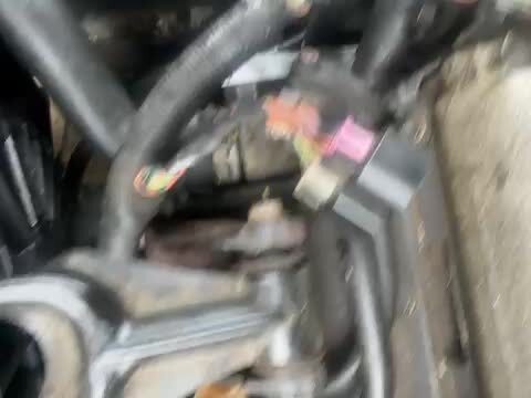

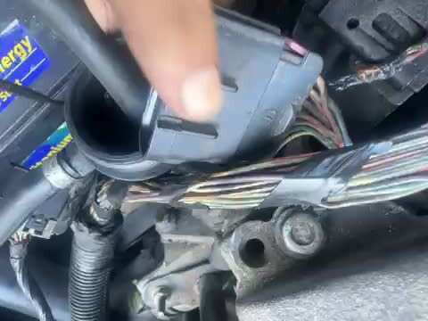

MERE
  • 17 POSTS

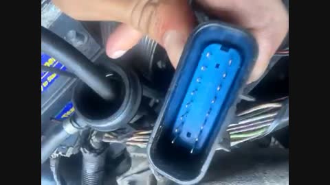

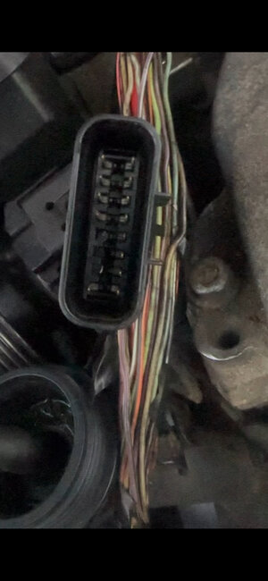

Would you happen to know what this plug is called? It’s a 16-pin right near the power steering pump.
Dec 8, 2024 at 12:09 PM
  • 55,423 POSTS
It must be a main engine wiring harness connector; can you tell me the colors of the wires so I can look them up? Thanks for the video, it helped.
Dec 9, 2024 at 12:46 AM

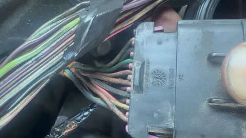

It’s like 16 colors lol I am going to try to check in a few. it’s raining. I see green, purple, black, white, red, probably got a whole rainbow there.
Dec 9, 2024 at 12:57 AM

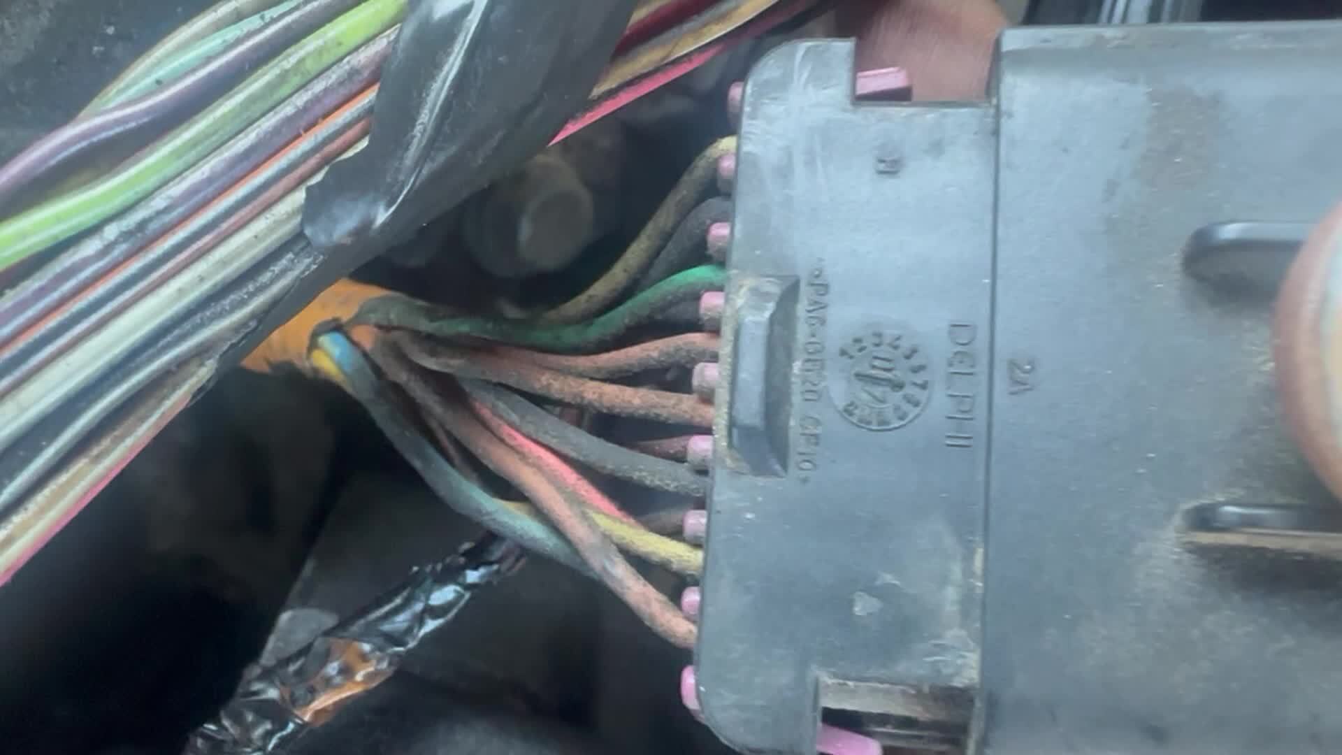

MERE
  • 17 POSTS

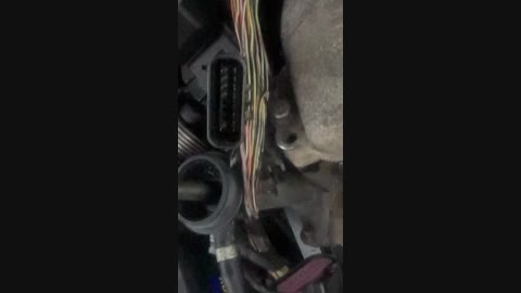

Here’s the back of the connector if this helps.
Dec 9, 2024 at 6:25 AM
  • 55,423 POSTS
Can you take a picture of the wires in the connector?
Dec 10, 2024 at 2:03 AM

  • 55,423 POSTS
The connector does not matter just the wiring colors which I can see, please take still shots that don't move around.
Dec 11, 2024 at 1:54 AM
MERE
  • 17 POSTS
Yes, that’s what I was talking about what wire goes where.
