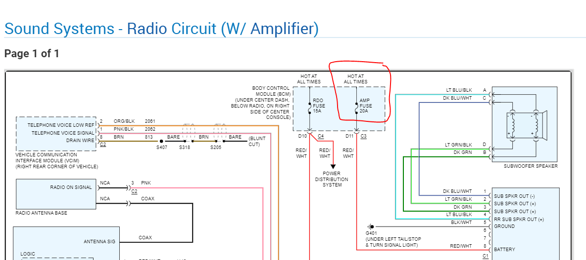

The unit turns on, the volume dials show increase when applied but there is no sound. What could be causing this? It is a 4-speaker system but none of the speakers are producing sound. You guys provide outstanding trouble shooting advice please help me out with this situation. Thank you, Bob.

Many of these have a separate amp. Do you know if your vehicle has one? If it does, have you checked the fuse for the amp? (See pic below)
See pic below.

Joe, fuse #6 (AMP.FUSE) wasn't blown. I lost the fuse trying to put it back. It's a 20amp. fuse. Do you think a service light will now appear since there is not a fuse in the fuse block now? What can be causing no sound? Everything seems fine, but the speakers aren't working. What's your opinion? BOB.

No, that shouldn't turn the check engine light on. I was thinking the amp itself, which is what produces the sound may have failed.
Do me a favor. If you have a test lamp, check where the fuse goes to see if there is power present. Also, don't worry about the fuse being out. It won't hurt anything, but the radio won't work. (Which is already the problem).
Here is a link that explains how to test for power:
