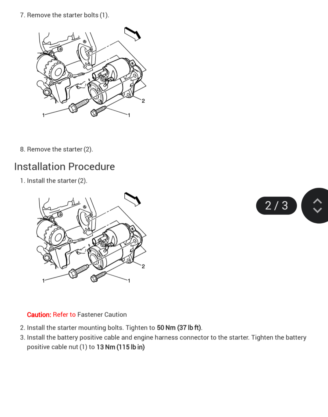

Hello! I pulled into the garage and turned off the engine. Two weeks later, it wouldn't start. The battery is almost new; I removed the negative terminal cables, recharged it, and checked it. It's fine. When I turn the ignition on, all the dashboard lights are fine, the headlights are on, and I can hear the fuel pump running. The starter is dead; it won't turn over at all. There are no auto repair shops in my area. Could you please tell me how to get to the starter? What's the disassembly procedure?

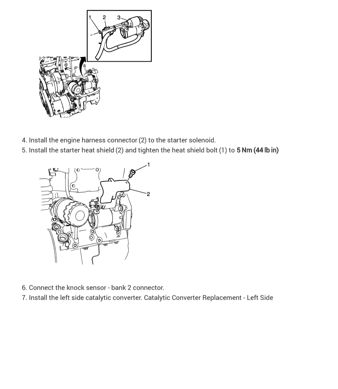

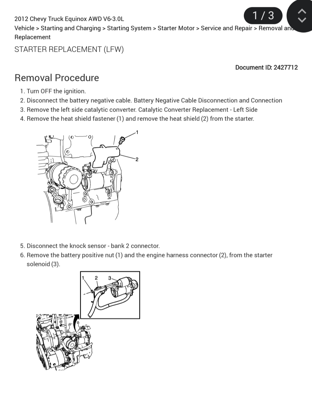

Attached is the process to remove the starter.

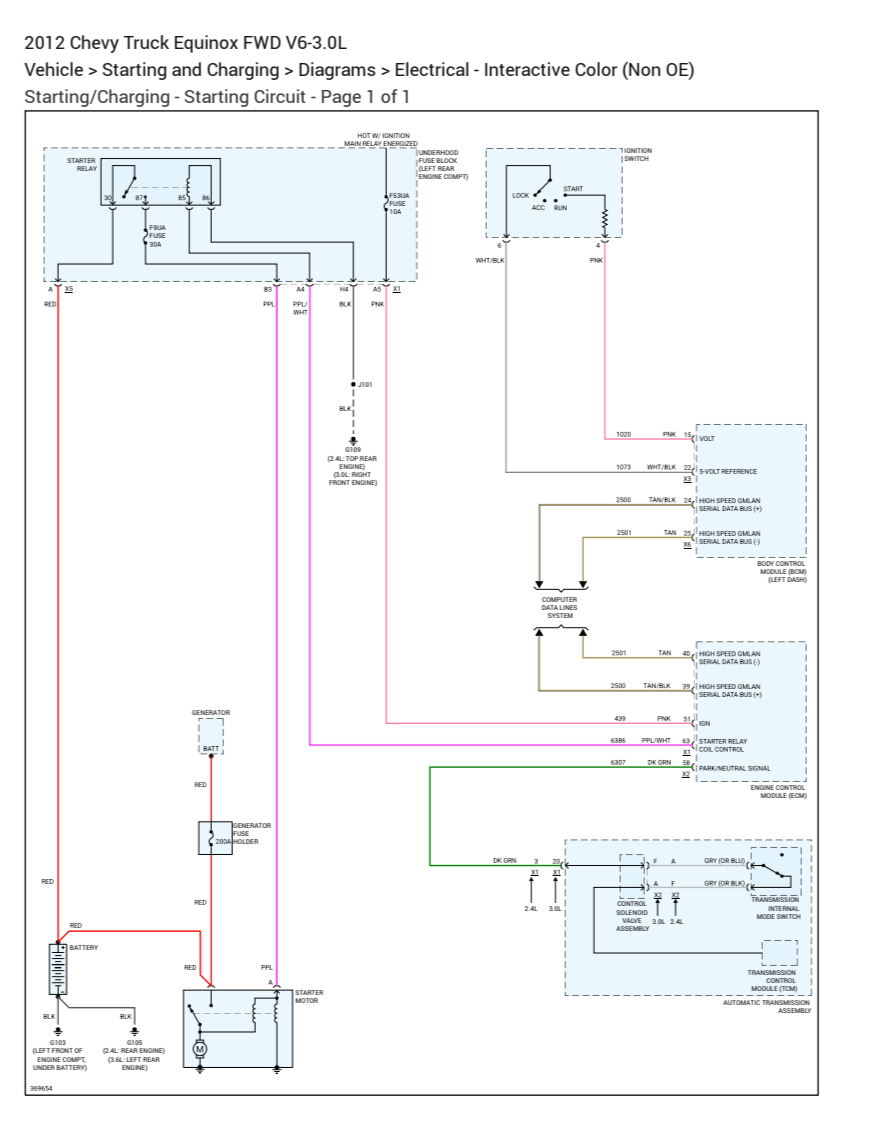

Hi! Thanks for your help! Could you also send me the starter's electrical circuit diagram?

Attached is the starting circuit.
