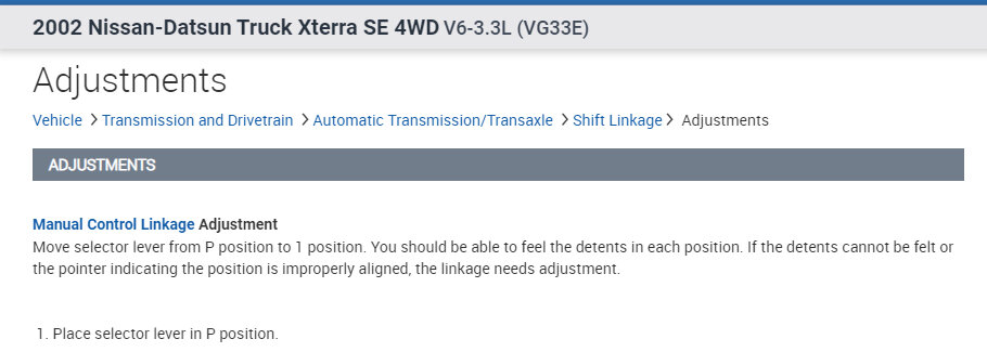

The car will go into drive and drive forward, but I put it in reverse, and it does not budge an inch to come on?
2002 NISSAN XTERRA
223,000 MILES • 3.7L • 4WD • AUTOMATIC
D_LIBBERT07
The car will go into drive and drive forward, but I put it in reverse and it does not budge a inch to come on.
Aug 22, 2023 at 7:06 PM
  • 110,194 POSTS
This could be the result of a few things. Have you confirmed the transmission fluid is both clean and full? Here is a link that explains how to check. Additionally, take a look through the other link.
https://www.2carpros.com/articles/how-to-check-and-add-transmission-fluid
https://www.2carpros.com/articles/how-to-diagnose-and-fix-an-automatic-transmission-that-wont-engage-gears

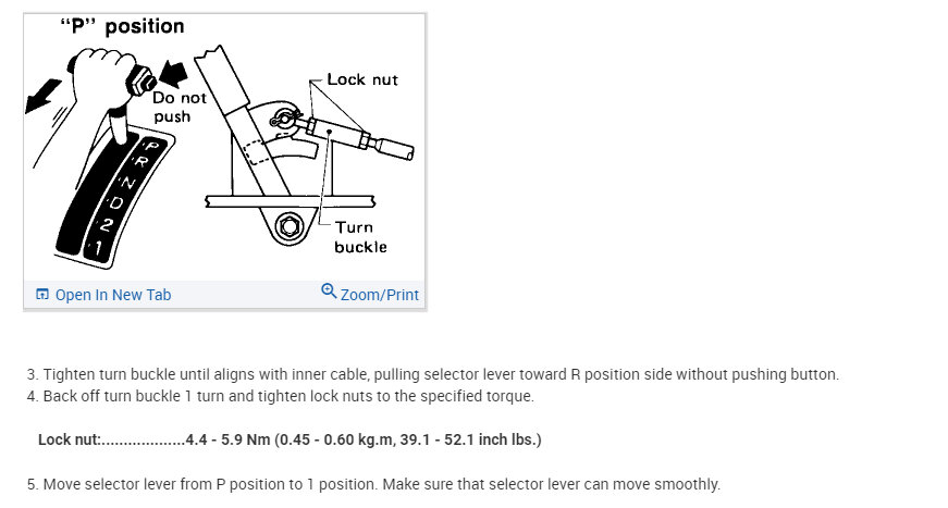

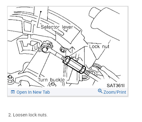

Next, if the fluid is both clean and full, confirm the shift linkage is properly adjusted. See pics below.
Start with this and let me know what you find.
