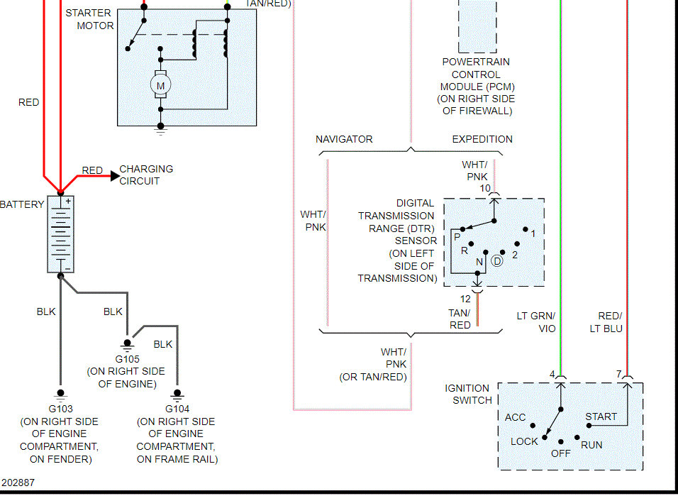

I have replaced a bad starter after having it tested, but the new will not engage unless the starter is jumped from the battery. What should I check first as in ignition switch? any known fuses? I have swapped the starter relay with the accessory delay relay and result. Just need some advice on where to start. Appreciate any help.
Feb 1, 2020 at 9:22 PM
  • 110,194 POSTS

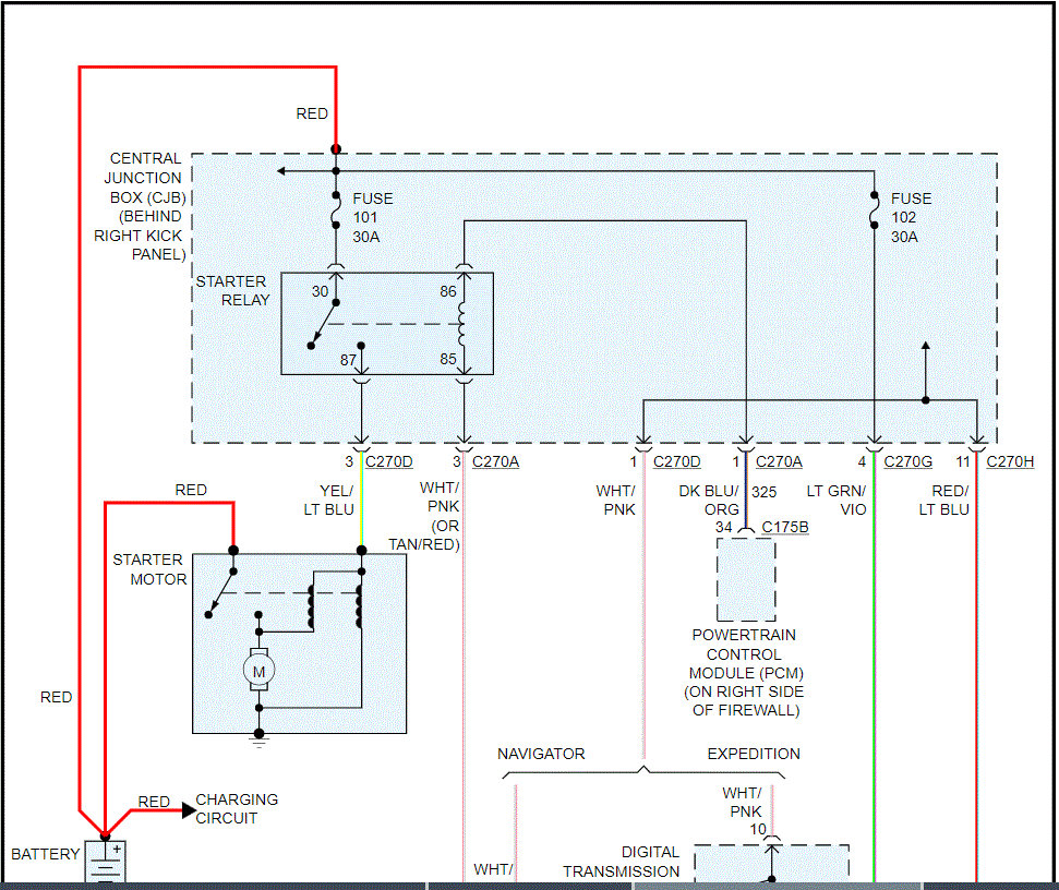

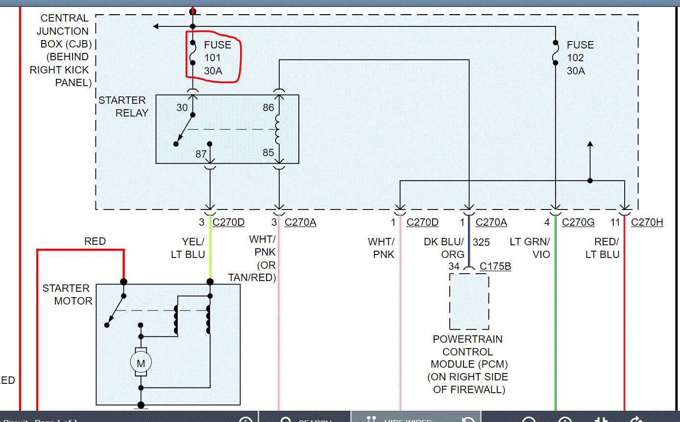

There is a fuse that powers the relay. It is fuse 101 (30 amp) see the attached pic.
Next, this can be related to a neutral safety switch. Try placing the shifter in neutral to see if it works.
Pics 2 and 3 are the entire starting system. I had to cut it in two to make it readable. I did overlap the pics so you could follow them. Also, let me know if there is any noise when you try starting it.
Do me one other favor. Confirm that the gear indicator is showing park when it is in park. Also, here is a link that discusses how to check a starter and wiring. In addition, I added a few links you may find helpful when testing and checking.

Yes that was the problem fuse 101. There is a bigger shutting off problem. however, after driving some the car will go shut off, but will start back afterwards. Sometimes the car will a while to start back up but sometimes immediate. Any ideas for what this is?
