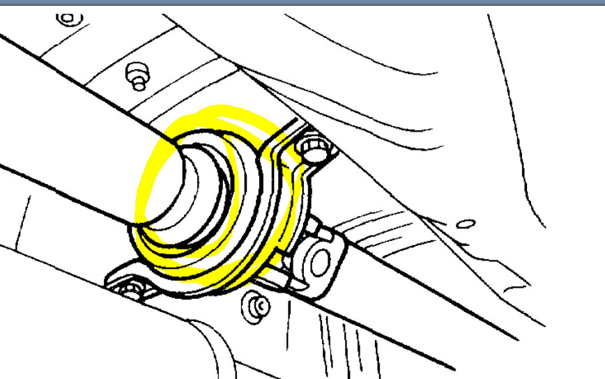

When I release some pressure from the gas pedal to slow down, I feel the car gives slight jerks or jumps. It's happening on and off and seems to be doing it when in the fourth gear and shifting down when gas pedal is decelerated to slow down. Is my transmission going out soon?
Dec 12, 2022 at 10:14 AM
  • 110,244 POSTS
By design, the transmission downshifts when you release the throttle and slow down. However, you normally wouldn't feel it.
Have you checked the fluid to make sure it is both clean and full?
https://www.2carpros.com/articles/how-to-check-and-add-transmission-fluid

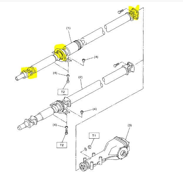

Also, the idea that it only does it in 4th gear is odd. It could even be a failing universal joint or center bearing. In pic 1 below, I highlighted the center bearing and both universal joints. You can inspect those for evidence of wear. Also, pic 2 shows the carrier bearing. That can certainly cause what you described.
The bearing in the carrier is mounted in rubber, so check to see if anything is worn or loose.
Let me know what you find.
