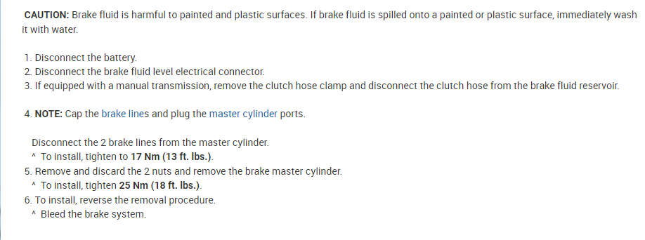

the problem is that the brake pedal is low ... i tried bleeding the brakes its becoming okey for 2 or 3 days and after that it returns low again .. soo anyone faced a similar problem ??

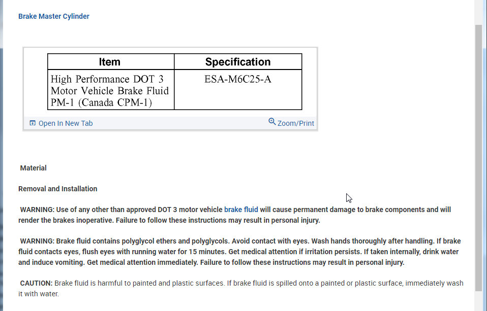

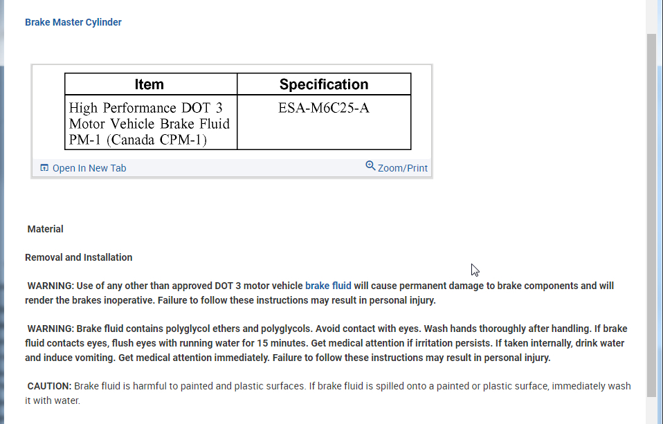

I suspect we have an issue with the master cylinder since the issue gets better but then returns. I suspect the master has a leak and it is allowing air into the system.
Here is a guide that will help with replacing it.
https://www.2carpros.com/articles/how-to-replace-a-brake-master-cylinder
Below is the info from the manual on how to replace this as well.
Let us know if you have questions. Thanks
