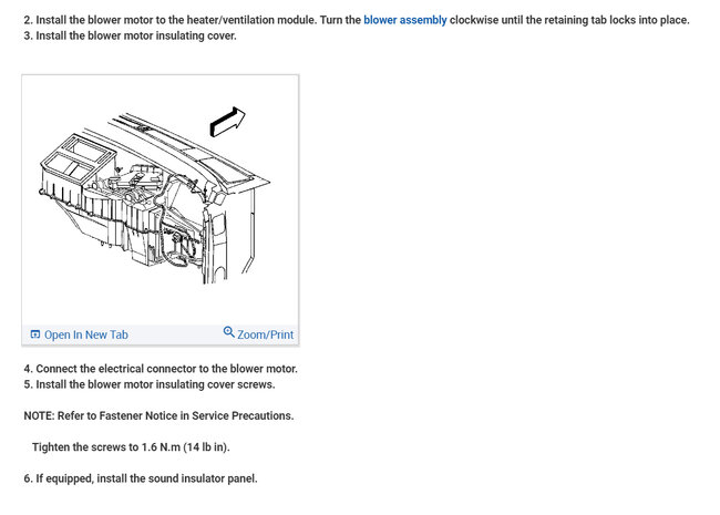

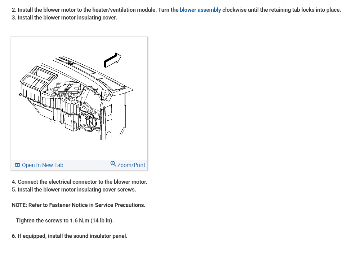

So I’ve replaced the blower motor control processor because it wouldn’t blow any air and now it blows air but when I turn the truck off the air won’t shut off, what could it be?
Dec 22, 2022 at 9:33 AM
  • 55,256 POSTS

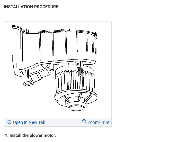

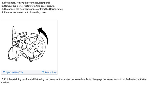

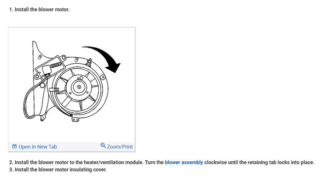

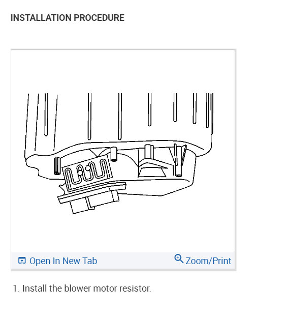

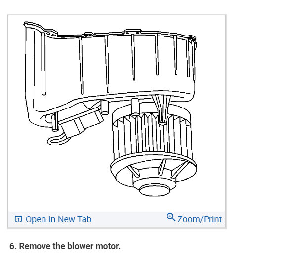

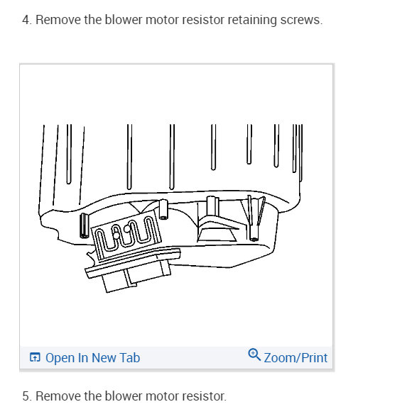

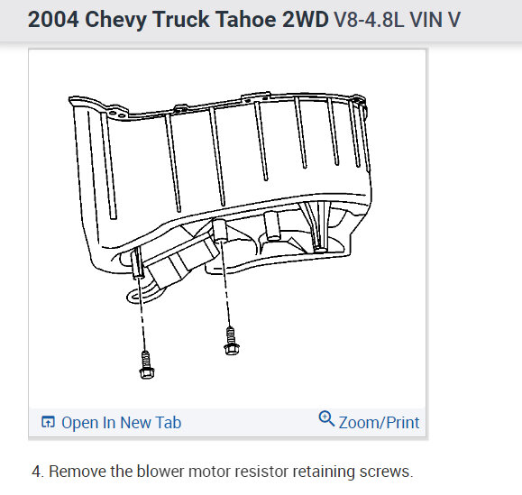

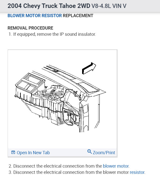

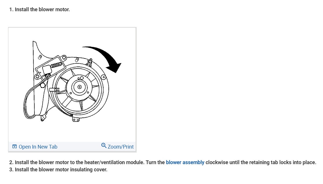

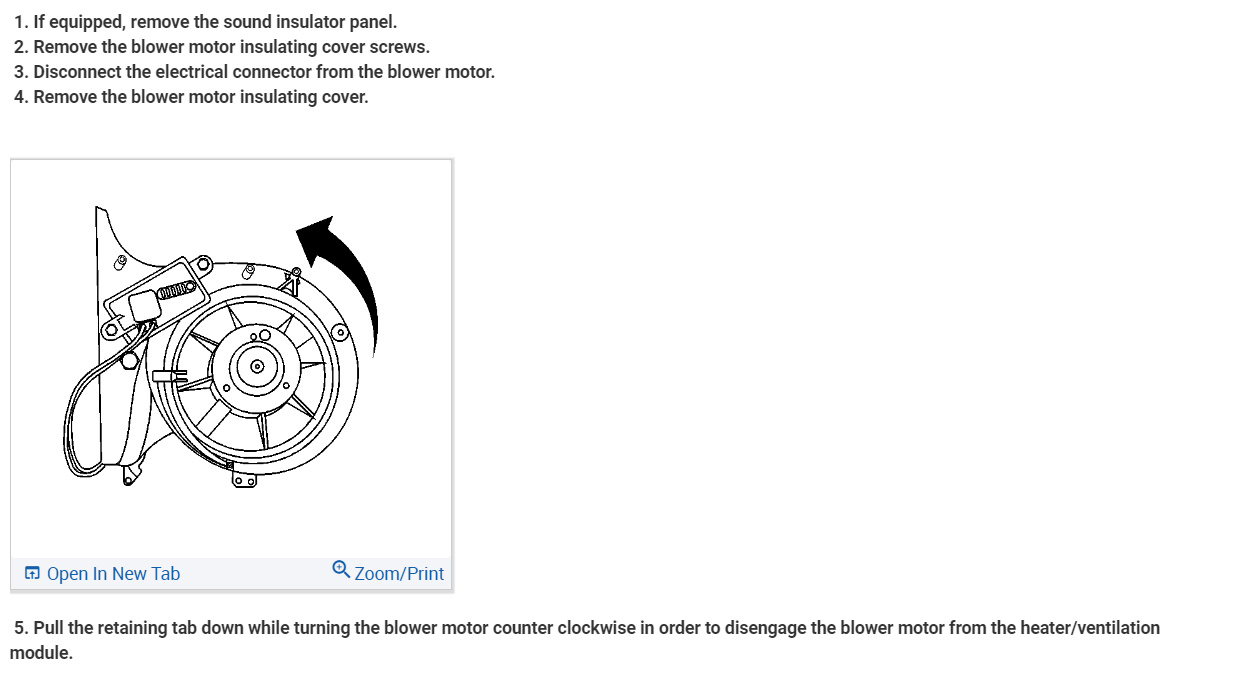

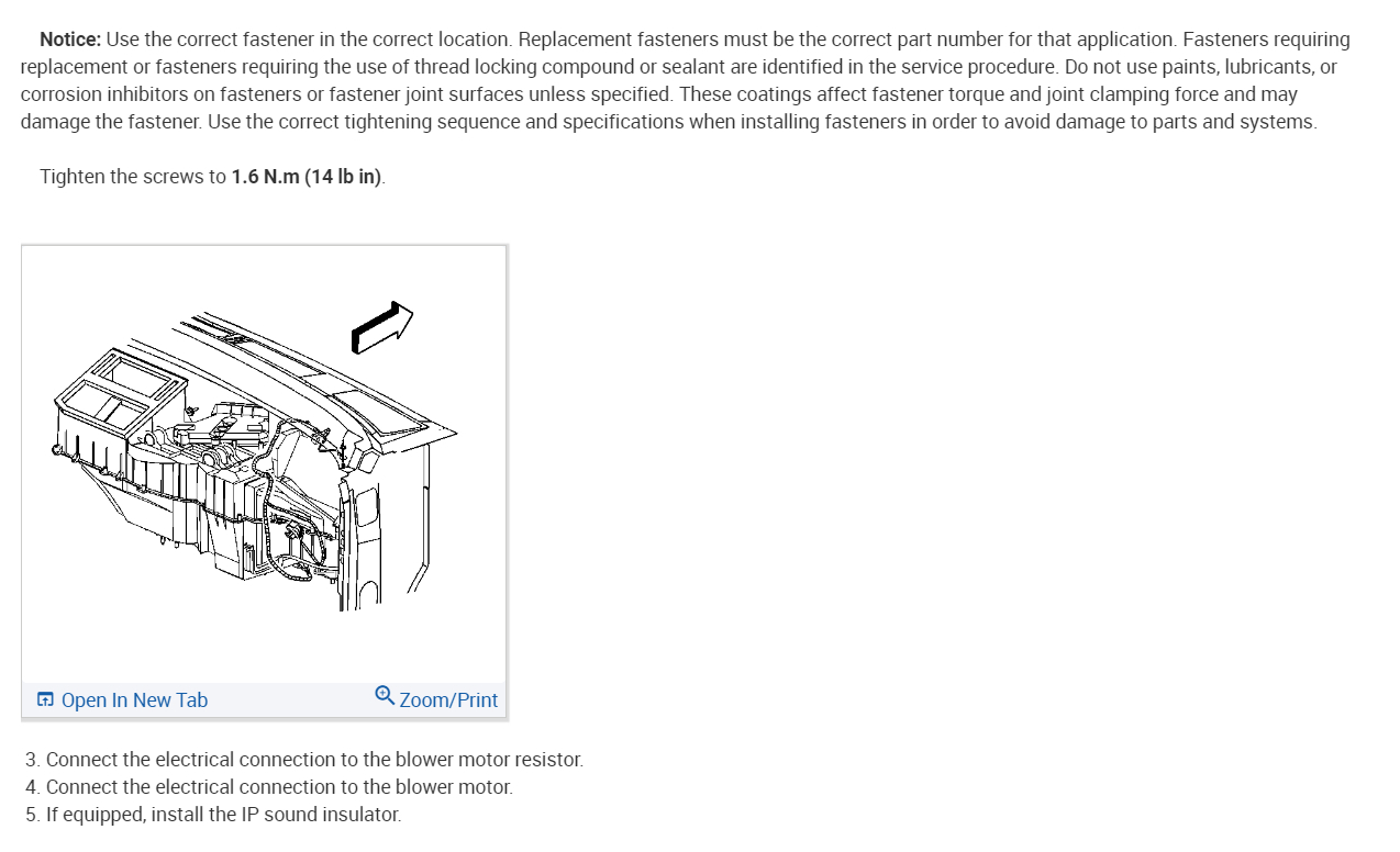

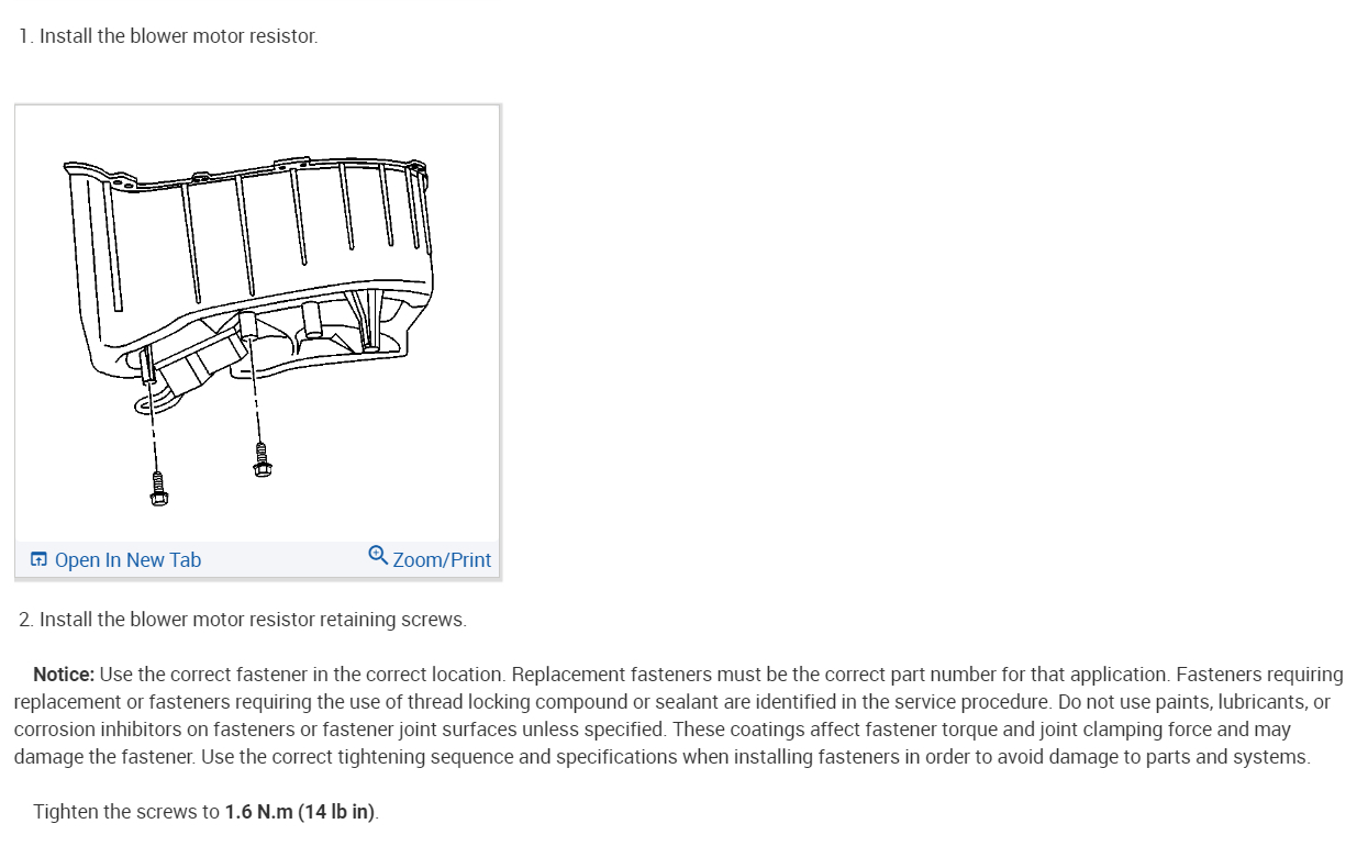

It sounds like you have a defective blower control module (resistor). here is the location and instructions on how to replace it. I would replace the blower motor as well because if it is pulling too many amps, it will cause the module to go out. Check out the images (below). Please let us know what you find.
