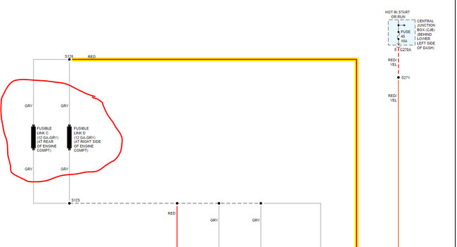

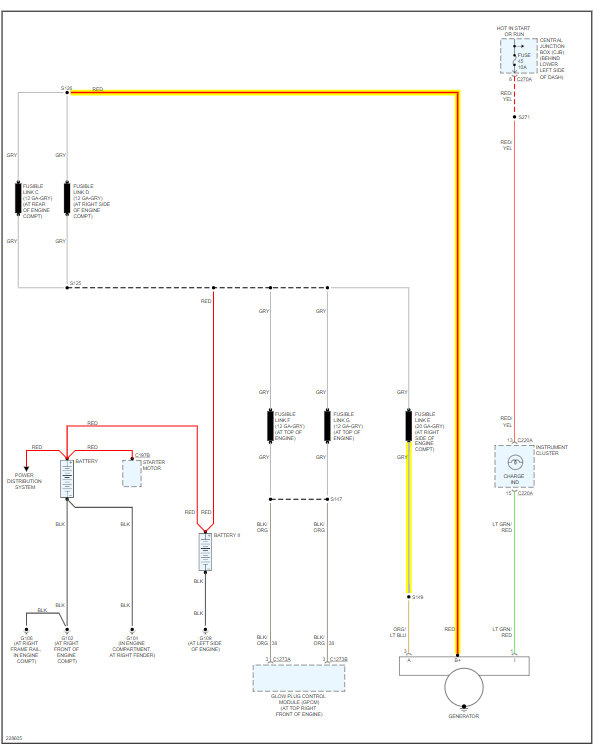

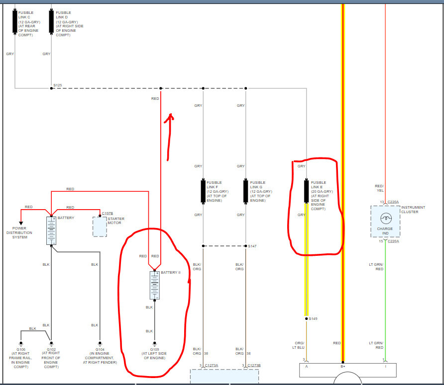

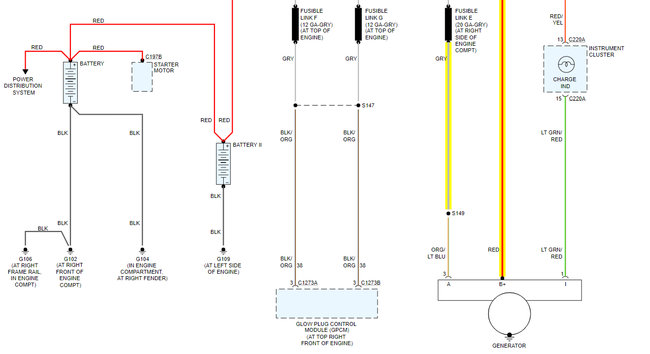

What I found is that I am not exciting the alternator to make it charge. Trying to find the wiring to see were the alternator is getting it power from to make the voltage regulator work.
Jan 10, 2020 at 12:45 PM
  • 110,240 POSTS
I attached 4 pics below. The first three are broken down so you could see the components and wiring better. The last pic is the entire charging system. If you have dual generators, it is different than this, so I have to know. I suspect either you have a blown fusible link or a bad splice. See pics.
Let me know if this helps.
