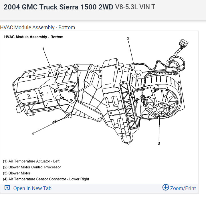

Where is the actuator for the temp blend door for the passenger side located?
Aug 3, 2024 at 3:20 AM
  • 55,616 POSTS
Sure, here is a guide that shows you where each of the blend door actuators are:.
Check out the images below as well. Check out the images (below). Let us know if you need anything else.

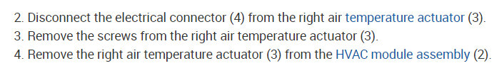

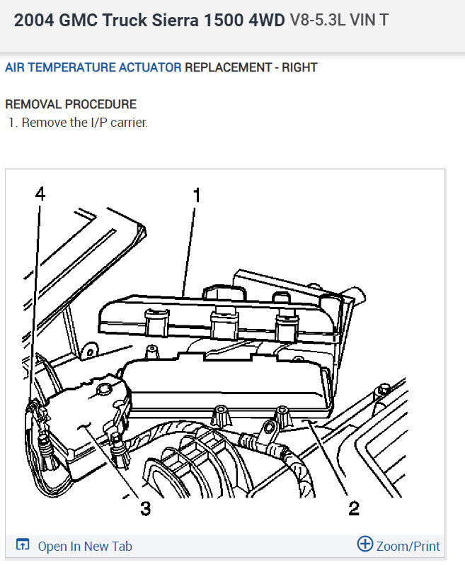

Your video is good for the actuator under the glove box, but I do not see any good diagrams or videos for replacing the actuator that controls the passenger side of the vehicle. Do you have a video for that?
Thanks,
Dean
Aug 6, 2024 at 1:26 AM
  • 55,616 POSTS

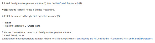

If you scroll down on the guide I sent it shows the right-side actuator but here, is it. Check out the images (below). Let us know if you need anything else.
