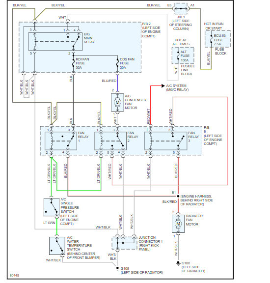

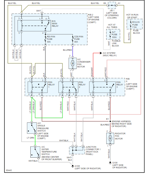

Cooling fans are not working.
Sunday, December 30th, 2018 AT 6:51 AM
MECHANIC
52,797 POSTS
Good morning,
Did you verify power to the fan connector? you can use a test light or voltmeter.
I attached a wire diagram for you to check the fuses listed for power on both sides. I would start there.
