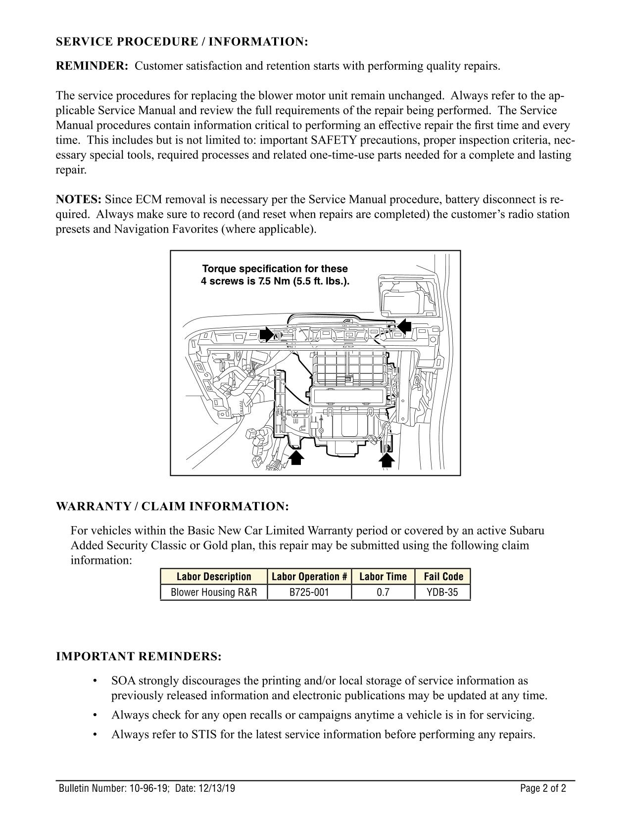

One day while I was driving, I heard the blower fan stop running. I tried the knobs but the fan speed control and the temperature controls have no power. Checked the fuses and they aren’t burnt.
My question is this, Is there another location other than the two fuses blocks? Or could the motor be burnt out?
Thank you for your time.
Feb 14, 2020 at 1:33 PM
JIS001
  • 3,412 POSTS

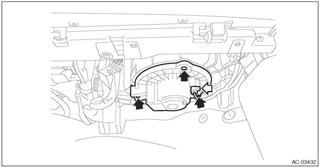

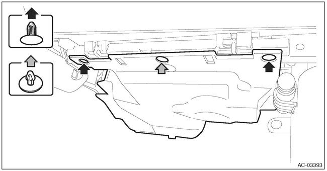

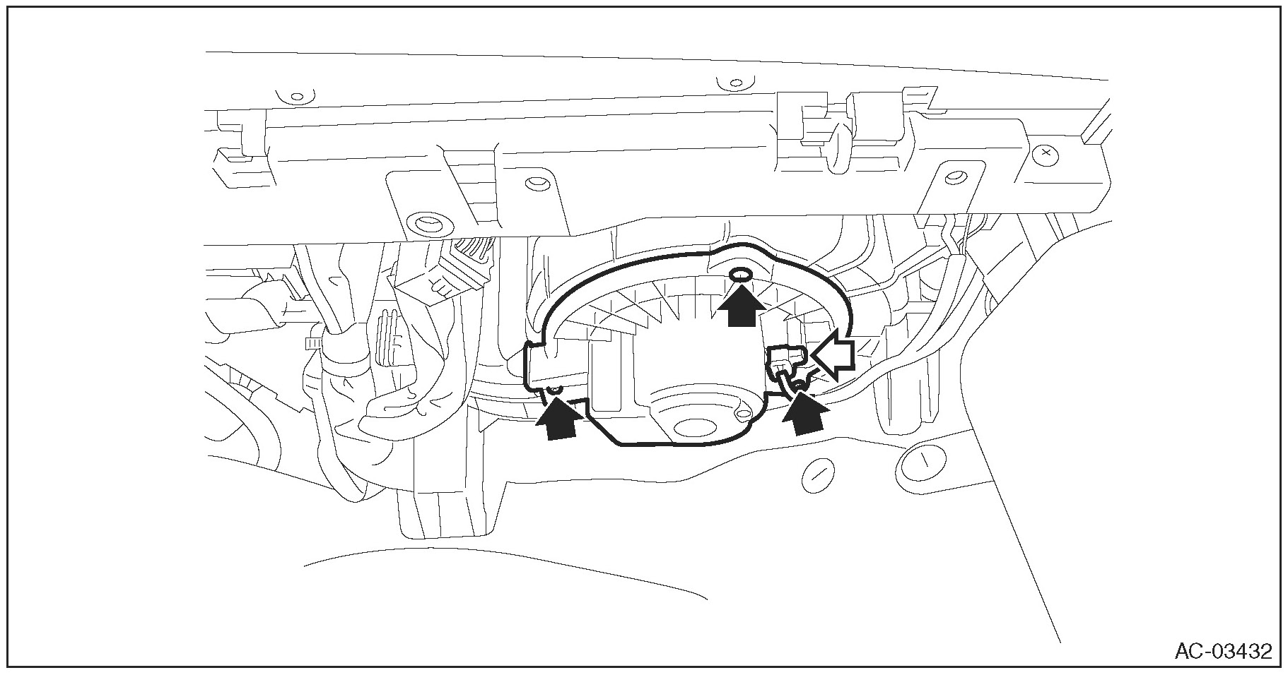

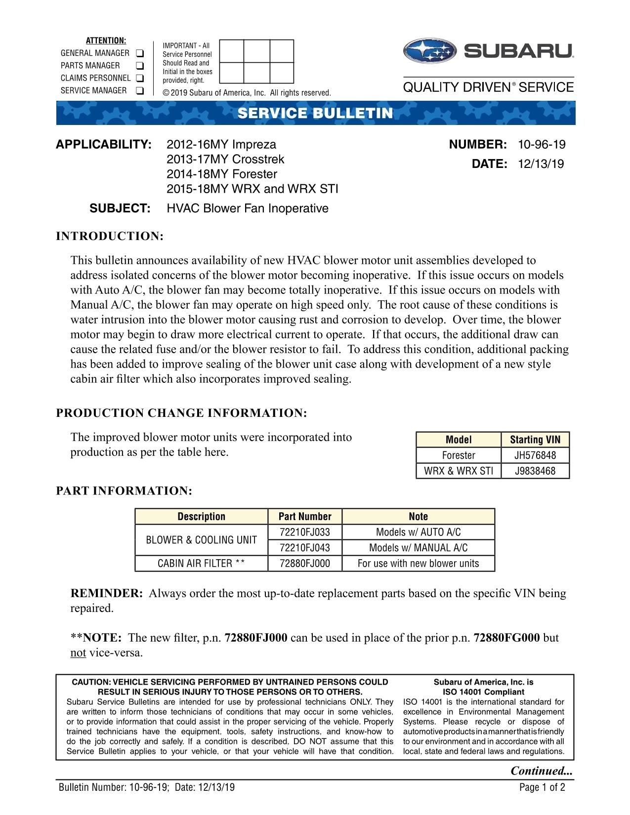

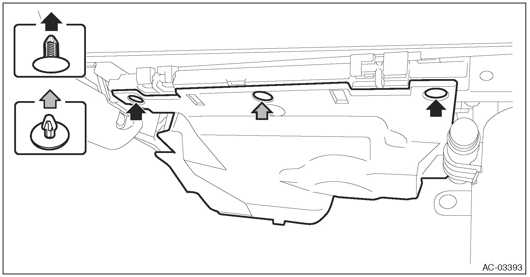

There is a service bulletin for this condition. See images below. There is water intrusion causing corrosion and making the blower motor to work harder until it burns out. There is an updated blower motor with cabin filter you need to replace. The updated parts have better insulation. Here are the instructions with images. Also the bulletin has the updated part numbers.
REMOVAL
 1. Disconnect the ground cable from battery.
 2. Release the clips, and remove the under cover assembly - passenger.
 3. Remove the blower - motor.
    1. Disconnect the connector.
    2. Remove the screws and detach the blower - motor.
INSTALLATION
Install each part in the reverse order of removal.

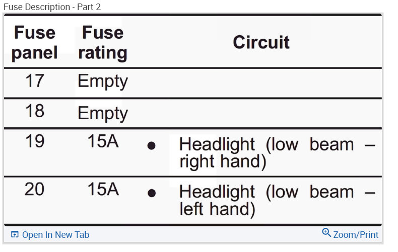

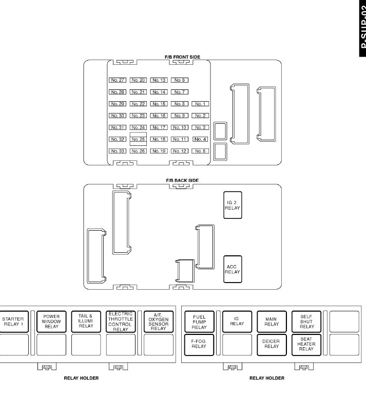

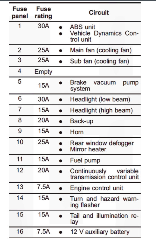

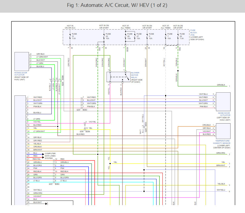

So I changed both the fan and resistor, and I do not have any power at the controls. Could there be a fuse that I am missing?
Feb 16, 2020 at 11:14 PM

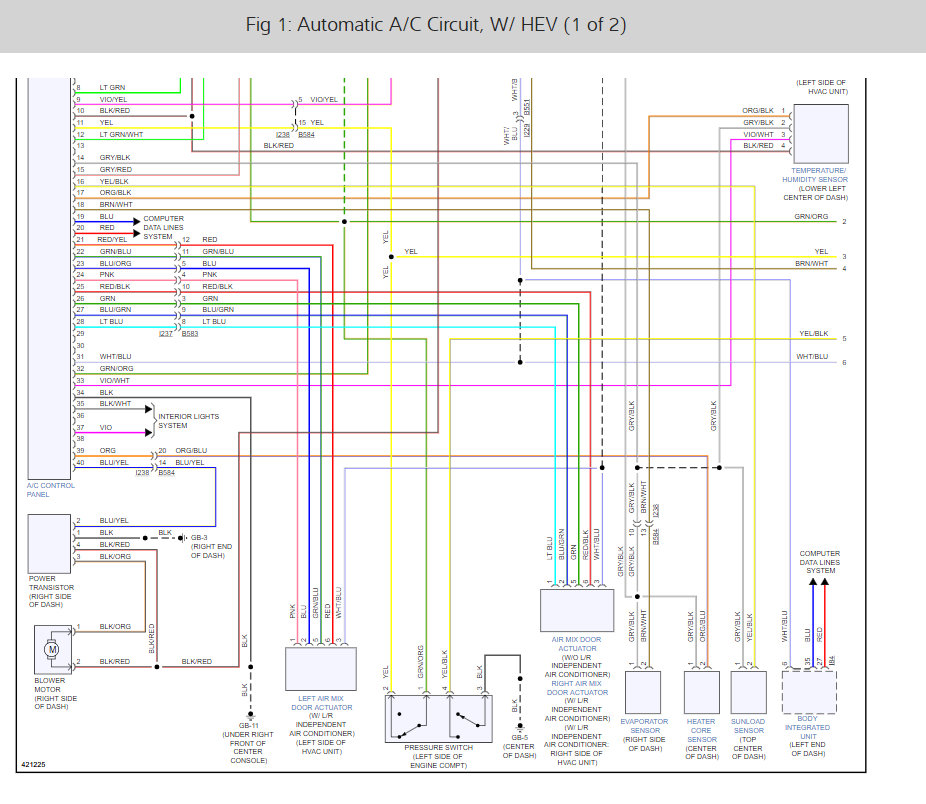

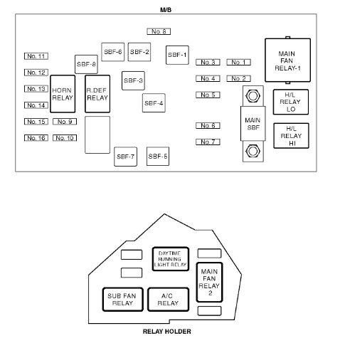

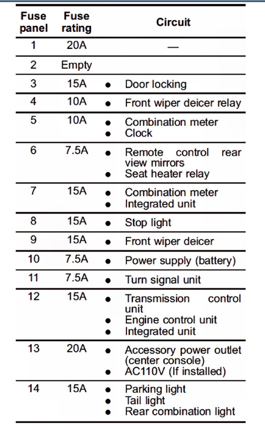

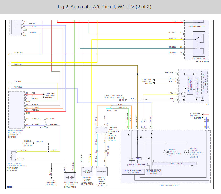

  • 55,433 POSTS

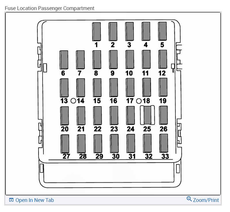

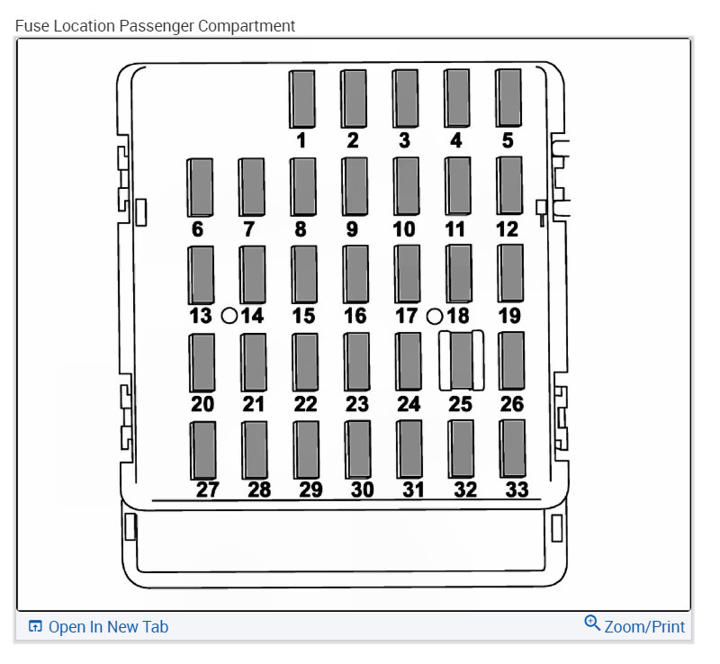

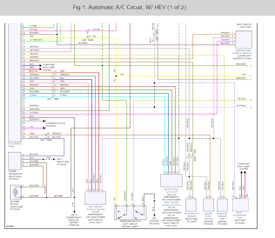

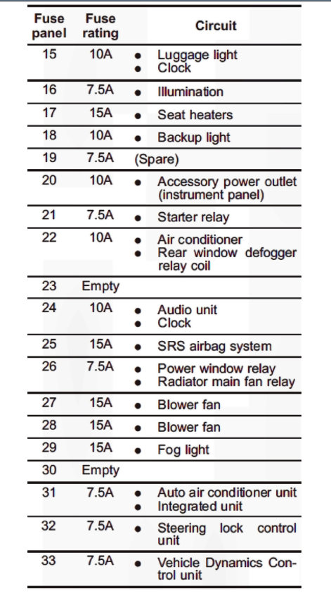

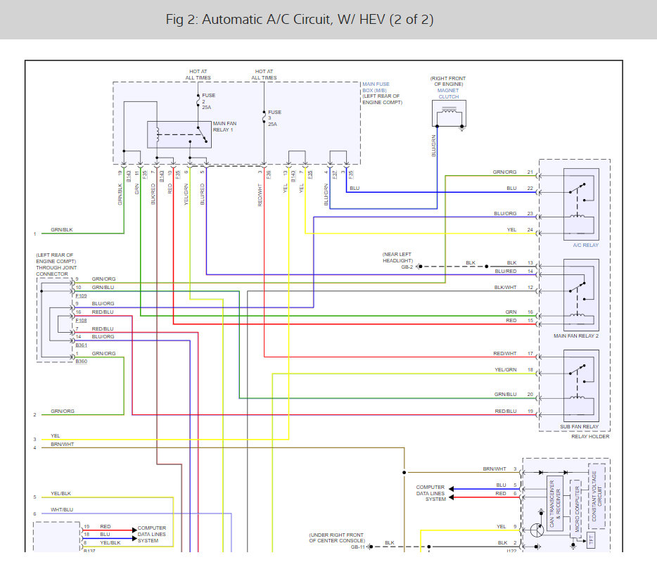

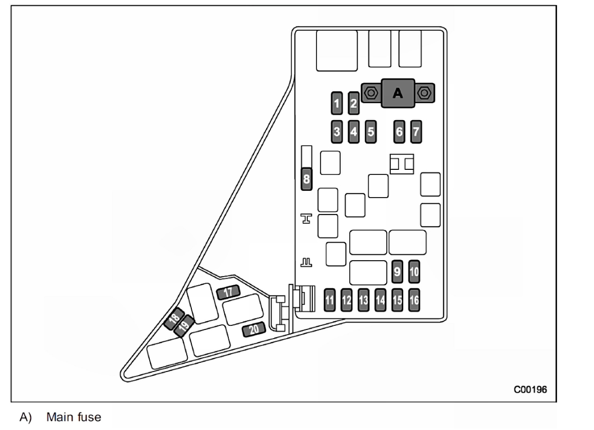

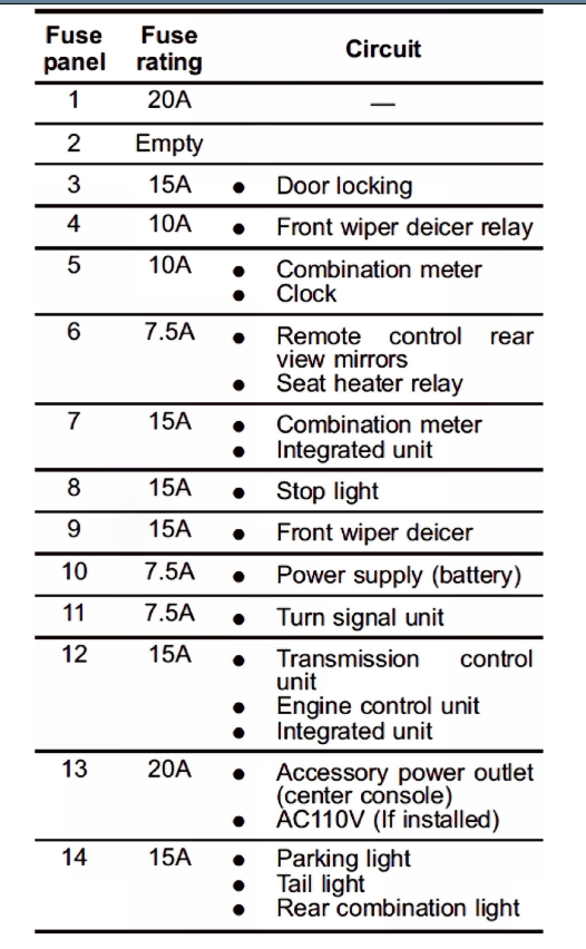

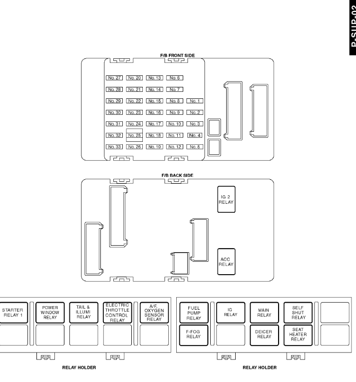

There are 7 fuses that run the system. here is a guide to help you check for power and the fuse location with the HVAC wiring diagrams so you can see how the system works with the fuses that need to be checked:
