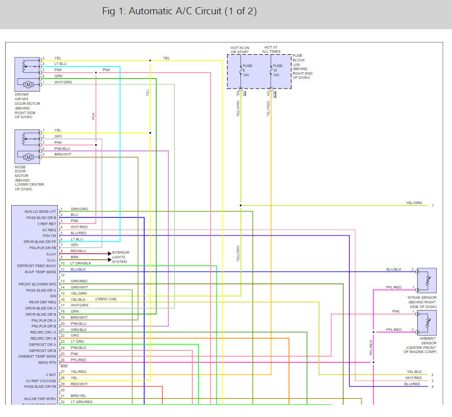

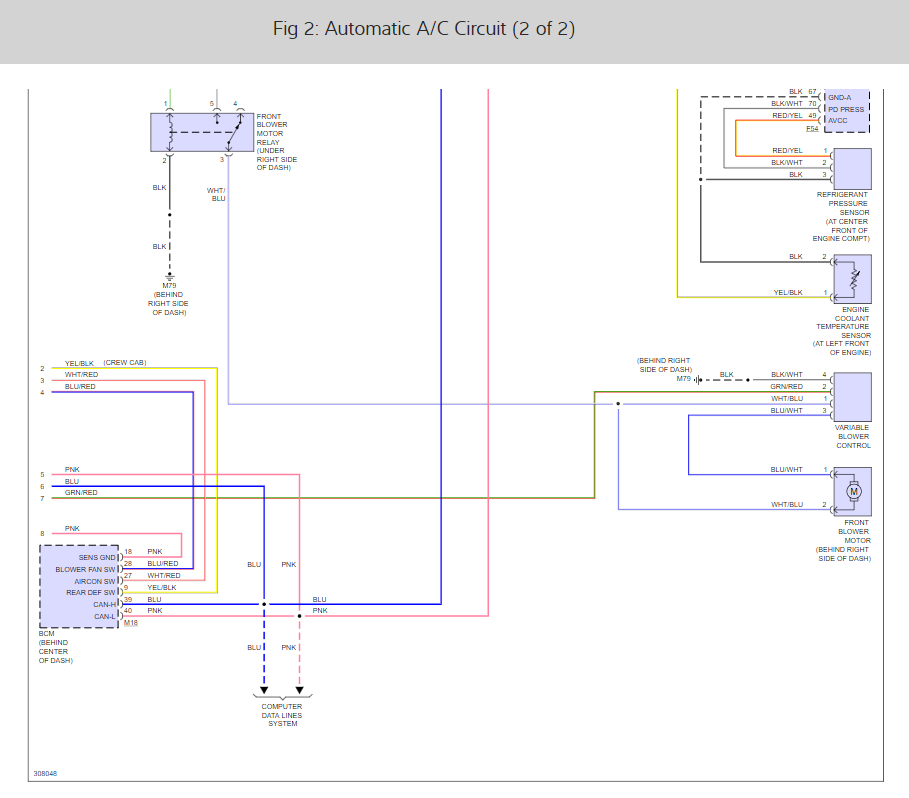

The A/C will not turn off. When you turn it off it blows down on your feet.
Sep 8, 2018 at 10:58 AM
  • 55,711 POSTS

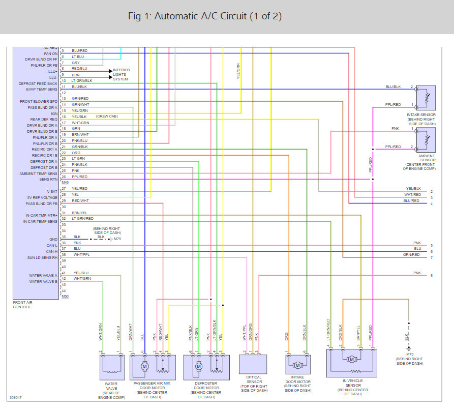

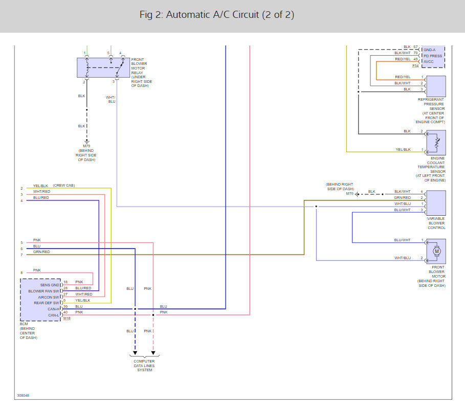

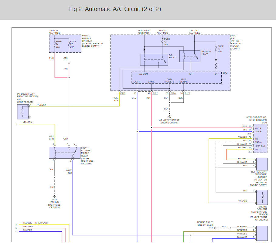

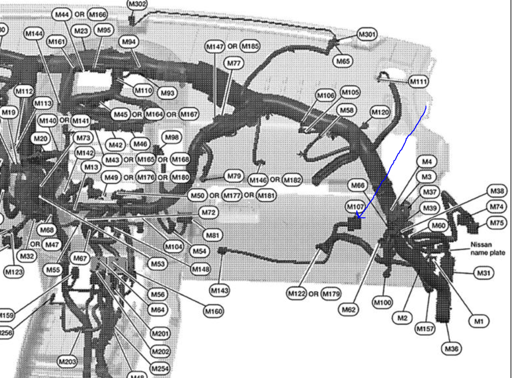

It sounds like you have a blower motor relay that is stuck on which happens. Here is a guide to help you confirm the issue with the replace location and the blower motor wiring diagrams so you can see how the system works:
Front Blower Motor Relay (M107).
Check out the diagrams (below). Please let us know what you find.
