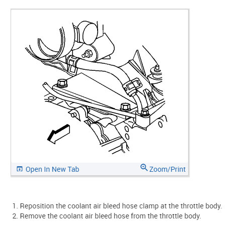

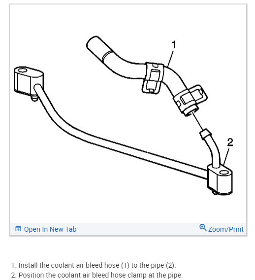

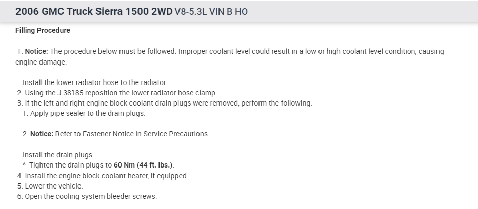

The truck listed above is a 1500 model. I am having an overheating problem with my truck. I don't know at what temperature the first fan comes on. I warmed up the truck to operating temperature, but no fan came on. I tested the fans to make sure they work by connecting them to the battery. They work fine. I put the air on and both fans worked. I replaced the cooling temperature sensor, but no fans came on after that. At what temperature does the fan come on? Also, how do i bleed the cooling system? I was told that could be the problem. Please help! there are no leaks in the system.

The radiator cooling fans won't turn on until the system reaches approximately 230F. As far as bleeding the system, certainly, if there is air in the system it can cause a blockage and cause overheating.

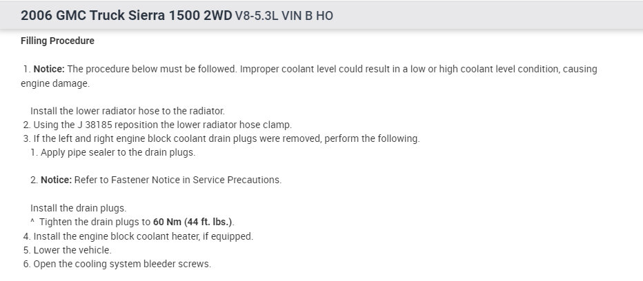

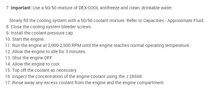

I attached the directions for bleeding the system. There is a bleed hose/pipe attached to the throttle body. That should be opened when filling the system. See pics below
Also, make sure not to mix the factory DexCool coolant with a traditional coolant.

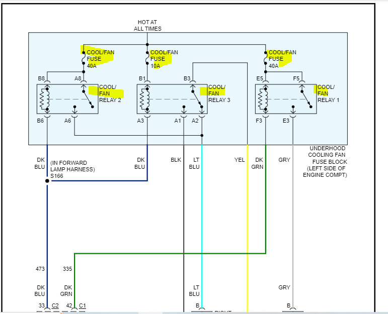

The coolant thermostat fully opens at 195F. Normally, you can expect the temperature to average around 205F. As far as the fans are concerned, they aren't programmed to turn on until close to 225F.
If you look below, I attached the wiring schematic for the circuit. The fuses are highlighted as well as the relays.
Fuse Block - Under hood - Cooling Fan (10 Series see pic 3)
Let me know if that helps.

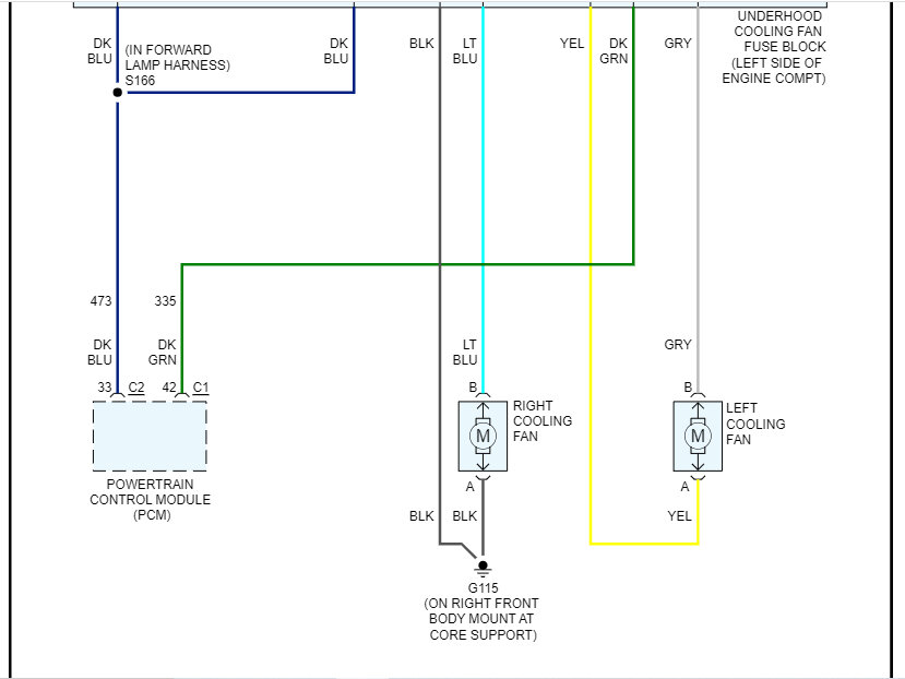

Thank you very much for the info. What side is fan 1 located, if you're in front looking at the truck? is the fan 1 located on driver side? in wiring diagram it shows gray wire going to pin b of fan 1 is it the driver side? how do i know that the wire is pin b of fan don't see anything showing that.
on my truck I have on the driver side fan wires lt blue and black is this correct? I look and it can't reach if i change them around.

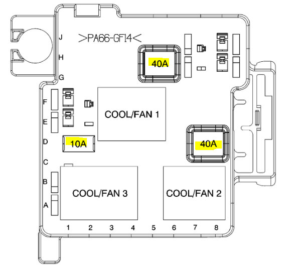

also how do i test for power at the fan fuse box, if i remove the relay what pin should have power. how can i test only fan 1 by removing relay and jumping wire to see if it turns on.

When they indicate left or right, it is based on a person sitting in the driver's side. So, left is the driver's side and the right is the passenger side.
As far as checking for power, if you remove one relay at a time, two of the 4 pins will have power regardless of the key position and the engine temp.
Relay 1 = left fan
Relay 2 = right fan
Relay 3 = both
Use a test light to see if there is power at two of the relay pins. If there is, we know the fuses are good.
