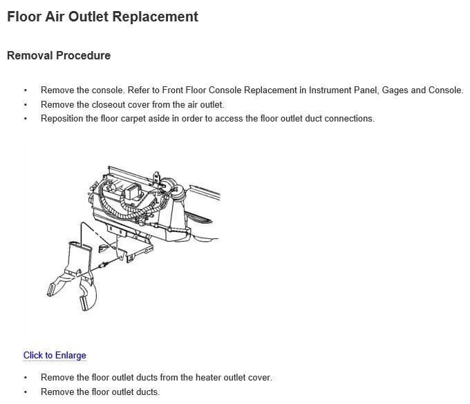

I just bought this car. When I turn the AC or heat on, the smell of garbage, or dead animal rushes through the car. I got an oil change/courtesy inspection and they did not see a rodent anywhere they looked. I sprayed Lysol into the air intake and it helps a bit but I still smell it. Winter is around the corner and I would like to use my heat without the car smelling like it is a garbage truck. Please help. Thanks!

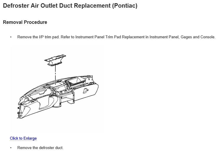

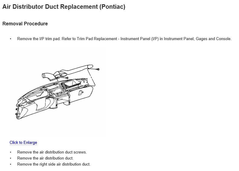

Well then, you might have had a rodent crawl into or chew through the duct work under the dash and die. How they got into the vehicle is another mystery but I suspect you should start dismantling the entire climate control duct work in search of whatever is causing the smell.
I do not have instructions for the ducts but most likely everything will be easier to get to with the instrument panel removed.

I did just find this for removing the air duct.
The floor air duct too.
And defrost duct.
