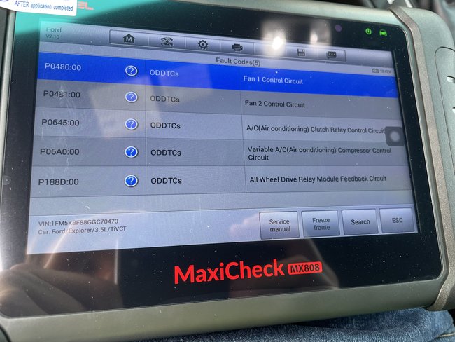

Here are all of my codes. I believe they may all be related. My A/C recently started not working. Fuse #3 (10a) keeps blowing. The fuse if for “A/C clutch control relay coil. VACC. Active grille shutters”. I unplugged the compressor, compressor clutch and the grille shutters and the fuse is still blowing, even if the A/C is turned off. I put 12v to the clutch and it engages, so that is not bad. I am suspecting a short somewhere but have no clue where to start. I’m thinking this short may also be causing the 4wd issue. Please let me know if you have any thoughts or suggestions. Thanks,
Nick
May 17, 2021 at 12:30 PM

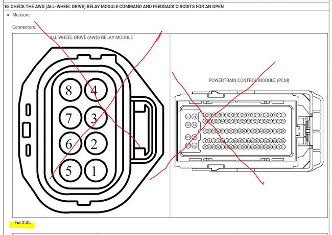

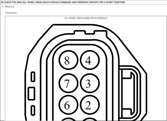

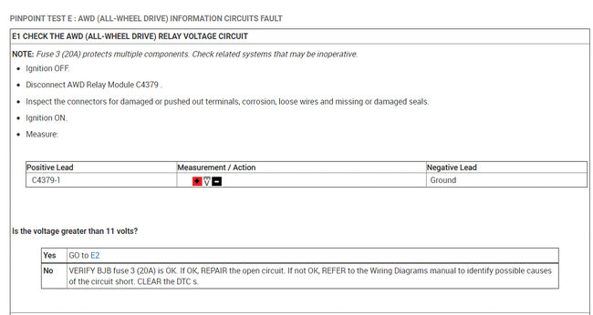

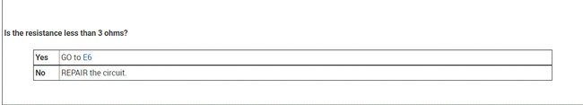

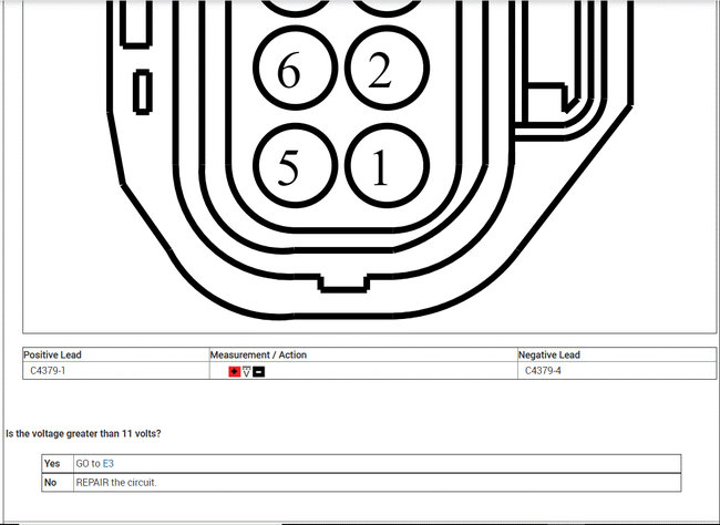

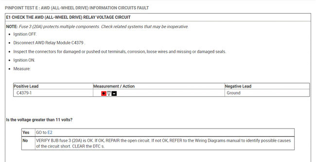

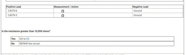

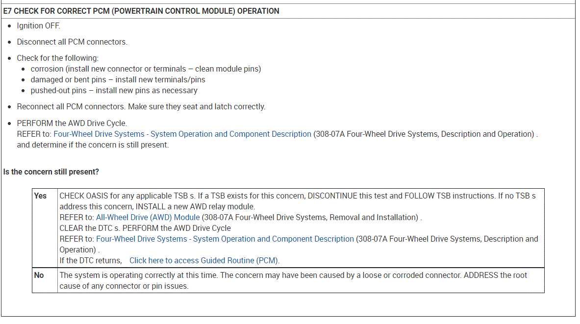

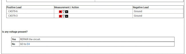

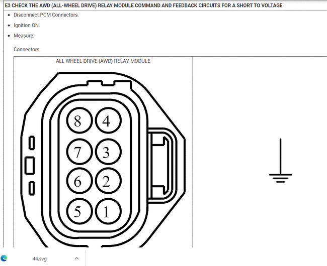

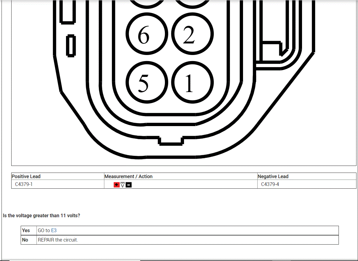

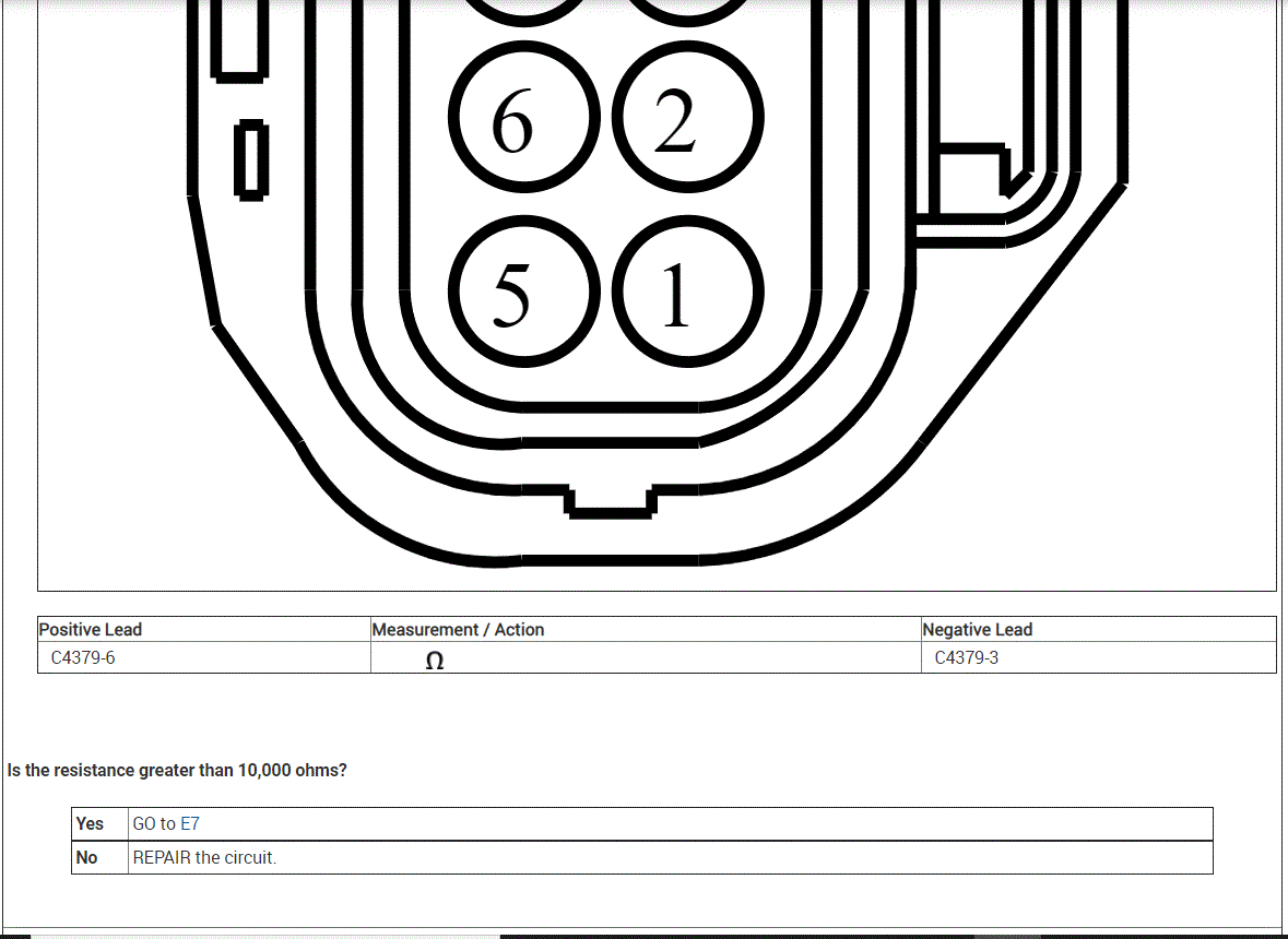

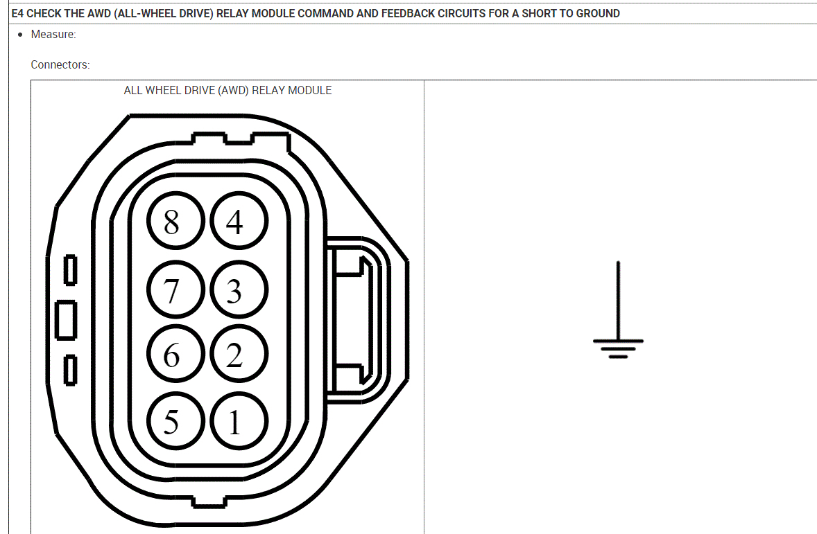

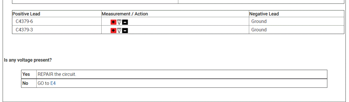

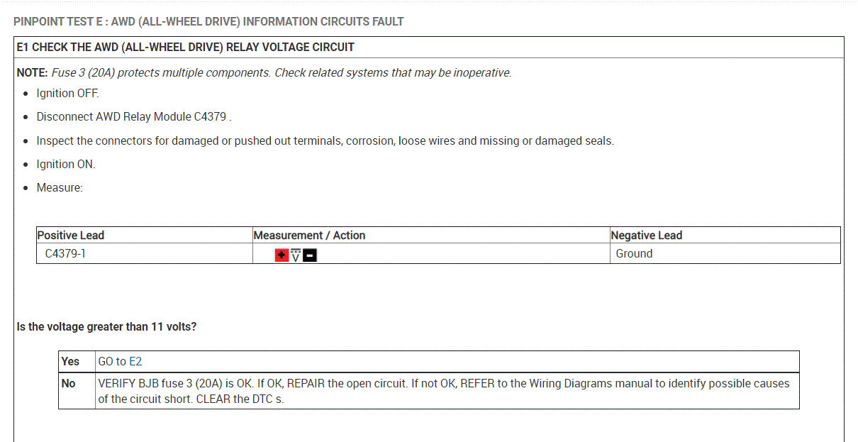

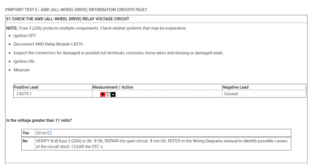

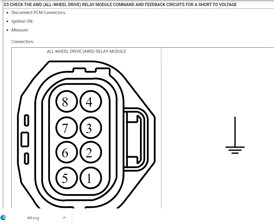

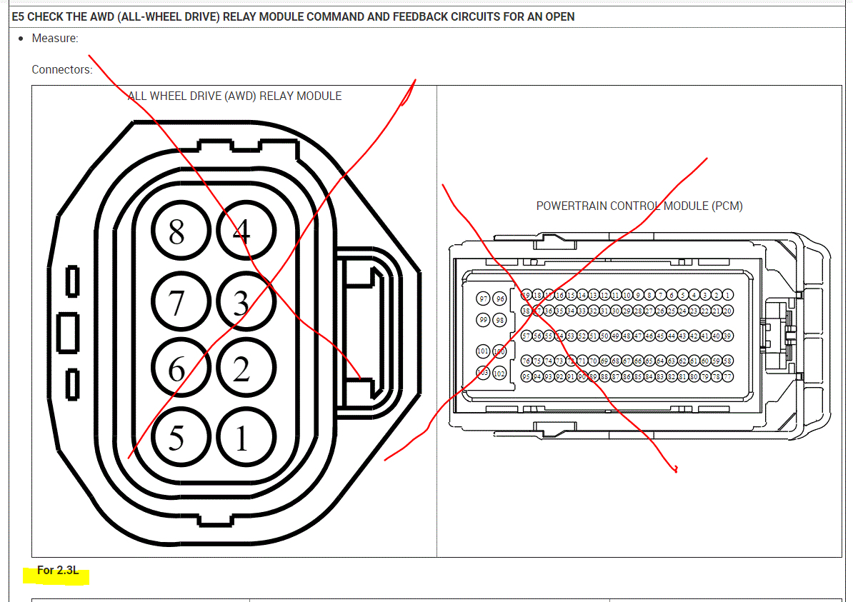

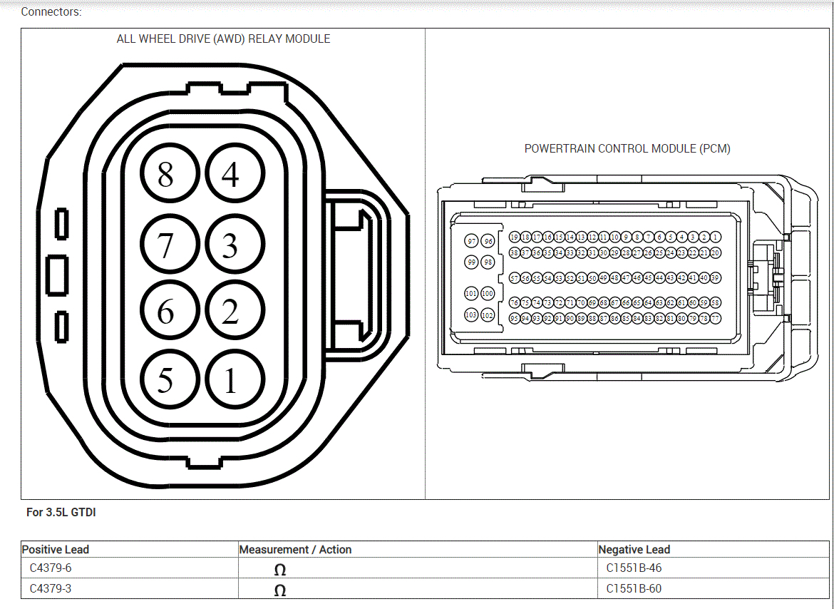

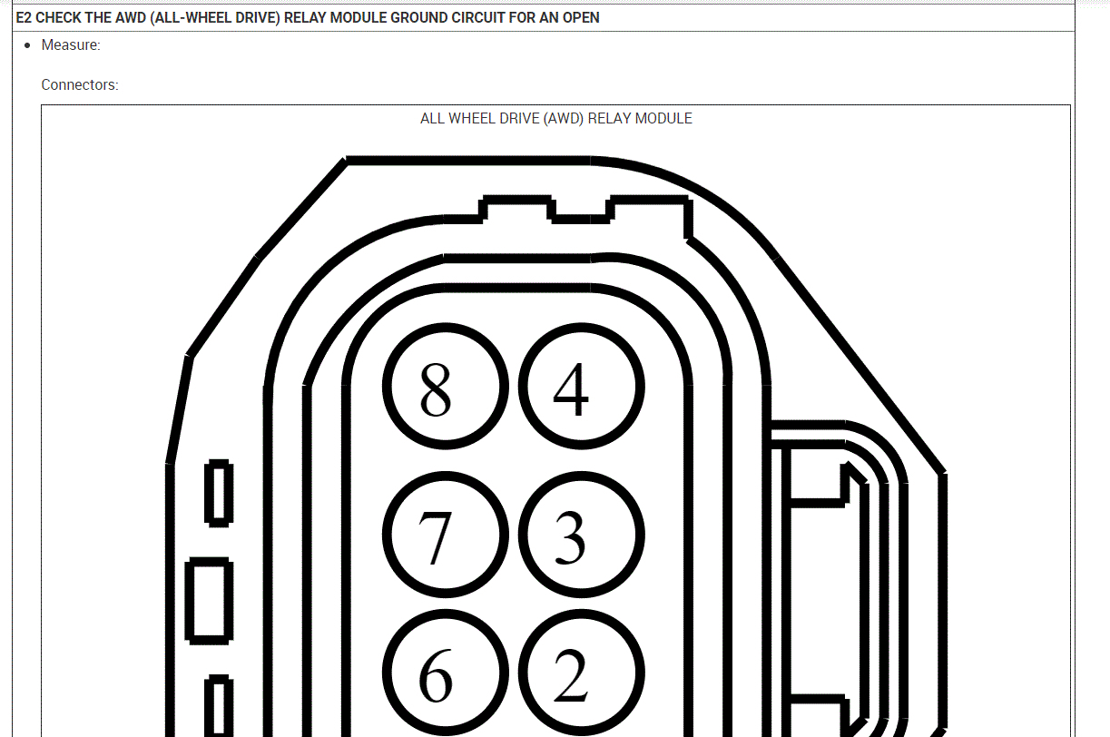

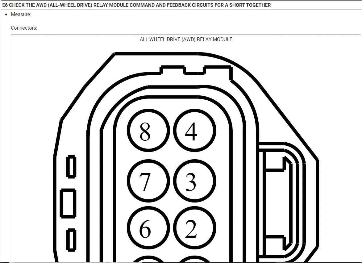

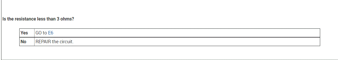

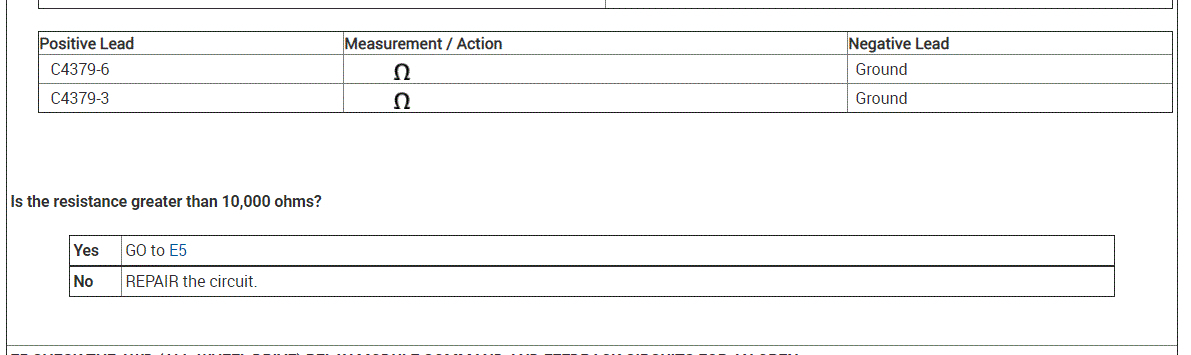

As far as the AWD, the problem is in the module feedback. This will require diagnostics to determine the cause. I attached the diagnostics below. Take a look through them and let me know if you are comfortable doing them. Here is a link you may find helpful:
As far as the A/C, you must have a short at some point. I need you to start a new thread specific to that problem. We are trying to keep the threads specific to one topic so they are more helpful to others. I hope you understand. Simply copy and paste your A/C question to the following link. I hope you understand.
See pics below for diagnostics.

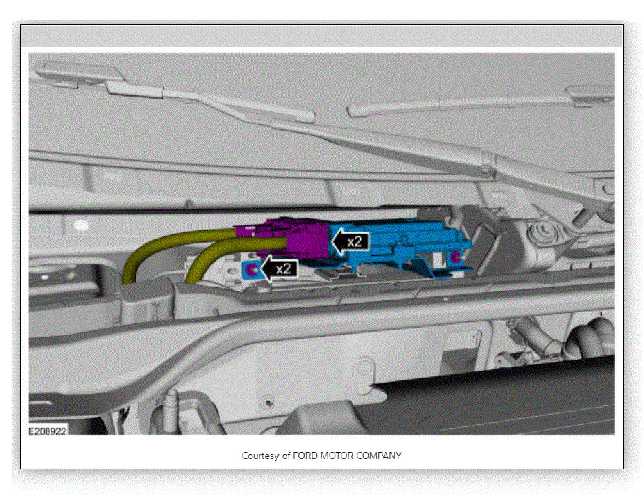

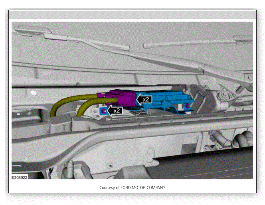

Yeah, I understand. Where is the PCM/ECU/ECM located on my Explorer? They must have hidden this one good. I can’t seem to find it anywhere.
May 18, 2021 at 10:58 AM
  • 110,240 POSTS
They did hide it. LOL You have to remove the cowl at the base of the windshield to access it. If you look at the attached pic below, it shows its location.
Let me know if I can help or if you have other questions.
