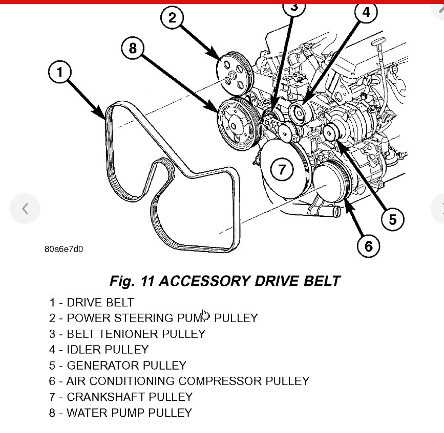

We changed the water pump and now we are trying to put the belt back on. can you give me a blown up diagram of the pulley?
Oct 1, 2019 at 9:02 AM
Experienced Mechanic
18,907 POSTS
Here is a picture of the front of the engine that shows the belt route. Let me know if you need more information. Thanks

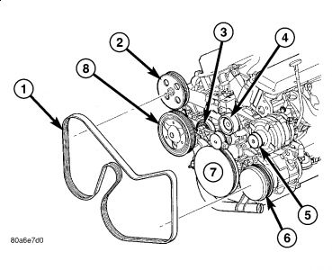

I had to replace my water pump but can not get my belt on.
Could you help?
Oct 3, 2019 at 4:29 AM (Merged)
DOCFIXIT
18,828 POSTS

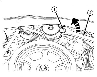

Is this a diagram of your belt routing?
if yes then are you taking tension off tensioner?
