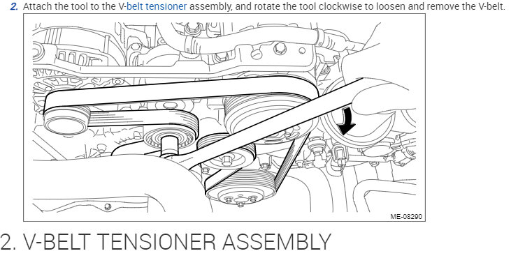

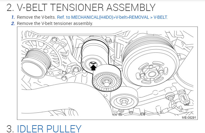

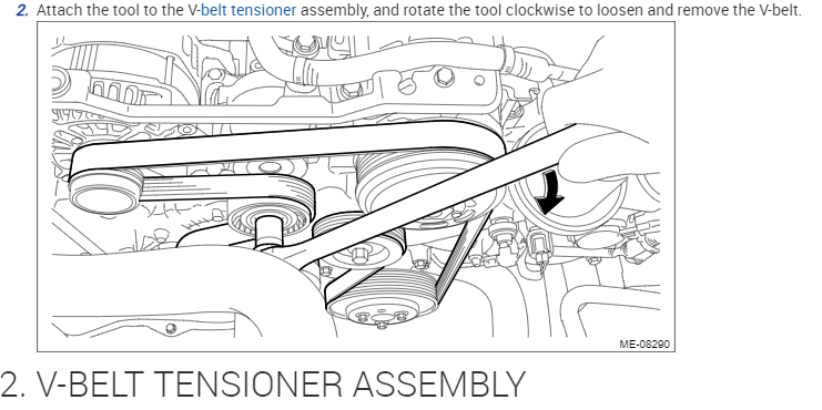

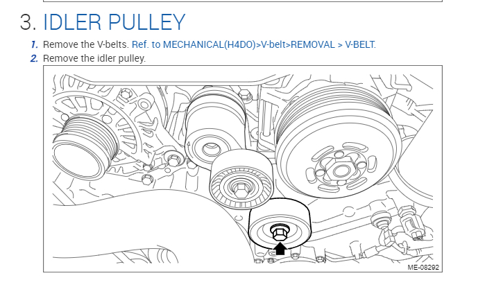

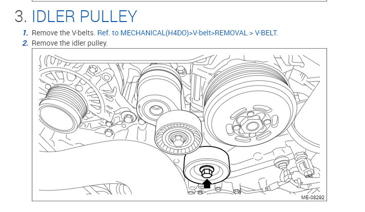

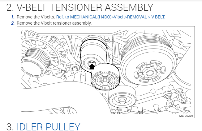

I need the replacement procedure for the tensioner assembly.
Jan 19, 2023 at 6:52 AM
  • 110,248 POSTS
To get you started, here is a link that explains in general how one is replaced. You may find it helpful when working with the manual's directions.
https://www.2carpros.com/articles/serpentine-belt-tensioner-replacement
If you look below, I attached the directions for the removal and replacement of the serpentine belt, the tensioner, and the idler pulley. I added the idler pulley in the event you find play or resistance in it when the belt is removed.
Let me know if this helps.
