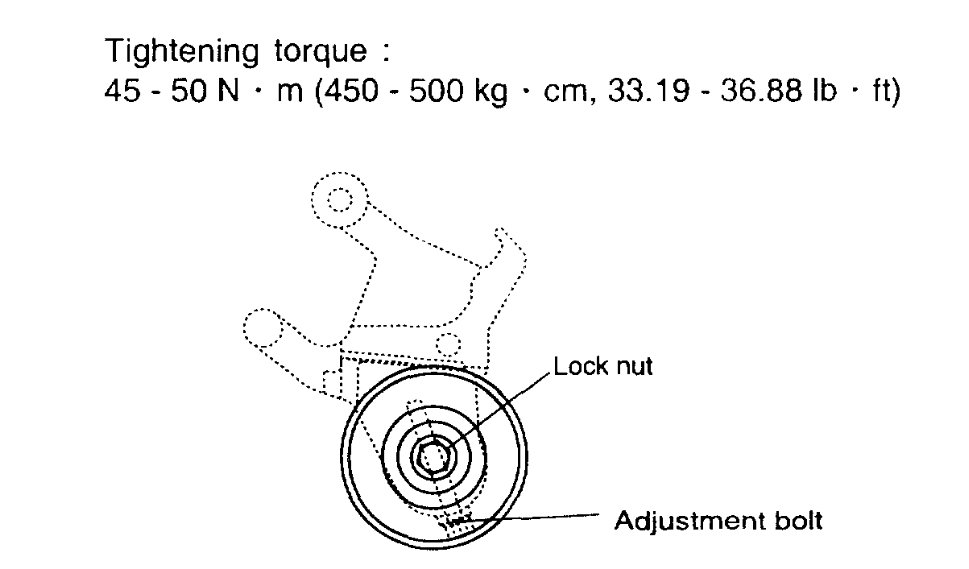

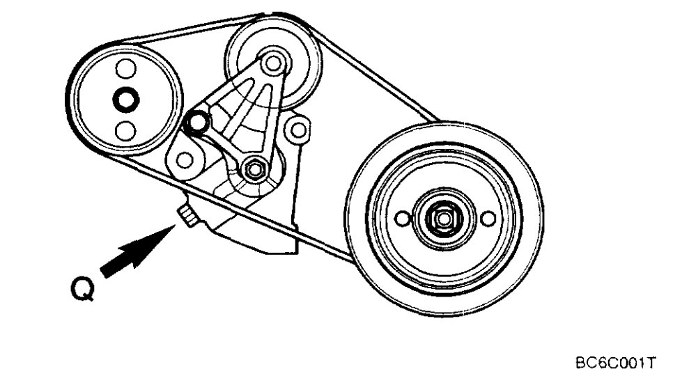

Good morning,
I attached two pictures. Could you tell me which one you have?
Also, since you installed the wrong nuts on the stud, it sounds like you will be replacing the tensioner assembly.

Hello, Roy. Thank you for your reply.
I have the second type. I may not need to replace though, as I didn't force them or cross thread. When it didn't feel right, I stopped. So, I am praying here!
