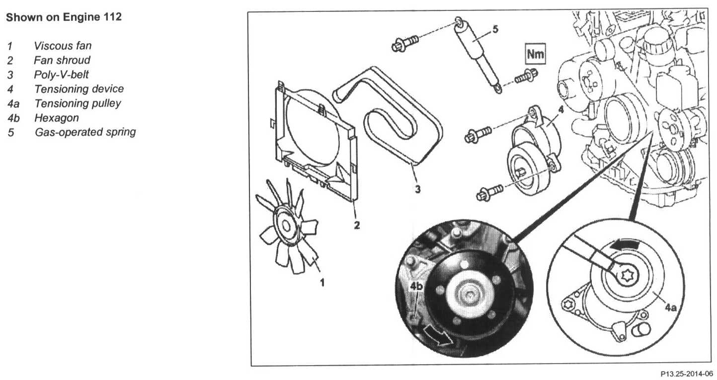

Can I unscrew the screw that fastens the pulley, or I need to replace the tensioner? If unscrewing is possible, is it clockwise or counter clockwise direction? Thanks.

Honestly, the tensioner needs replaced if it has failed. I believe the bolt you are referring to is just the pulley bolt.
Here are the directions for replacing the tensioner. The attached picture correlates with the directions.
___________________________
AR13.25-P-3200B REMOVE/INSTALL POLY V-BELT TENSIONING DEVICE
Remove/Install Poly-V-belt Tensioning Device
Shown On Engine 112
Picture 1
1 Remove viscous fan (1)
2 Remove fan shroud (2).
NOTE: On Model 163 unscrew the screws at the bottom of the fan shroud.
3 Remove poly-V-belt (3)
4.1Rotate the tensioning pulley (4a) in the anti clockwise direction and lock
NOTE: Lock tensioning pulley with drift or pin (diameter 5 mm).
4.2Rotate the tensioning device at the hexagon (4b) in the anti-clockwise direction and lock
NOTE: Lock tensioning device with a drift or pin (diameter 5 mm).
5 Unscrew the gas-operated spring (5) from the coolant pump
Shock absorber of belt tensioning device at the coolant pump housing - 35 N.m
6 Remove tensioning device (4)
Self-tapping screw of belt tensioner at the timing case cover
- Thread not pre-tapped - 35 N.m
- Thread pre-tapped - 25 N.m
7 Unscrew gas-operated spring (5) from the tensioning device (4)
Shock absorber of belt tensioning device - 25 N.m
8 Install in the reverse order

Thanks Joe for the detailed instructions. They are very helpful. I am curious what could cause the pulley to be locked. Is that a common failure? Thanks again.

The bearing inside which the pulley turns on is most likely bad. Honestly, like any bearing, they have a certain lifespan. With that, I have to say it is common and nothing out of the ordinary.

Thanks for the explanation. Because this happened within a few days after the alignment work of my car and I never heard any abnormal noise from the belt before, I was trying to blame it to be caused by the alignment work. I guess it might be just a coincidence in time.
Yes, I was able to replace the tensioner with a new one. The driving belt works fine now. Thanks for the instructions. Because I don’t have the tools to remove the fan, I skipped the fan removing step. The space is really tight, but I managed to get the job done.

Not a problem, Tom. I'm glad you got it replaced. As far as an alignment, in all honesty, I don't see any correlation. They just go bad.
