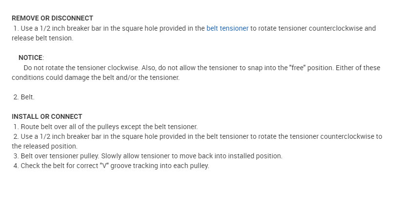

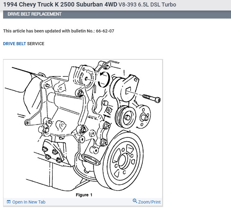

cannot get movement in tensioner to install drive belt, does not seem to follow the common description of a 3/8-inch socket adjustment as is the common answer.
Oct 22, 2021 at 4:00 AM
SQM
  • 6,383 POSTS

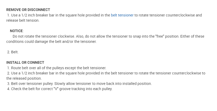

There should be a square hole that you will have to use a 1/2-inch breaker bar and rotate counterclockwise to release the tension on the belt.
Let me know how it turn out.
