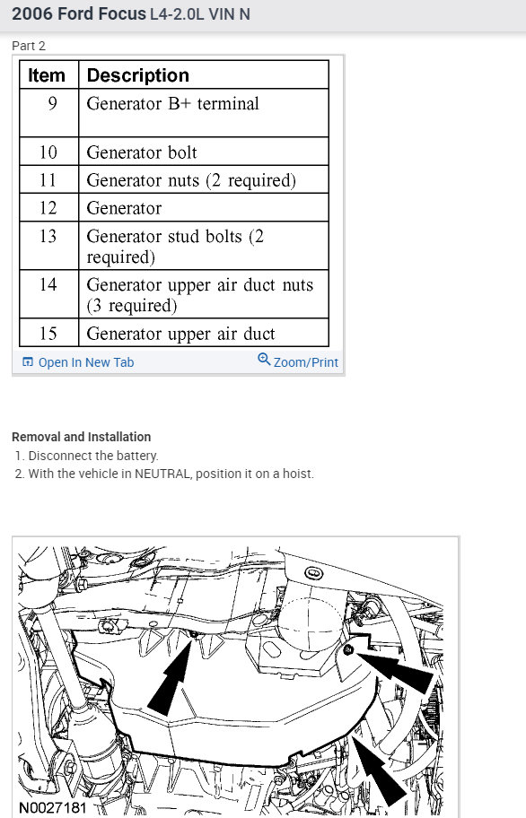

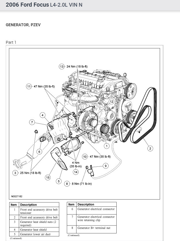

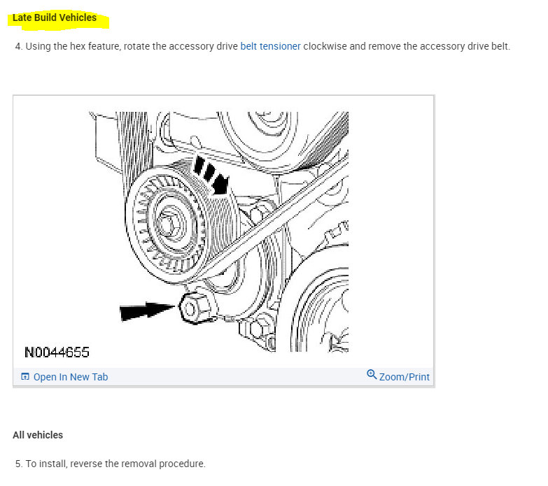

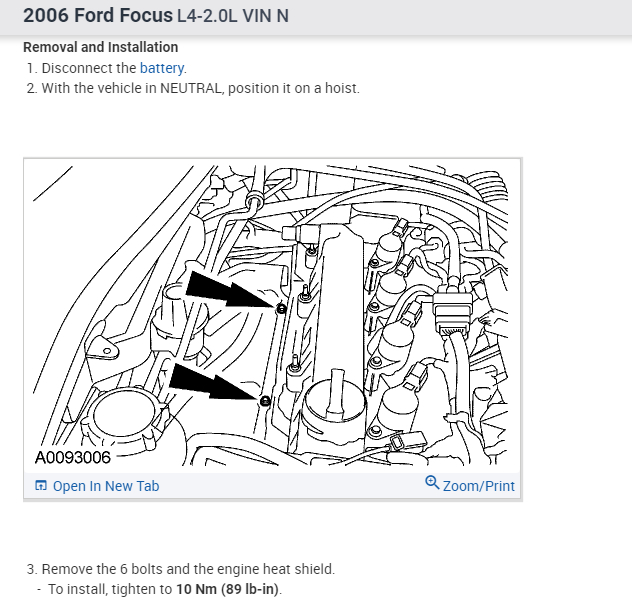

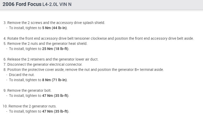

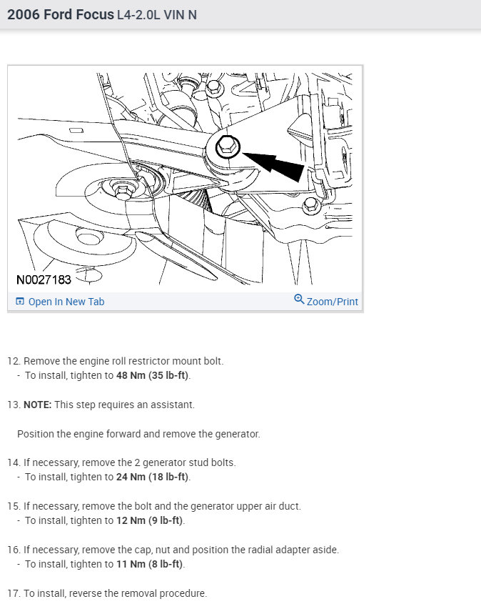

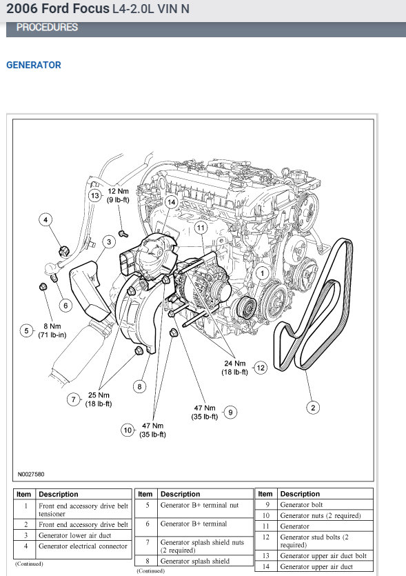

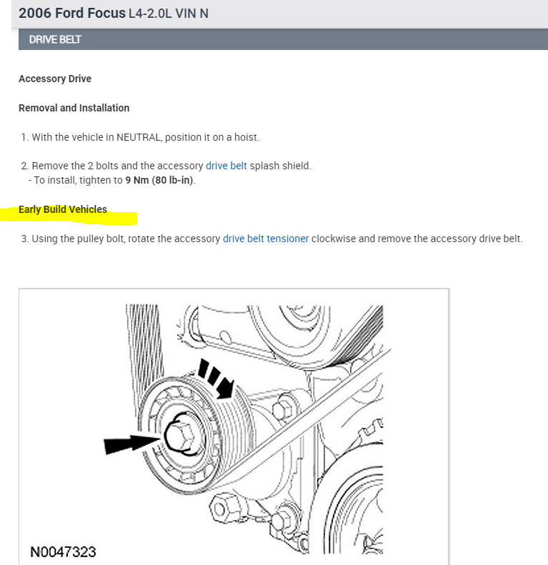

What size breaker bar drive do I need to buy to loosen the tensioner so I can replace my alternator??
Jun 20, 2022 at 9:58 AM
SQM
Experienced Mechanic
6,383 POSTS

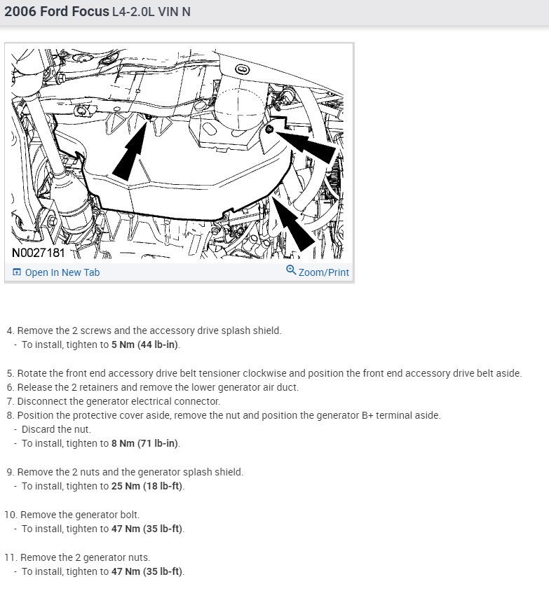

That should be 13MM socket to fit on the bolt.
Here is one of our helpful videos:
https://youtu.be/AaSBaKQaYZs

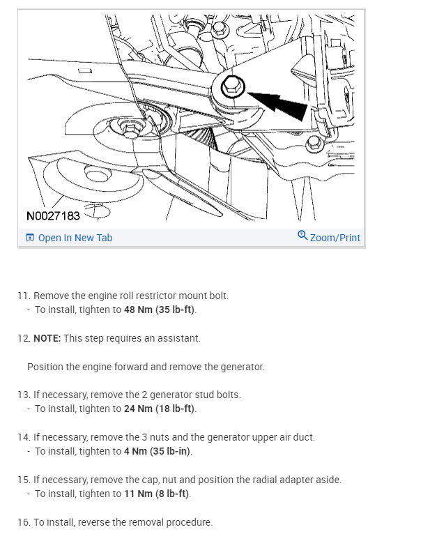

I have attached the replacement procedure for the alternator and belt below for your reference.
Let me know of any questions.
