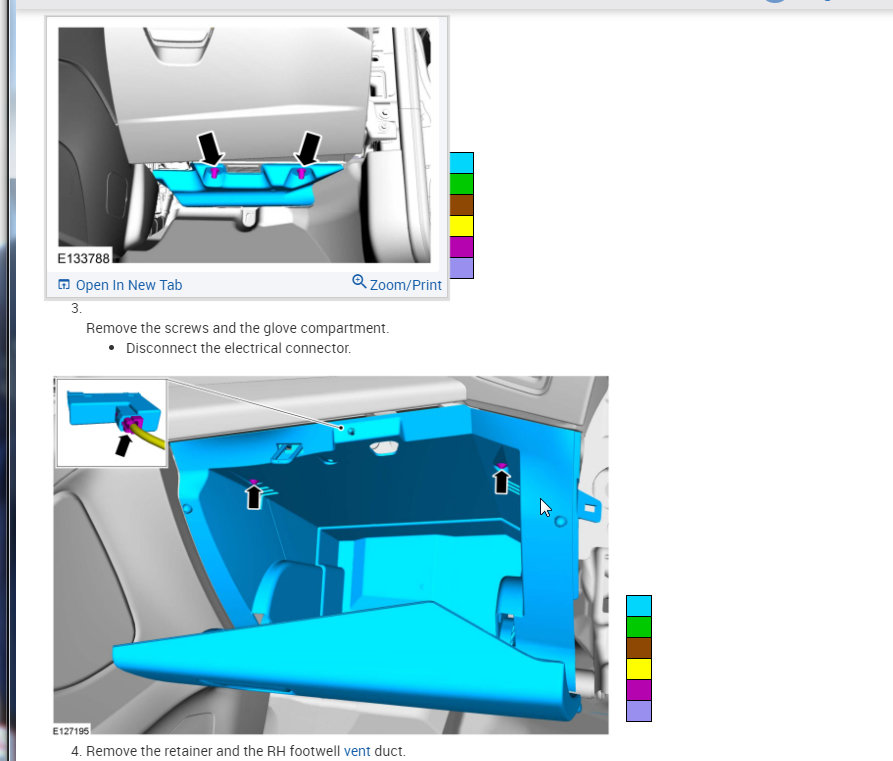

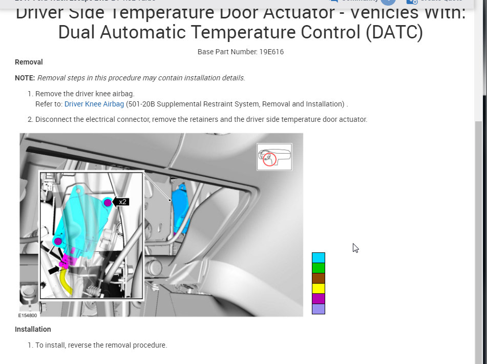

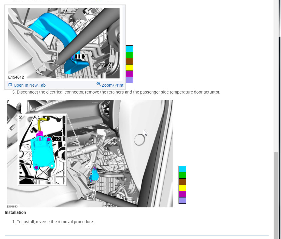

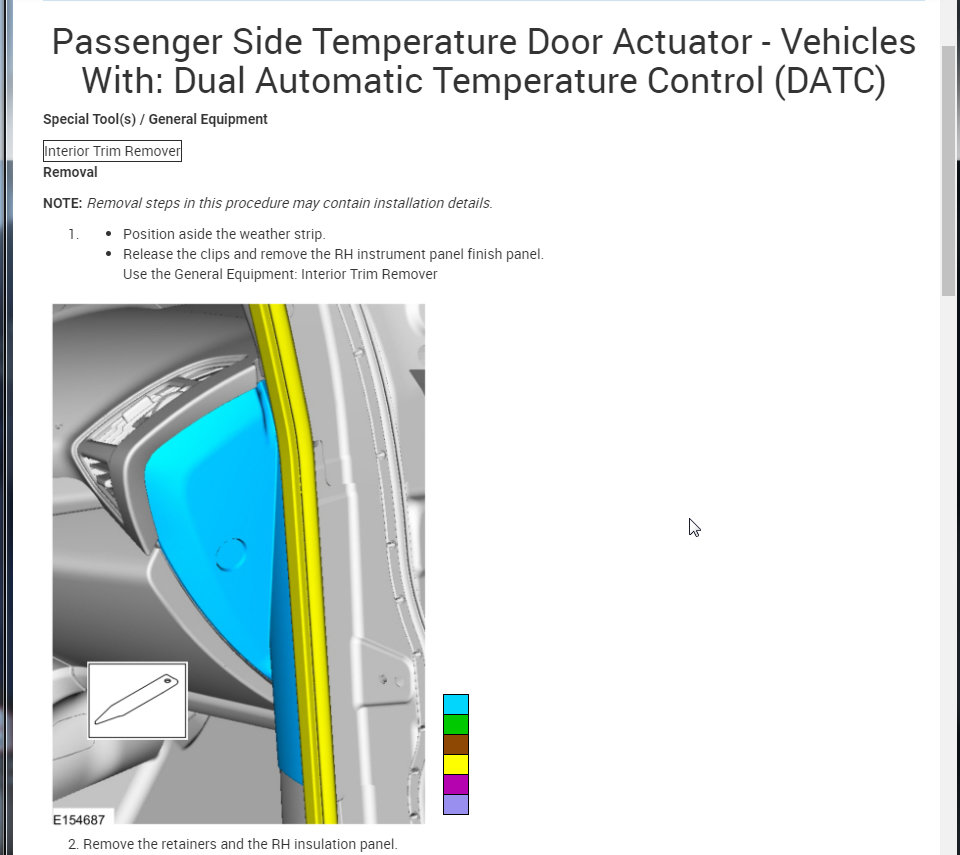

Sometime the heat is stronger coming from driver side vents than passenger. And amount of air coming out doesn’t seem to match. Suspect blend door actuator. Are there two? Where are locations of each? Thanks.
Mar 22, 2020 at 12:14 PM
There are two and I think you are correct. Here are both locations. Let us know if you need more info. Check out the diagrams (Below). Please let us know if you need anything else to get the problem fixed.
