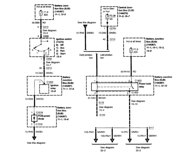

I have Ford Focus petrol 2006 1.6 Ghia, when my car is stationary for ten to fifteen minutes the gauge will increase to optimum temperature (about 88° and stays there), but when I travel around in the car the temperature drops slowly but surely back down to flat as though it is reading cold. Any ideas would be great? Thank you
Jan 4, 2019 at 9:56 PM
Good morning,

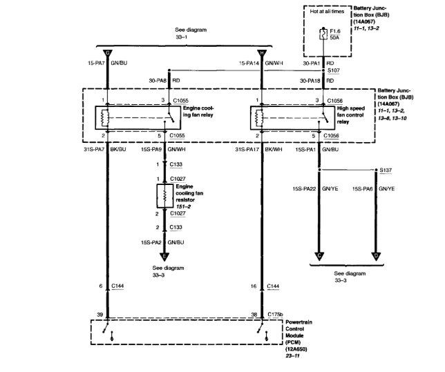

From your description, it sounds the cooling fan is not working. it needs to run at idle when there is no air coming through the radiator assembly.
Check the connection at the fan motor for power when it gets hot. if you have power then the motor is bad. it is a common failure for this issue.

Thanks for reply Roy, I really appreciate your help and thanks for the diagrams too.
Just to add a bit though. I need the car to be hotter when driving round as it is giving a cold reading even after a thirty mile journey (I thought I might of needed to find the sensor that's giving this reading), so in regards to your answer if the motor is bad do you think that the fan doesn't work at all?
