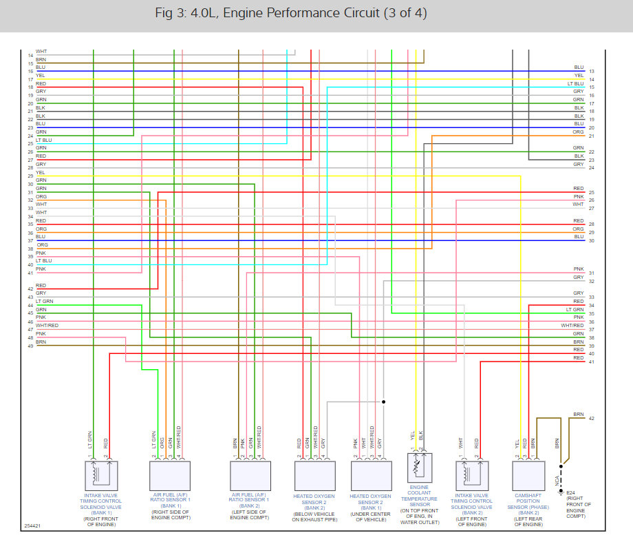

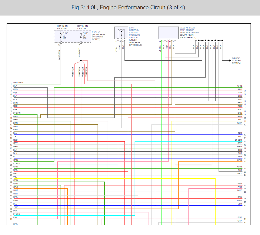

May you please help me with the color code of the lead that feeds into the coolant temperature sensor of the vehicle listed above? The loom was tempered with. So I'm failing to locate it.

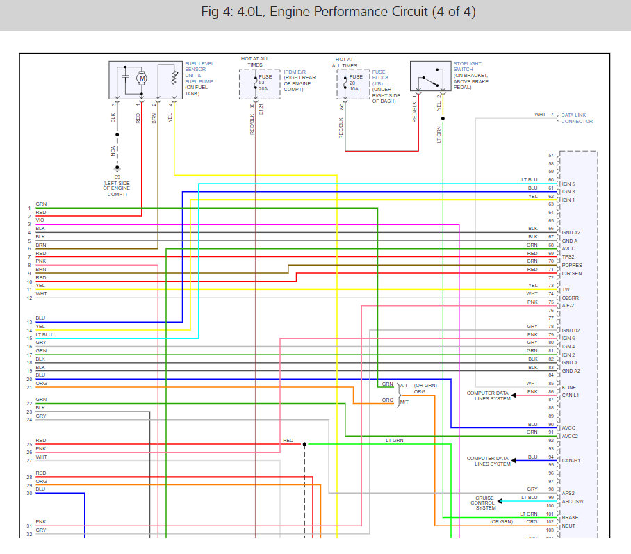

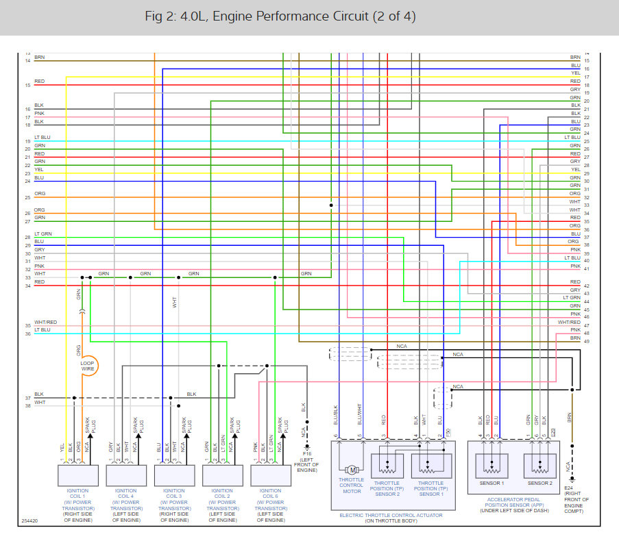

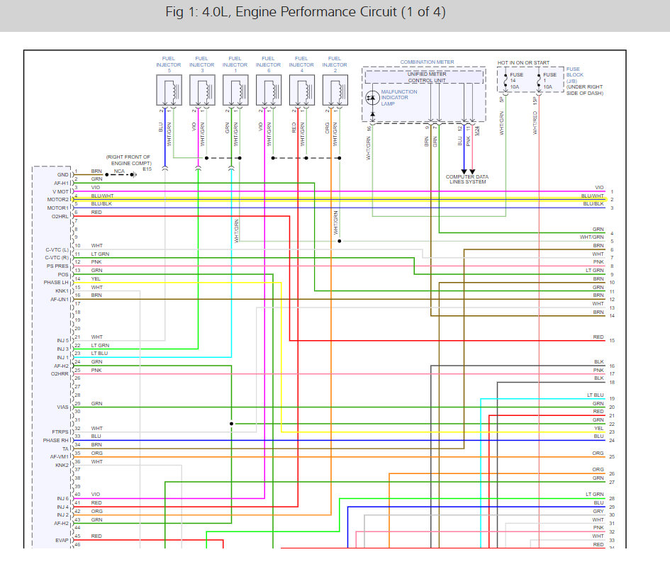

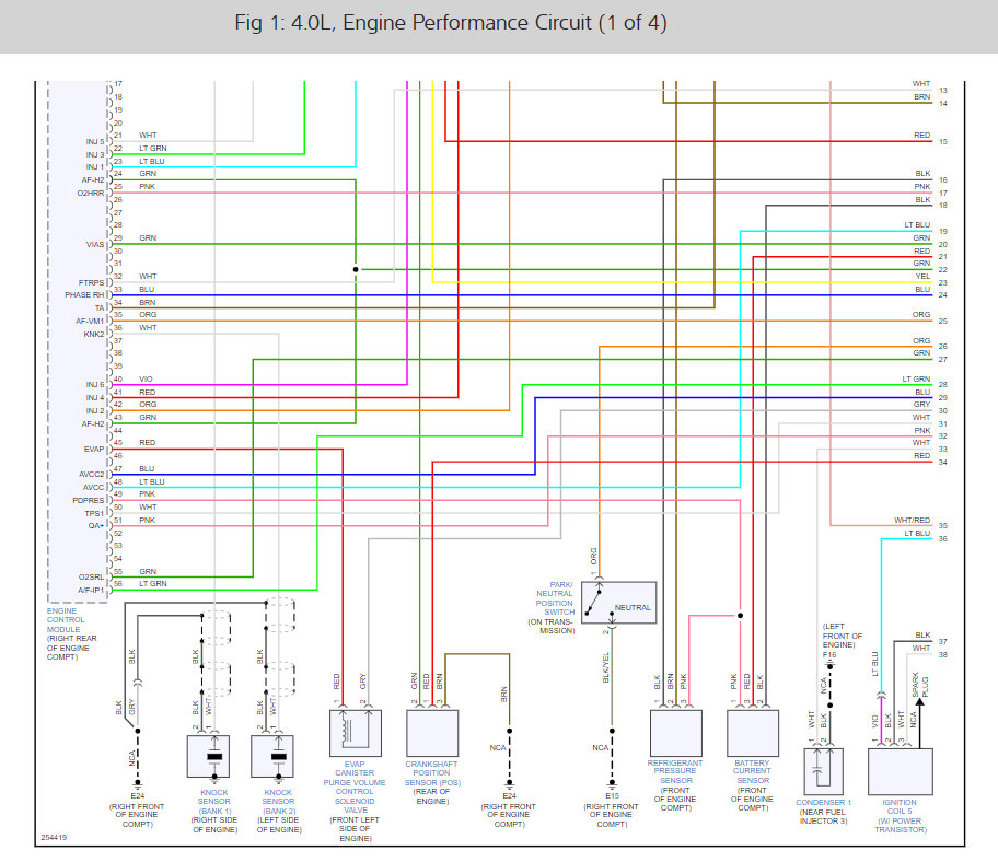

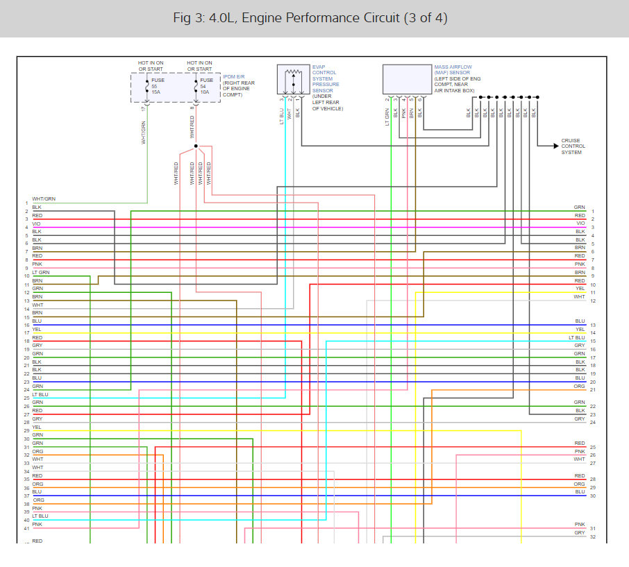

Here are the engine wiring diagrams which feature the coolant sensor wire colors and a guide to help you test the wiring once repaired:

Thanks a lot,but there is this other temperature sensor with a single lead that feeds into it. This in particular is the one I am inquiring on. I thank you.
