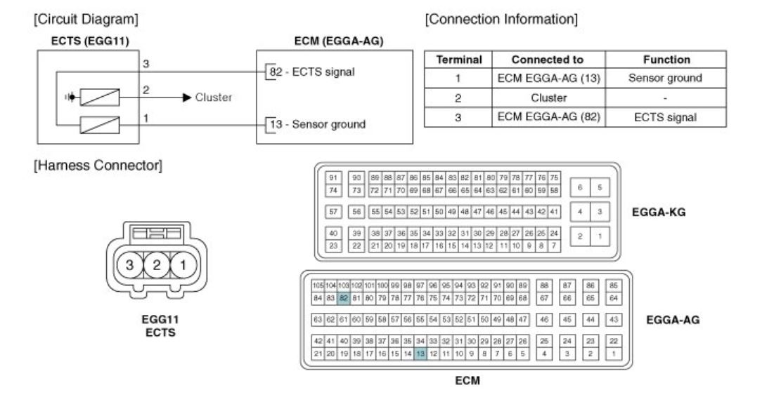

Description of Problem: I scan . P0118 KIA - engine coolant temperature sensor 1 circuit high input. Well, sir, my cooling fan has broken down. Now I replaced a new assemble cooling fan when I started the engine simultaneously with the cooling function it did not trip off. The A/C was not cool too. Even the temperature gauge is not working. Now I replaced the new temperature sensor. I still have the same result. The other mechanic said the engine computer module might be faulty. Then by checking the ECM there is only 3.28 voltages on the ECM going to the temperature sensor and there is nothing like continuity connection. sir it is possible the ECM is so broken sir. Thanks
Feb 2, 2018 at 10:24 AM
Okay, there is supposed to be a five volt signal sent to the sensor and the other wire is the return to the ECM.
if the connector does not have five volts, then I would check the ECM connector in the attached diagram. if the five volts is not present at the output of the ECM, then yes, it needs an ECM.

Sir, I check the ECM but there is only 3.28 voltages on the ECM. Is that enough?
Feb 2, 2018 at 10:29 PM
No, five volts is what the reference voltage should be.
if you only have 3.28 volts, then the ECM has failed.

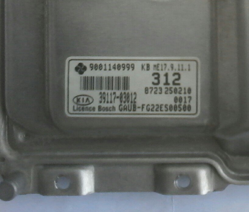

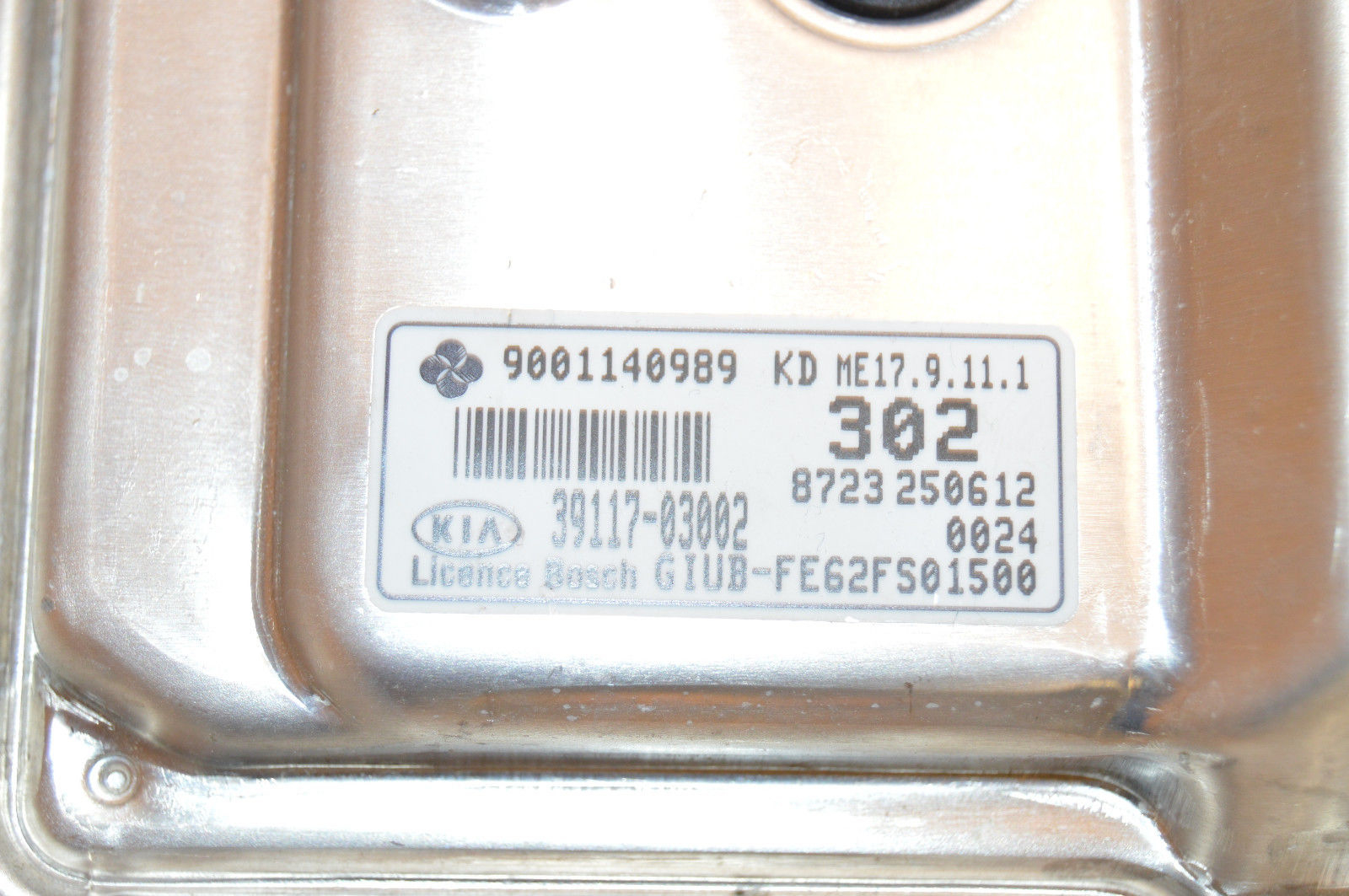

hi sir this is my ecu faulty with parts #39117-03012
And i replace defferent parts # 39117-03002
It is ok for my car?
Feb 6, 2018 at 8:00 PM
No, the numbers must be the same. if you install the other one, it may not work at all.
Feb 6, 2018 at 8:02 PM
