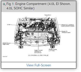

Hello, I have the vehicle listed above with an EFI OHV engine. I noticed on my gauge cluster two things that the temperature gauge does not work, so I cannot tell if the SUV is hot warm or cold. Which is dangerous because it may be overheating and I would never know because the gauge 85% of the time does not work. I am thinking maybe it is the coolant temperature sensor that is bad or malfunctioning? Does anyone know where the coolant temperature sensors are? Any diagrams? Video's? Does anyone know why the gauge for the temperature inside the SUV on the cluster is not working? Also, the gas gauge fluctuates. It does not stay in one spot, but it does not move far just maybe a half an inch sometimes. However, when I drive seems to sometimes go back in its correct reading. Anyone know what the issue might be?
Jun 27, 2018 at 8:55 AM
DANNY L
  • 5,648 POSTS
Hello, I am Danny.

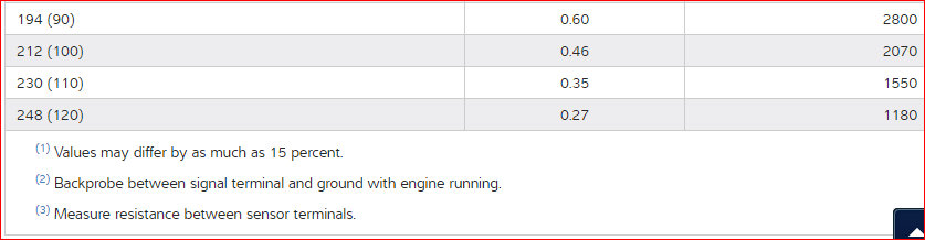

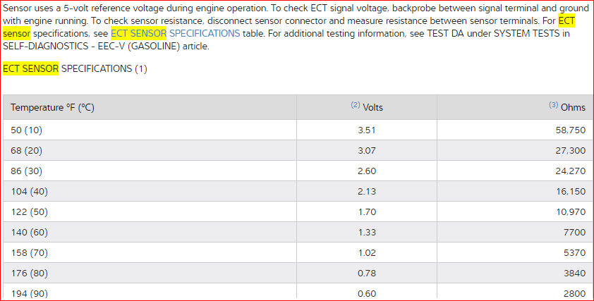

The coolant temperature sensor is located on the top front of engine in close proximity to the thermostat housing. I attached a picture and testing chart. As far as fuel gauge, does it bounce around? Or just settle in different levels?

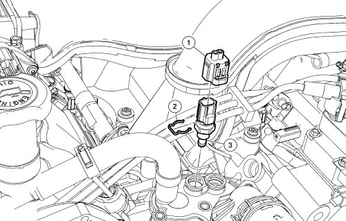

Oh, also, is there another diagram for the coolant temperature sensor? The first kind of blurs.
Jun 28, 2018 at 3:06 AM
DANNY L
  • 5,648 POSTS
Hello, Danny here. Okay, I will search for a more detailed picture and get back to you. Danny-
Jun 28, 2018 at 9:13 AM
DANNY L
  • 5,648 POSTS
Danny here.
I hope this is more clear. Let me know if this helps!
Danny-
Jun 28, 2018 at 12:07 PM

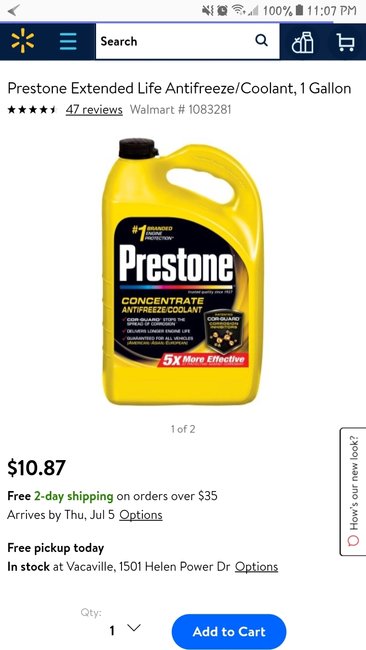

Great will do I did some searching for the antifreeze. AutoZone has there own brand they said would work, but Wal-Mart is cheaper for the concentrated version. Enclosed I am sending a screen shot of the one I found would this one be good for the flush and refill on my SUV?
Jun 29, 2018 at 4:14 PM
DANNY L
  • 5,648 POSTS
Hi again.
Absolutely! Prestone is a great brand! Your system requires 3.5 gallons so you should get two bottles (which would equal four). Just be sure to flush system really good with just water first before adding the coolant and you will be good to go.
