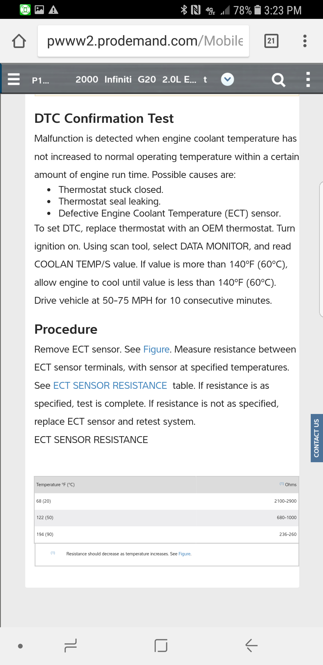

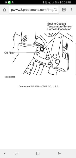

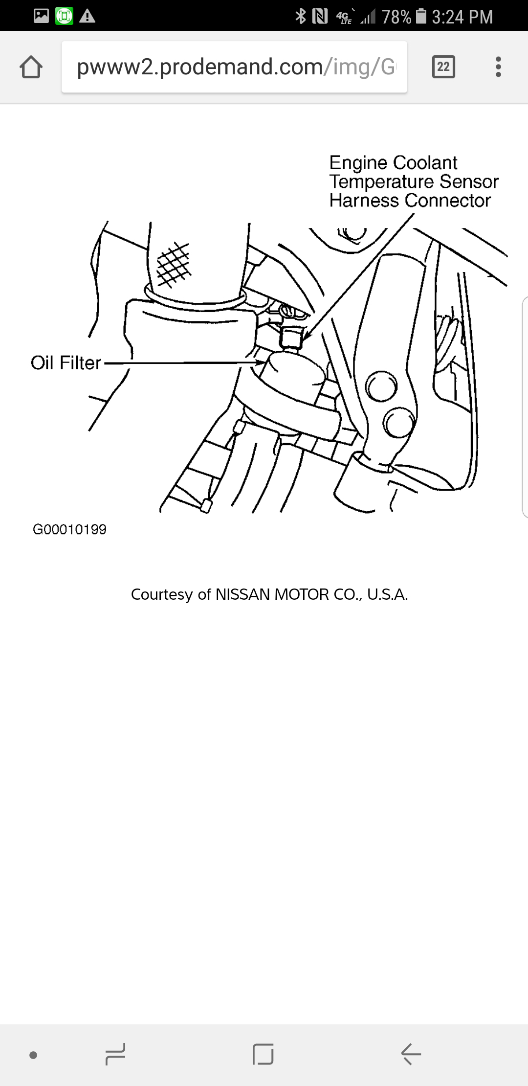

Check engine light code P1126. Temperature sensor i need to locate this sensor?
Jan 7, 2018 at 7:09 AM
SATURNTECH9
  • 30,869 POSTS
I posted the information for the code and where the temperature sensor is located, but with that code you more than likely have a bad thermostat not coolant temperature sensor.
