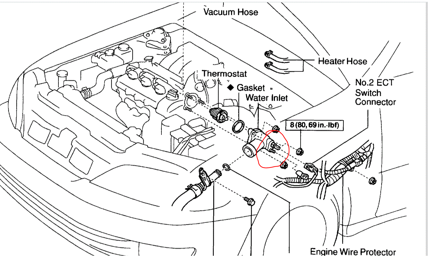

The car shut off and tester said temperature sensor, where is the temperature sensor?

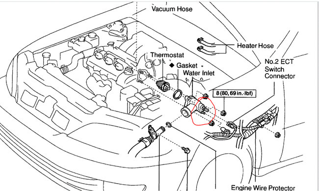

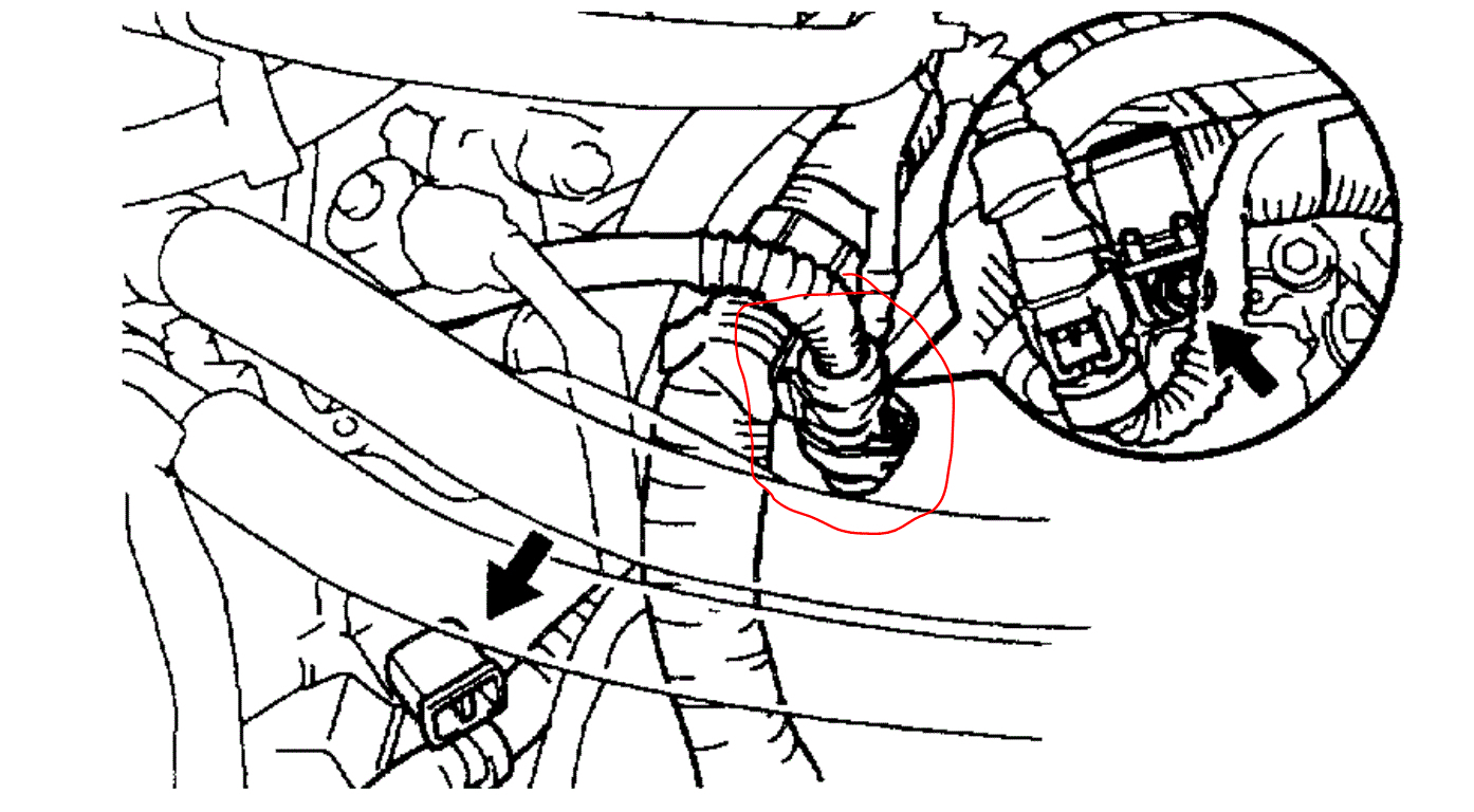

The ECT is located near the thermostat housing and below the heater hoses. I attached two pics below showing it.
Can you tell me what code was retrieved?
