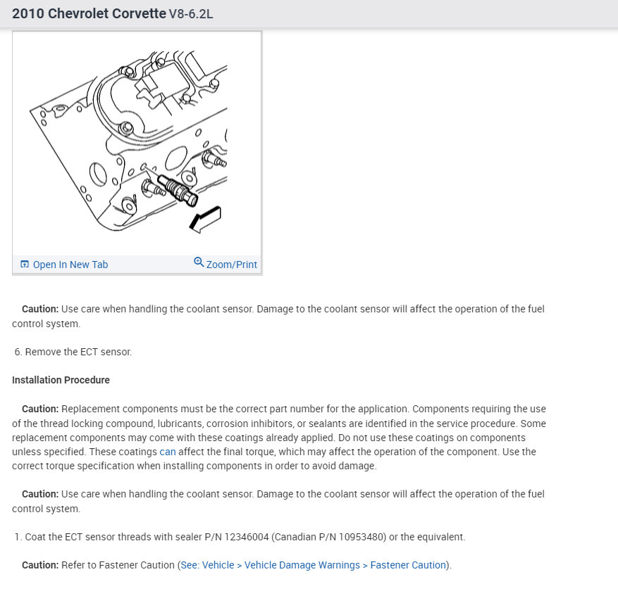

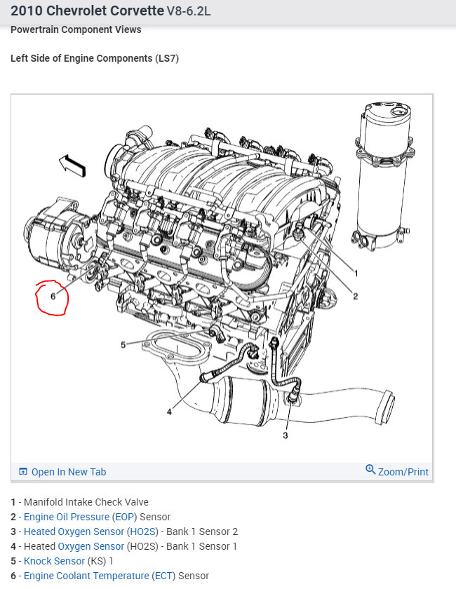

where is it located?
Jan 14, 2022 at 6:29 AM
SQM
  • 6,383 POSTS

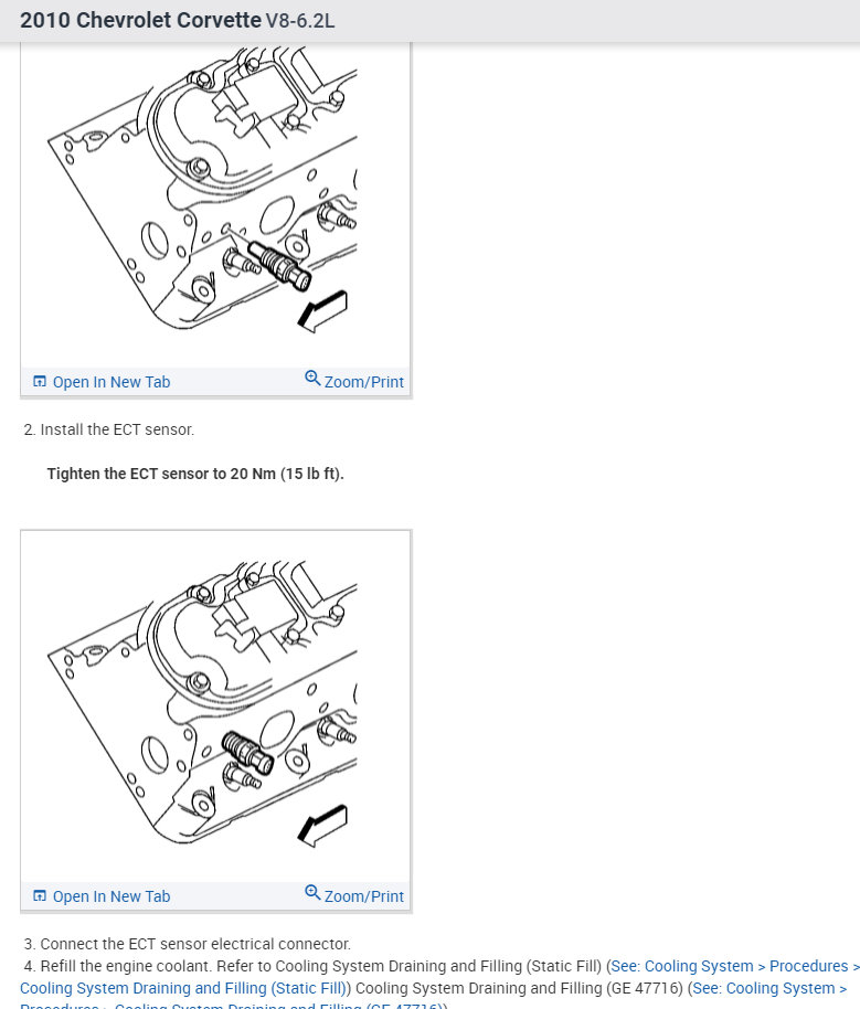

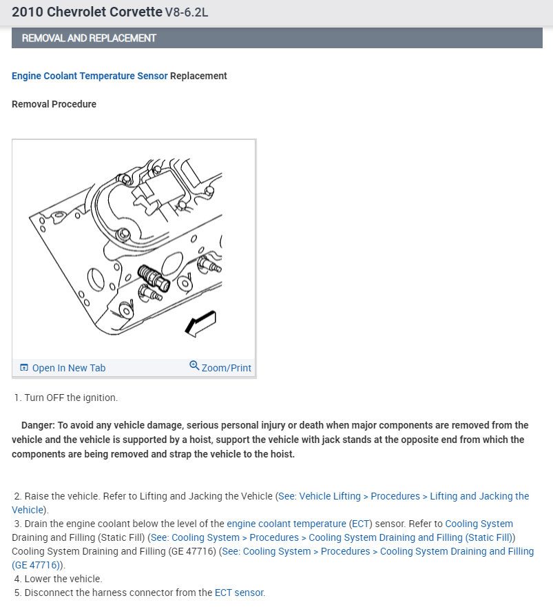

I am assuming you are looking for the coolant temperature sensor.
It is located behind the alternator on the driver's side (see diagram below).
https://www.2carpros.com/articles/how-a-coolant-temperature-sensor-works
https://www.2carpros.com/articles/coolant-temperature-sensor-cts-replacement
