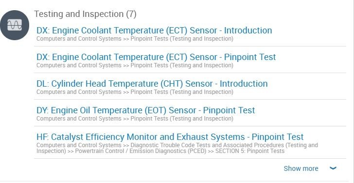

Where is the temperature sensors located? I cannot find a diagram for my vehicle listed above e350.

What sensors specifically are you looking for?
There are several temperature sensors. I attached a list of them. Which one or ones are you looking for?

It is in the top corner of the left hand cylinder head. Straight back of the alternator and below the thermostat housing. It is a cylinder head temperature sensor. The 5.4 does not use an actual coolant temperature sensor.
