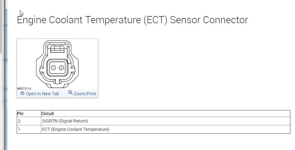

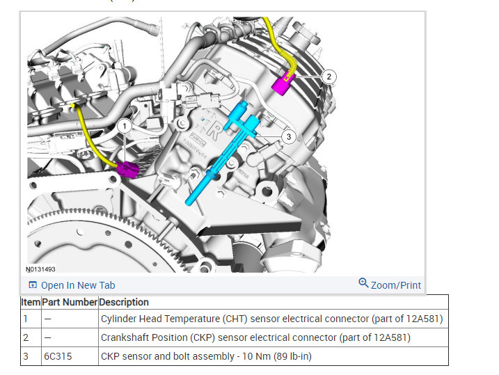

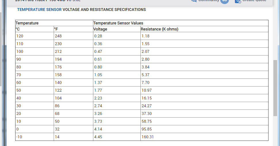

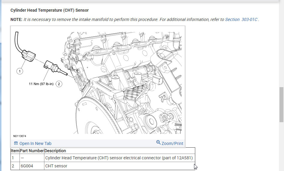

This sounds more like a sensor issue. Let's start with testing the sensors resistance when this is happening. So drive the vehicle so that it starts doing it and then measure the resistance across the terminals of the sensor. You can just unplug it and put your meter across and use the chart to find out if that is accurate. If the engine is warm then the use the temp range of 176-248. It should be in this range if it is reading accurately. Clearly if the gauge is at full cold then it will be reading with the resistance of -10 to 20 degrees.
You can clearly use the voltage measurement as well if you are more comfortable with that.
Let me know what questions you have. Thanks

Just noticed that I didn't attach the info on this sensor. Clearly you may not need it but others may that visit this site. Thanks

So they put the new sensor in.
I also had a bad cell in my battery they discovered. Put new one in. And all seems to be good as new at the moment.
