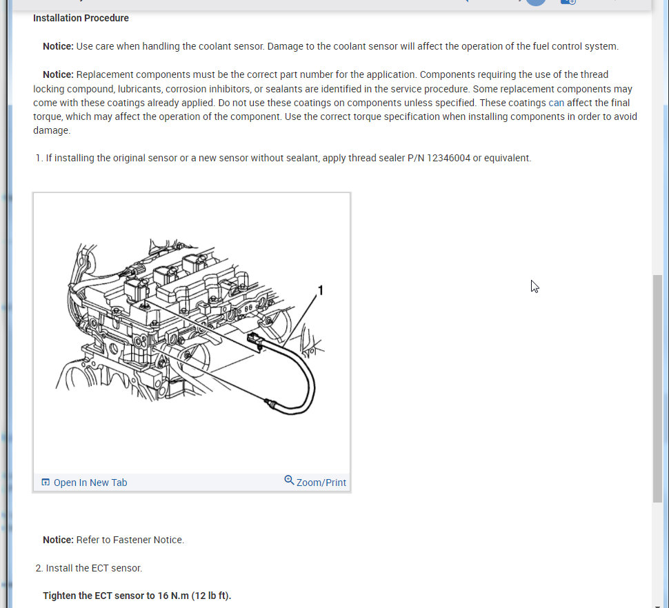

Sometimes my temperature gauge randomly stops working. The car doesn't seem to overheat when it does, no smells or visible leaking coolant. Also, the heat only works on the passenger side, I don't think the back heater even turns on, and the driver side blows out cold air. I haven't tried the A/C so I don't know if it even works.
Mar 28, 2021 at 5:48 AM

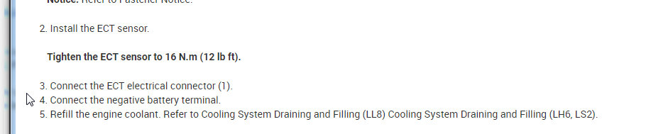

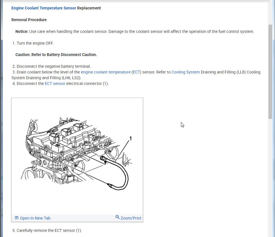

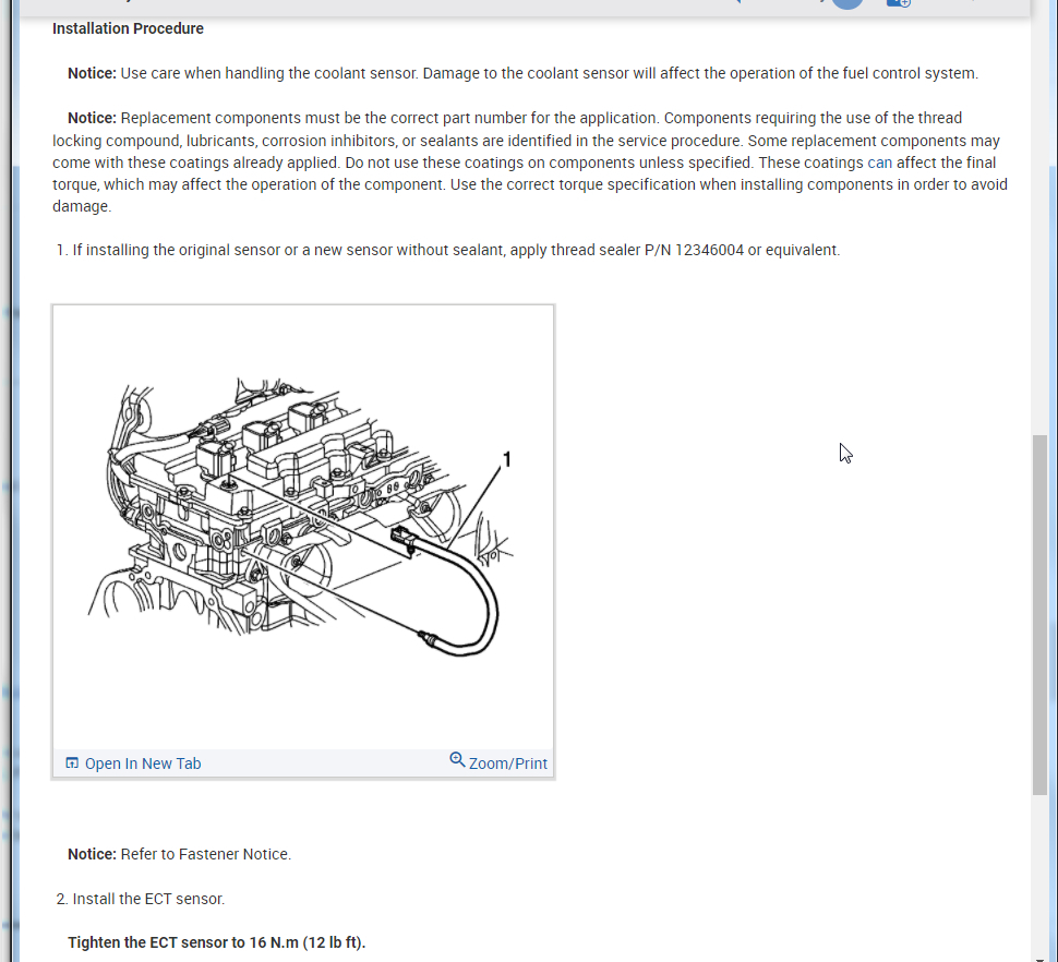

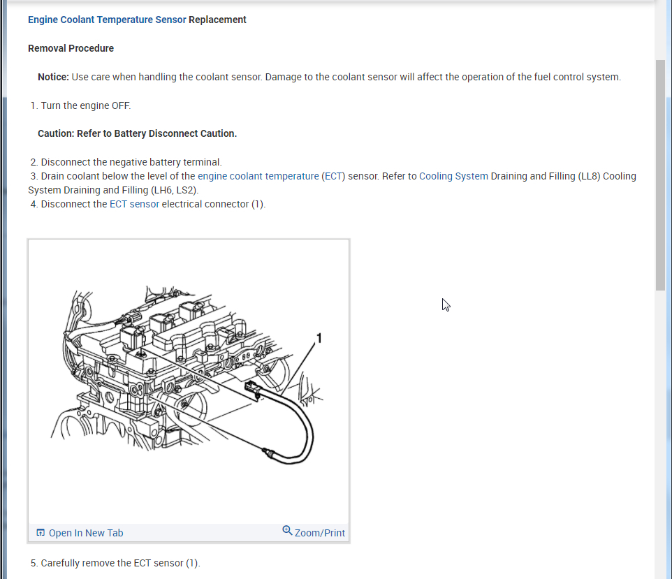

More then likely this is the coolant temperature sensor is beginning to fail. What happens is when this begins to fail it can act erratically or just stop reading all together.
I attached the process below on how to replace it which is what I would do in this situation.

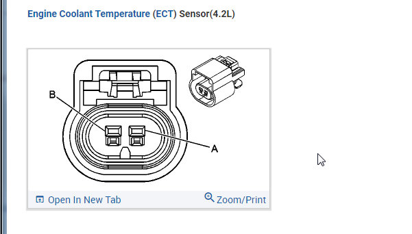

However, if this is not happening all the time then you may want to wait until it acts up again to test it. When it does, we need to check the voltage on the sensor to find out if it is operating. I suspect you will find 0 volts which would indicate the sensor is not operating.
Let us know if you have questions on this. Thanks
