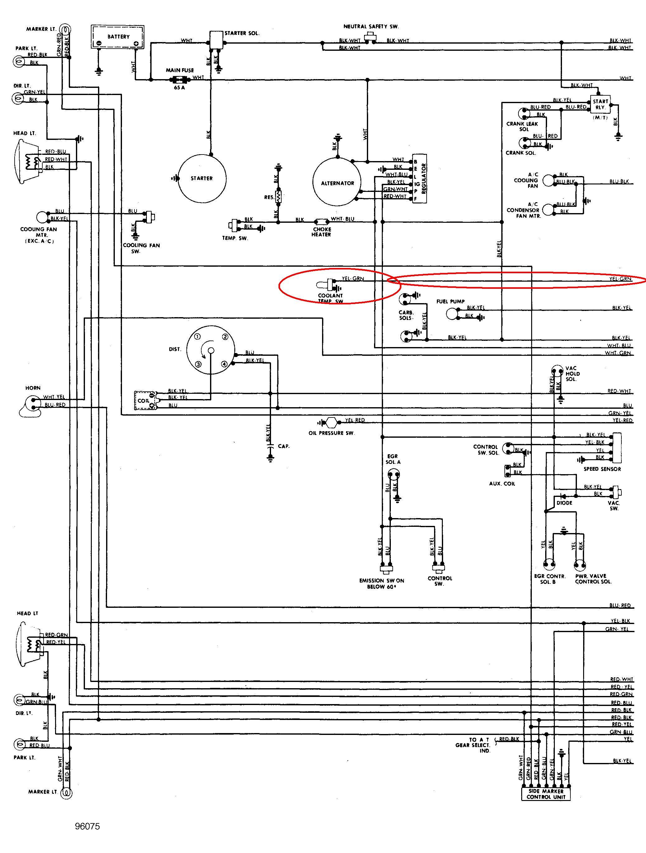

Temperature gauge reads high, fuel gauge reads high when nearly empty and tachometer doesn't work I recently tuned up my father in law's 1983 Honda Accord and suddenly the temperature gauge reads in the red and it's not hot. At the same time, the fuel gauge reads 3/4 full when the low fuel light is on and the tachometer doesn't work. I've checked the fuses and they look ok. The only thing I did was new spark plugs, wires and a new cap and rotor. This sure is puzzling.

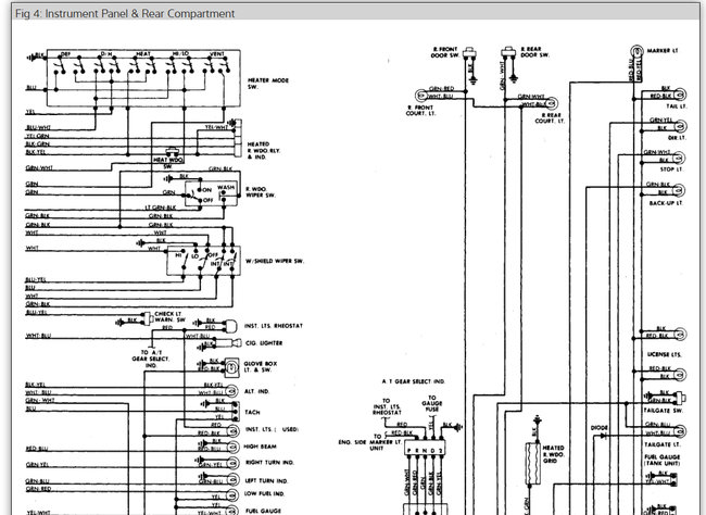

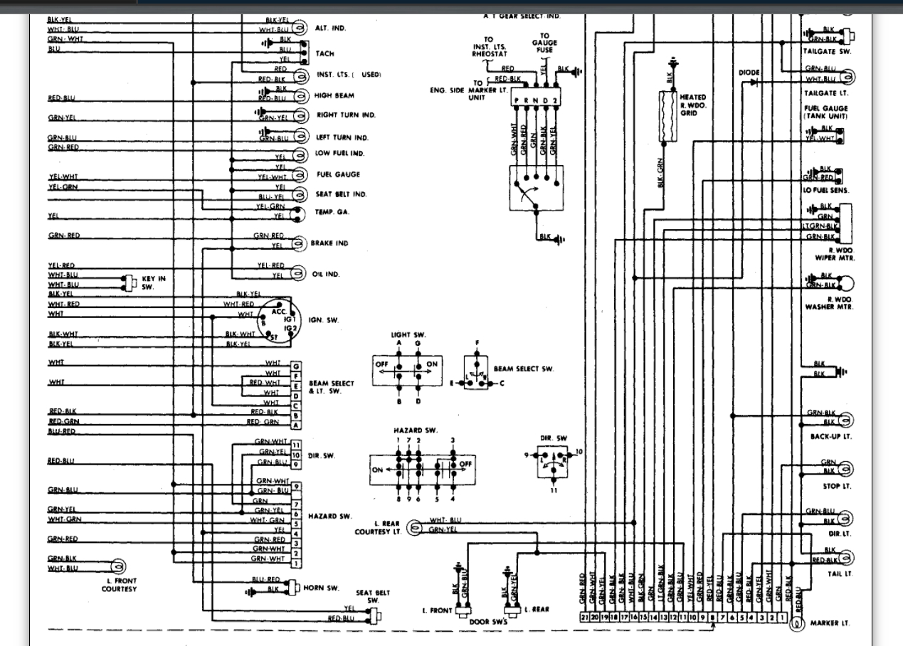

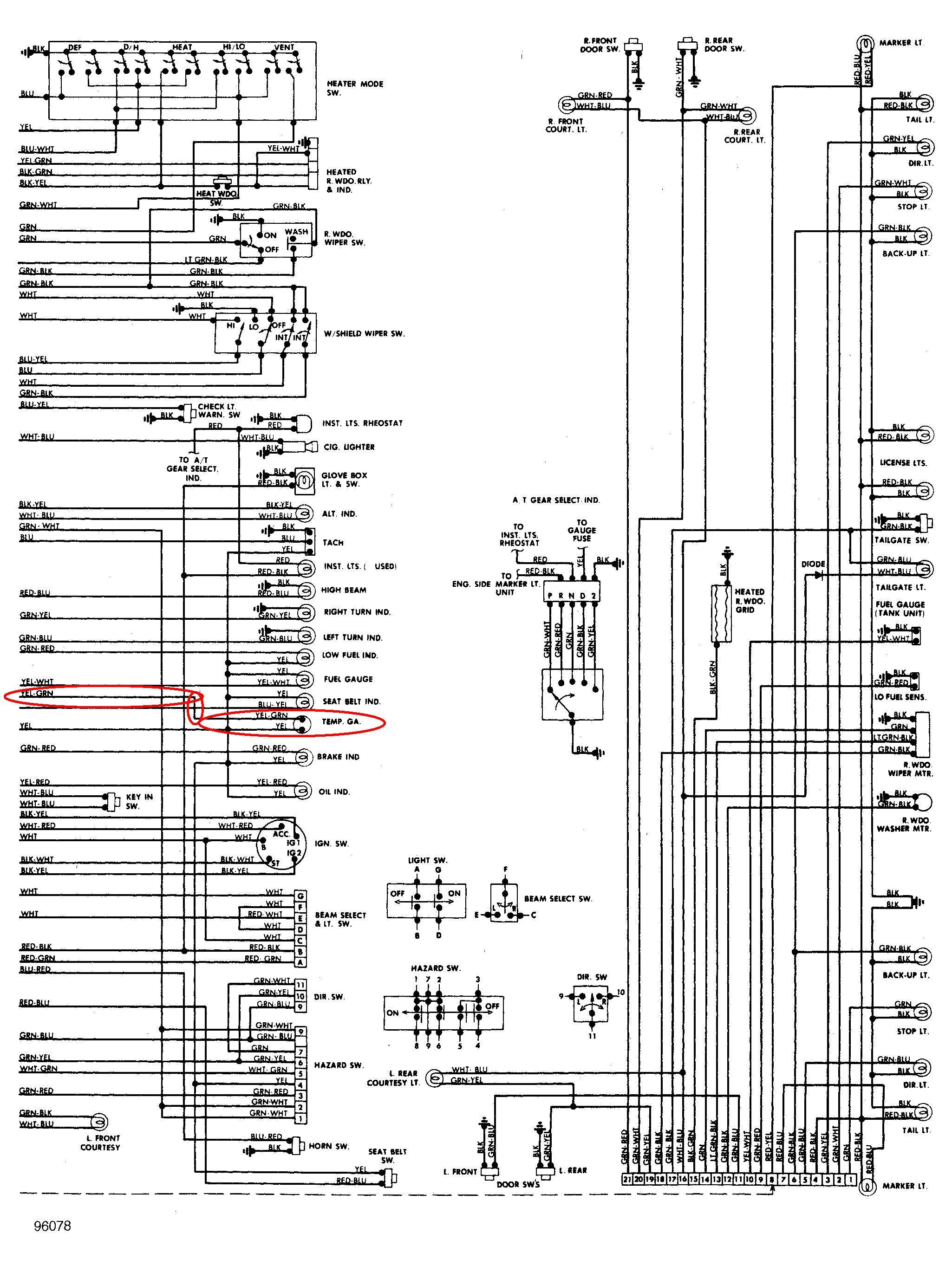

Got you 2 diagrams.
Follow the yellow/ green wire-it goes from the temp switch to the gauge
you may have squished it
it may have rubbed thru the insulation and now is touching "ground"
maybe you tied some other accessory into it
something under the dash may be grounding the gauge
all of the above would mean the wire is grounded-especially if the second you turn the key on it rises to the top
(just some useless info as a test, grounding "sender wires" such as to the fuel or temp gauge let's me/ us/ anybody know if the gauge or the sender is bad)--yours seems to be testing itself!
Other than that---maybe a defective sender or a bad gauge
to "verify" the wire may be grounded you can take it loose at the gauge and see if it drops
with the key on - if there are "connectors" on the way to the sender, disconnecting them---as you progress, may make the gauge drop and sorta let you know which way on the wire that the problem is
extreme case with no connectors (key on)---find an ez to fix place on the wire and cut that puppy!---Does the gauge drop or not?--Investigate the wire further on if it did drop
my last pic-"willy's" fuel tank sender - although my float is "up" and my gauge is on full - this is exactly what would happen if I "grounded" the sender wire anywhere along the wire from the sending unit all the way to the gauge - in fact - I could ground the "stud" that the sender wire connects to on the gauge itself and the gauge would peg out
lemme know if this helps

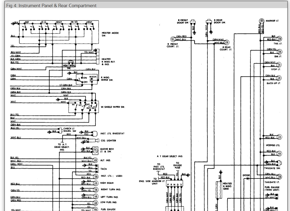

I have identical issue, identical car, but 140,000 miles. All mentioned gauges working correctly yesterday, but today no rpm, temp pegs high when not hot, fuel gauge pegs high when actually under 1/4 tank. Seems electrical to me. Anyone have a experience or a fix?

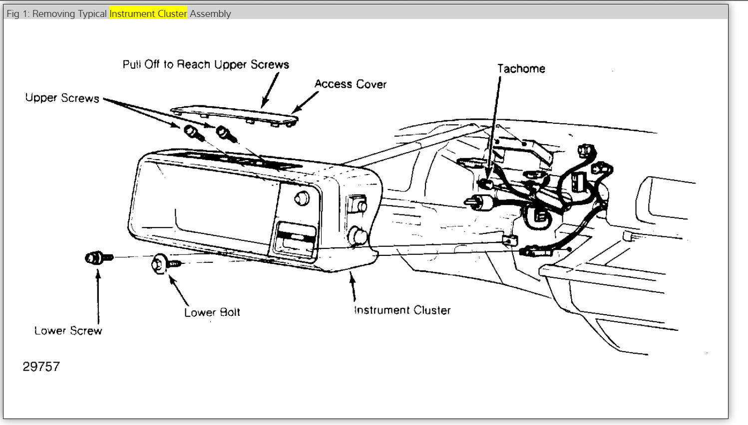

This sounds like a bad connection at the cluster. I would remove it and check for corrosion. Also check the ground circuit in the connector here is a guide to help.
