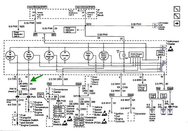

If you see other gauges are also reading too low, we'll need to look at the 12 volt circuit that feeds the instrument cluster from the "Gauges" fuse on the left side of the dash. A good suspect would be corrosion on the laminate connector terminals on the back side of the cluster. Next would be corrosion on the fuse terminals.
A common problem introduced when replacing the gauge's temperature sensor is wrapping the threads with teflon tape to help them seal. That's okay with the Engine Computer's two-wire sensor because its second wire is the ground circuit, but with the gauge's sensor, those threads make the ground circuit. Teflon tape and many other sealants interfere with that connection. Usually the gauge won't move at all off "cold", but another problem that plagues GM products is acid build-up in the coolant, especially once they switched to the red "Dex-Cool" antifreeze. That acid causes "galvanic action" which is what takes place inside the battery, and is desirable, and in the cooling system where it results in corroded and leaking heater cores and radiators. The current flow that acid allows can result in the temperature gauge reading something, but that is not a good way to get a ground circuit.

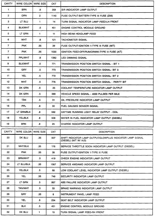

If you haven't found anything up to now, you'll need to remove the cluster, then measure the resistance from the appropriate terminal to ground. According to the service literature, the sensor should read 49 ohms at 260 degrees, (not very practical to expect us to measure that), and 1305 ohms at 100 degrees. Instructors never require their students to memorize these values because they will be different on every vehicle, and we never make a diagnosis based on those numbers. We're interested in changing something when there's a problem to be solved, and even then we rarely measure these numbers. Yours is a case of finding what you have now for resistance, making an educated guess if it looks feasible, and finding the cause when it's not right. To say that a better way, we don't care what the exact values are. We want to find what has changed recently.
These resistance values show there is about an 800 - 1200 ohm difference between "cold" and "hot". Sensor resistance goes up as its temperature goes down. I'd expect to find around 1800 to 2000 ohms at 60 degrees, meaning a warm day when the engine hasn't been run yet. A better approach would be to measure the resistance of the old sensor, unplug and measure the new sensor, then plug it back in and take the measurement from the instrument cluster's plug. It's highly unlikely all three of those are going to be the same. Knowing those will give us a place to start looking.

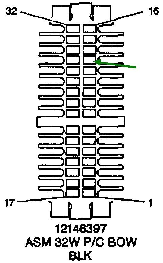

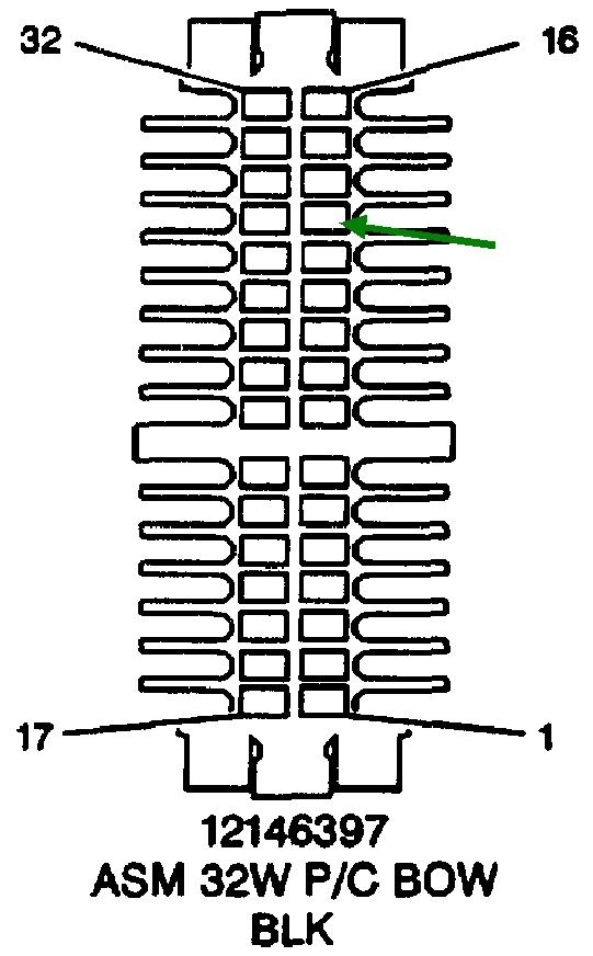

The green arrow is pointing to terminal 13 in the instrument cluster's plug. That's for the coolant temperature sending unit.
