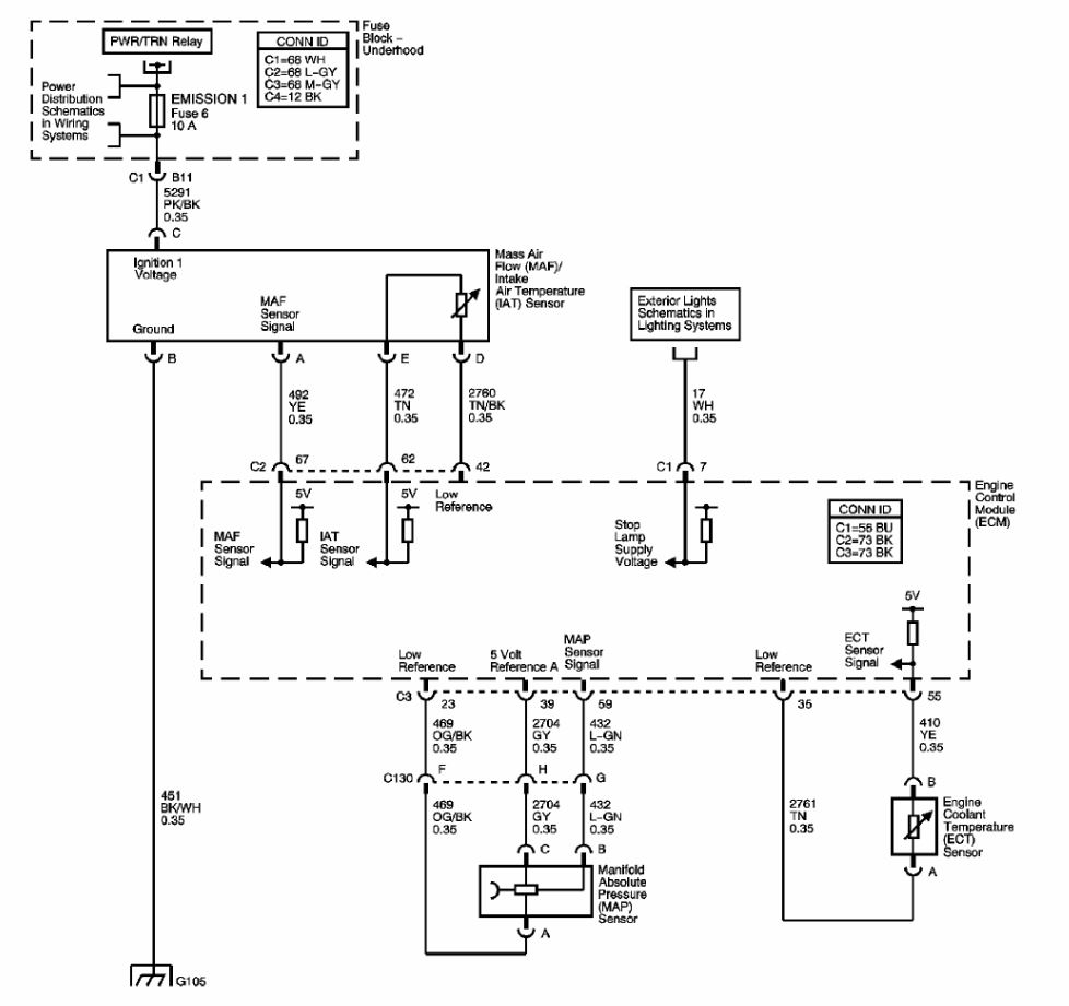

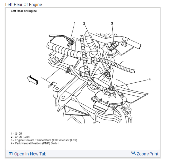

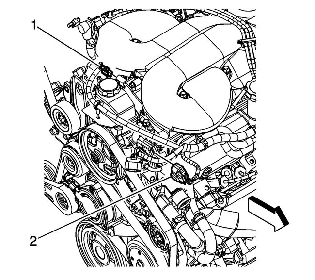

https://www.2carpros.com/articles/coolant-temperature-sensor-cts-replacement

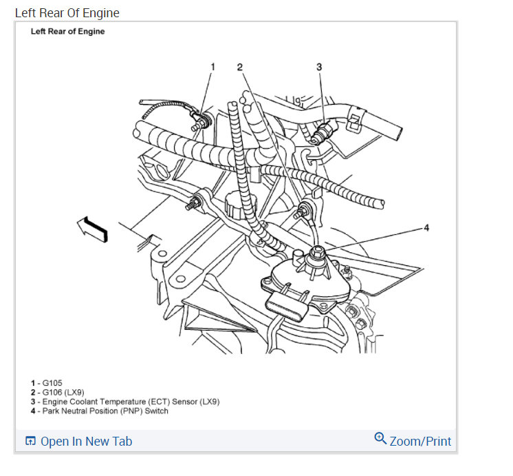

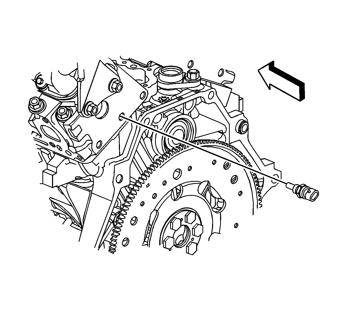

Here are the directions specific to your vehicle. The attached pics correlate with the directions.
________________________
2006 Pontiac G6 V6-3.9L VIN 1
Removal and Replacement
Vehicle Powertrain Management Sensors and Switches - Powertrain Management Sensors and Switches - Computers and Control Systems Coolant Temperature Sensor/Switch (For Computer) Service and Repair Removal and Replacement
REMOVAL AND REPLACEMENT
ENGINE COOLANT TEMPERATURE (ECT) SENSOR REPLACEMENT
REMOVAL PROCEDURE
NOTE: Use care when handling the coolant sensor. Damage to the coolant sensor will affect the operation of the fuel control system.
pic 1
1. Drain the cooling system. Refer to Draining and Filling Cooling System. See: Cooling System > Removal and Replacement
2. Remove the intake manifold cover, if necessary.
3. Disconnect the engine coolant temperature (ECT) sensor electrical connector.
4. Remove the ECT sensor.
INSTALLATION PROCEDURE
NOTE: Replacement components must be the correct part number for the application. Components requiring the use of the thread locking compound, lubricants, corrosion inhibitors, or sealants are identified in the service procedure. Some replacement components may come with these coatings already applied. Do not use these coatings on components unless specified. These coatings can affect the final torque, which may affect the operation of the component. Use the correct torque specification when installing components in order to avoid damage.
pic 2
1. Coat the threads of the ECT sensor with sealer GM P/N 13246004 (Canadian P/N 10953480) or equivalent.
2. Install the ECT sensor.
NOTE: Refer to Fastener Notice.
Tighten the ECT sensor to 20 N.m (15 lb ft).
3. Connect the ECT electrical connector.
4. Install the intake manifold cover, if necessary.
5. Fill the cooling system. Refer to Draining and Filling Cooling System. See: Cooling System > Removal and Replacement

I would go to the ECM and find those two wires, measure the resistance at the sensor, then measure it at the ECM connection. If the numbers match within an ohm or two you have a good connection and harness. If not then check end to end of each wire.
Nov 12, 2020 at 2:42 AM (Merged)

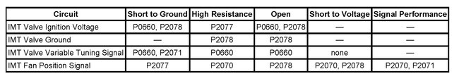

First, the codes are all related. I suspect the tuning valve needs replaced. However, we need to confirm it first.
The P0660 relates to the intake manifold tuning valve. An intake manifold tuning (IMT) valve is used to change the intake manifold plenum configuration. When the IMT valve is open, the intake manifold is configured to one large plenum. When the IMT valve is closed, the intake manifold is configured to 2 smaller plenums. The IMT valve improves engine performance at low and high engine speeds depending on the engine load.
As far as the P2070, it indicates the control module detects that the IMT valve is stuck open and the P2078 indicates high voltage to the control valve.
Both of these codes indicate to perform the diagnostics for code P0660 first before continuing. I suspect the tuning valve has shorted and needs replaced, but the test will confirm.

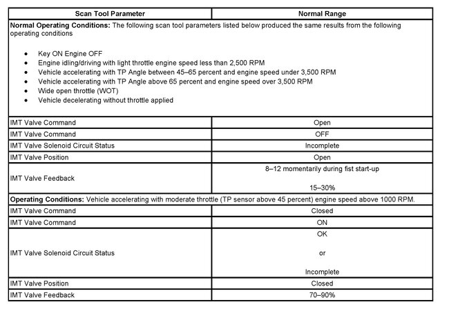

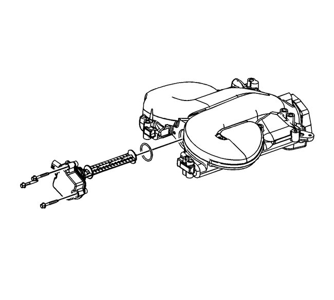

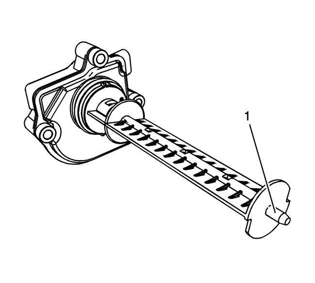

Here is everything related to that code. The two attached pics correlate with this information.
__________________________________________
P0660
Vehicle ALL Diagnostic Trouble Codes ( DTC ) Testing and Inspection P Code Charts P0660
P0660
DTC P0660
DTC DESCRIPTOR
DTC P0660
Intake Manifold Tuning (IMT) Valve Solenoid Control Circuit
DIAGNOSTIC FAULT INFORMATION
IMPORTANT: Always perform the Diagnostic System Check - Vehicle prior to using this diagnostic procedure. See: A L L Diagnostic Trouble Codes ( DTC ) > Testing and Inspection
pic 1
TYPICAL SCAN TOOL DATA
pic 2
CIRCUIT/SYSTEM DESCRIPTION
An intake manifold tuning (IMT) valve is used to change the intake manifold plenum configuration. When the IMT valve is open, the intake manifold is configured to one large plenum. When the IMT valve is closed, the intake manifold is configured to 2 smaller plenums. The IMT valve improves engine performance at low and high engine speeds depending on the engine load. The IMT valve assembly consists of the following:

CIRCUIT/SYSTEM VERIFICATION
Command the IMT valve ON. The IMT Valve Command parameter should transition from open to closed and the IMT Valve Feedback parameter should transition from 15-30 percent to 70-90 percent.
CIRCUIT/SYSTEM TESTING
1. Ignition ON, measure for battery voltage between the IMT valve ignition voltage circuit and ground. Battery voltage should be measured.
- If less than battery voltage test the ignition voltage circuit for an open, high resistance or short to ground, if shorted to ground replace the fuse that supplies the voltage.
2. Connect a test lamp between the IMT valve ignition voltage circuit and ground circuit at the IMT valve harness connector. The test lamp should illuminate.
- If The test lamp does not illuminate, test the ground circuit for an open or high resistance.
3. Ignition ON, disconnect the IMT valve harness connector and measure for 0.5 volt on the variable tuning signal circuit and ground.
- If less than 0.5 volt test the variable tuning signal circuit for an open or high resistance, short to ground, or a faulty control module.
- If more than 0.5 volt test the variable tuning signal circuit for a short to voltage or a faulty control module.
4. Measure for 5.0 volts on the IMT fan position signal circuit at the IMT valve harness connector.
- If more than 5 volts, test the IMT fan position signal circuit for a short to voltage.
- If less than 5 volts, test the IMT fan position signal circuit for an open, high resistance, or short to ground.
- If all circuits test OK, replace the IMT valve.
REPAIR INSTRUCTIONS
- Control Module References
- Intake Manifold Tuning Valve Replacement
REMOVAL PROCEDURE
pic 3
1. Remove the intake manifold cover.
2. Disconnect the intake manifold tuning valve electrical connector (1).
3. Remove the engine harness clip from the power steering reservoir bracket.
4. Remove the power steering pump.
pic 4
5. Remove the intake manifold tuning valve bolts.
6. Remove the intake manifold tuning valve.

pic 5
1. Apply lubricate GM P/N 1051344 (Canadian P/N 993037) to the nose of the valve blade (1).
pic 6
2. Install the intake manifold tuning valve.
3. Install the intake manifold tuning valve bolts.
Tighten the bolts to 10 N.m (89 lb in).
