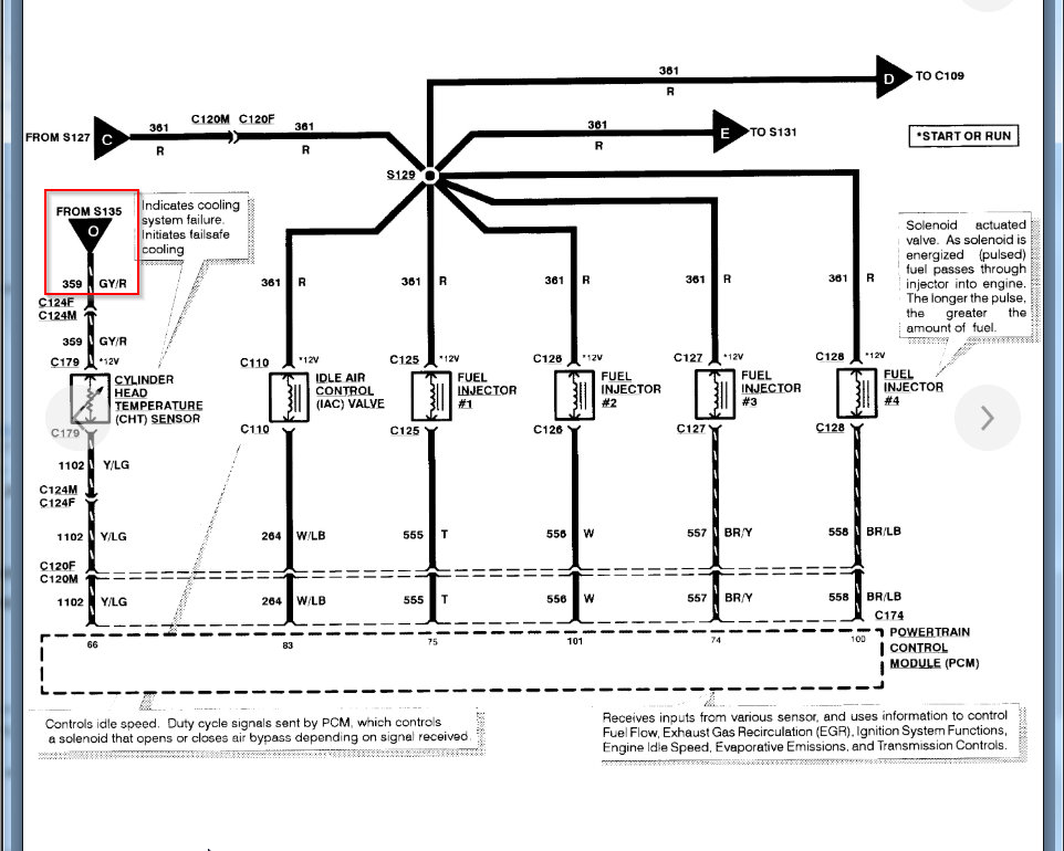

So my coolant temperature gauge worked before then stopped. I replaced the coolant temperature sensor still nothing, but when I put a test light to the connector the gauge jumps to hot, so I know the gauge is working and the wires are sending power. What else could cause it not to read when connected to the sensor ?

Do you have a volt meter? Let's check what the voltage is on this connector when you are jumping the terminals to make the temp gauge go to hot.
Next can you get me the part number of the temp sensor that you put in the vehicle? Clearly I am in agreement that this sounds like a sensor issue so we need to do these couple checks first before we say that the sensor you replaced is failed as well.

Correct a multi-meter so we can see what the actual voltage is. That appears to be the correct sensor for the vehicle so we may have just gotten a faulty one if the voltage checks out. Thanks

Correct. Just do both wires. So test one wire when your black lead on ground and tell me that voltage and then the other wire with the black lead on ground. You should have a GY/R wire and a Y/G wire. Let me know what the voltage is on each one.

Voltage read around 1.69 volts and I tested the sensor for resistance and got nothing back from it. so my guess is bad sensor ?
