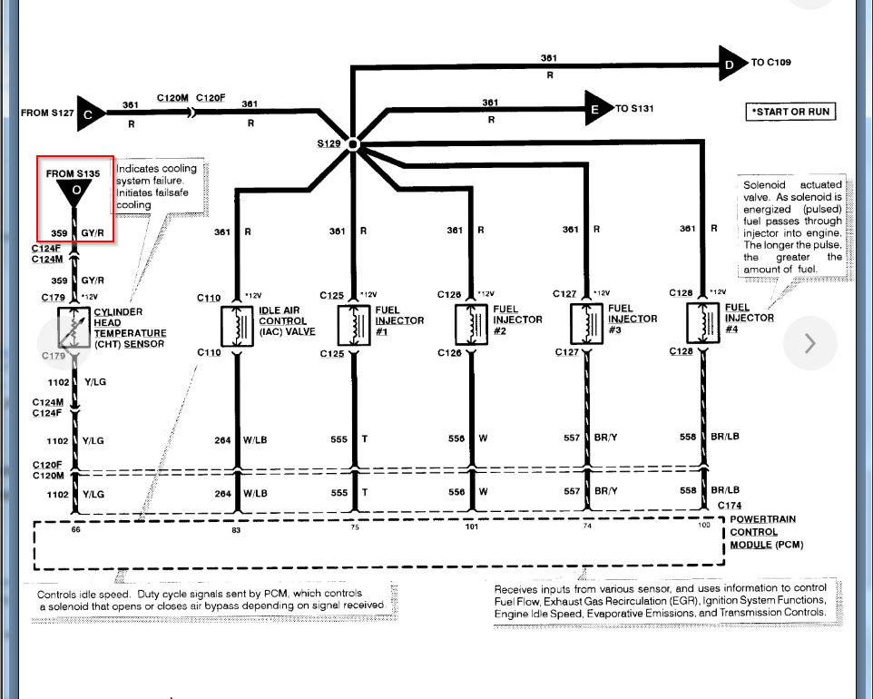

So my coolant temperature gauge worked before then stopped. I replaced the coolant temperature sensor still nothing, but when I put a test light to the connector the gauge jumps to hot, so I know the gauge is working and the wires are sending power. What else could cause it not to read when connected to the sensor ?

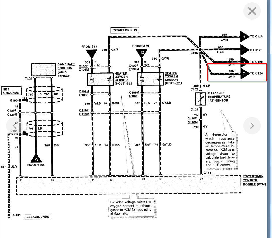

Correct. Just do both wires. So test one wire when your black lead on ground and tell me that voltage and then the other wire with the black lead on ground. You should have a GY/R wire and a Y/G wire. Let me know what the voltage is on each one.

Voltage read around 1.69 volts and I tested the sensor for resistance and got nothing back from it. so my guess is bad sensor ?
