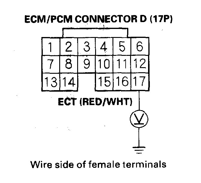

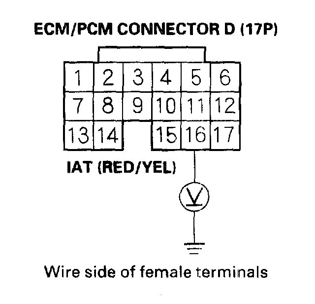

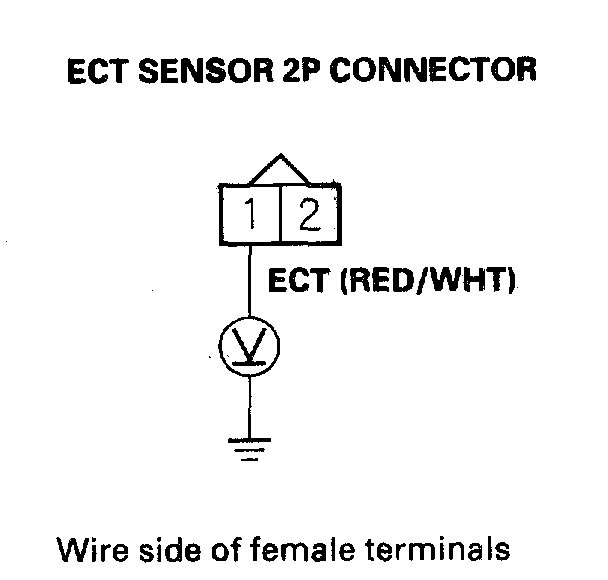

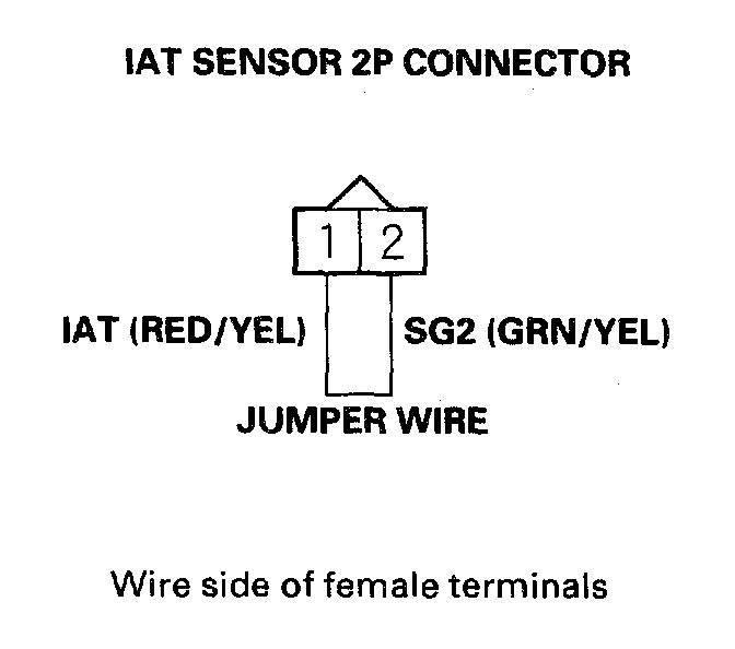

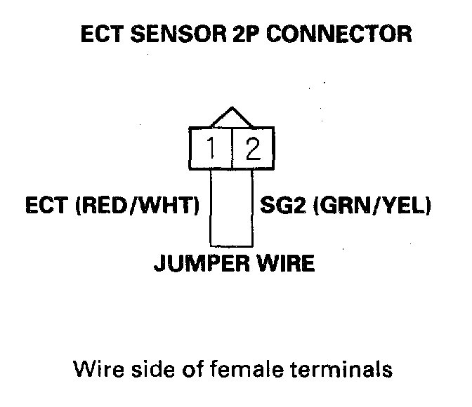

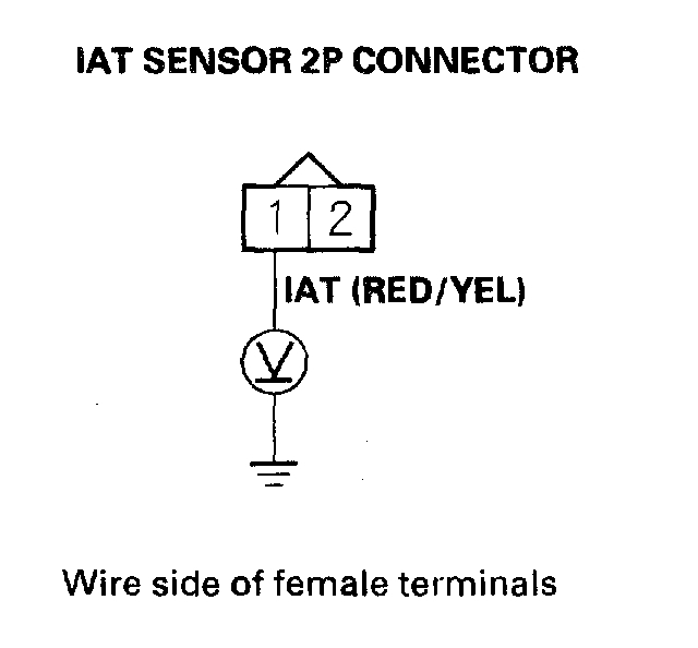

Temperature gauge goes up and codes P0118 and P0113
2004 ACURA TL
60,000 MILES • 3.2L • 6 CYL • 2WD • AUTOMATIC
AZHOSEIN65

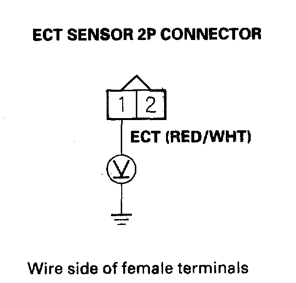

Temperature gauge goes up high when cold and cooling fan comes on after running for 20 minutes upper hose warm bottom hose cold turn off engine fan stay running replaced thermostat/temperature switched/water pump/air intake sensor still getting the codes 118 and 113.

There is a chance of a short to the IAC and IAT. I'm going to provide the diagnostics for both codes. Let me know if it is something you are comfortable doing.
I want you to note that when looking at the connector views below, both sensors are located right next to each other. I can't be sure, but I suspect that is where you will find the issue.
The attached pics correlate with the directions.

DTC P0118: ECT Sensor Circuit High Voltage
1. Turn the ignition switch ON (II).
2. Check the ECT SENSOR in the DATA LIST with the HDS.
Is about -40 °F (-40 °C) or less, or 4.90 V or higher indicated?
YES - Go to step 3.
NO - Intermittent failure, system is OK at this time. Check for poor connections or loose terminals at the ECT sensor and the ECM/PCM.
3. Turn the ignition switch OFF.
4. Disconnect the ECT sensor 2P connector.
pic 1
5. Connect ECT sensor 2P connector terminals No.1 and No.2 with a jumper wire.
6. Turn the ignition switch ON (II).
7. Check the ECT SENSOR in the DATA LIST with the HDS.
YES - Go to step 8.
NO - Go to step 13.

11. Measure voltage between ECT sensor 2P connector terminal No.1 and body ground.
Is there about 5 V?
YES - Repair open in the wire between the ECM/PCM (D10) and the ECT sensor, then go to step 15.
NO - Go to step 12.
pic 3
12. Measure voltage between ECM/PCM connector terminal D17 and body ground.
Is there about 5 V?
YES - Repair open in the wire between the ECM/PCM (D17) and the ECT sensor, then go to step 15.
NO - Go to step 19.

4. Disconnect the IAT sensor 2P connector.
pic 4
5. Connect AT sensor 2P connector terminals No.1 and No.2 with a jumper wire.
7. Check the IAT SENSOR in the DATA LIST with the HDS.
YES - Go to step 8.
NO - Go to step 13.

11. Measure voltage between IAT sensor 2P connector terminal No.1 and body ground.
Is there about 5 V?
YES - Repair open in the wire between the ECM/PCM (D10) and the IAT sensor, then go to step 15.
NO - Go to step 12.
pic 6
12. Measure voltage between ECM/PCM connector terminal D16 and body ground.
Is there about 5 V?
YES - Repair open in the wire between the ECM/PCM (D16) and the IAT sensor, then go to step 15.
NO - Go to step 19.
