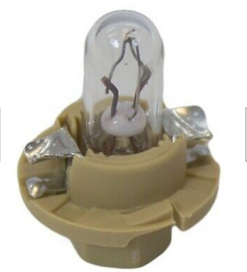

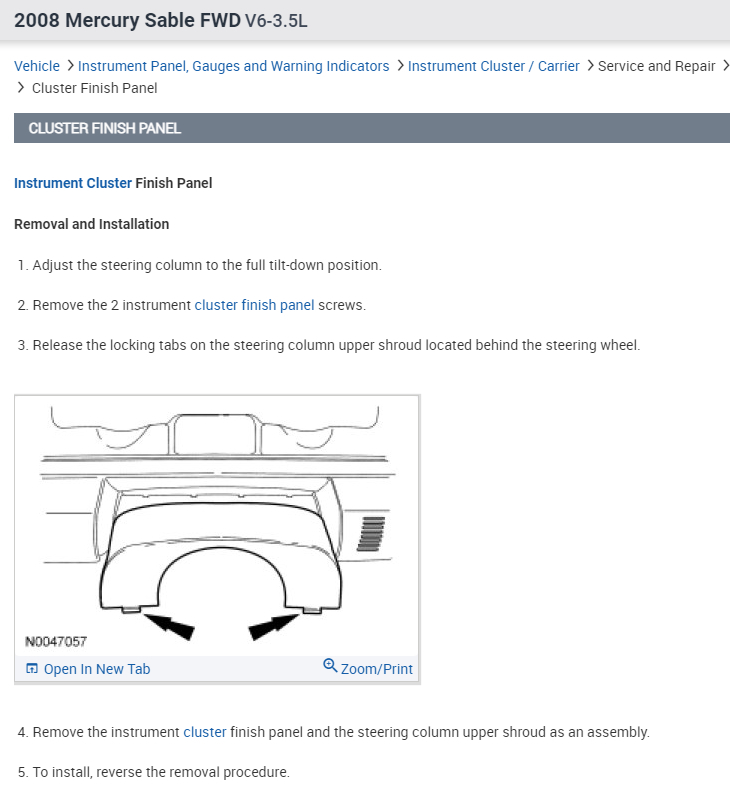

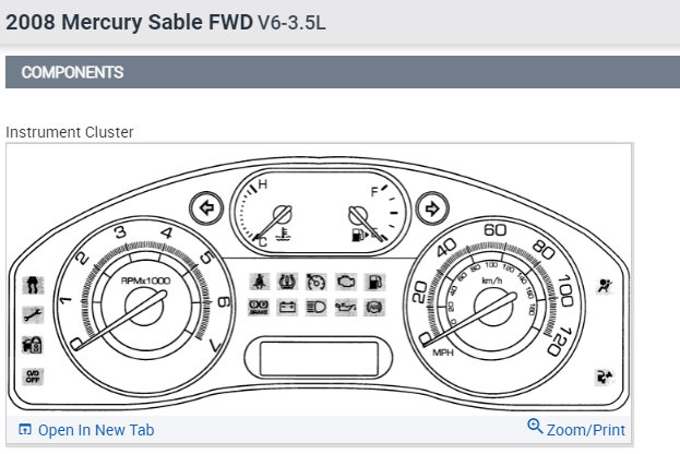

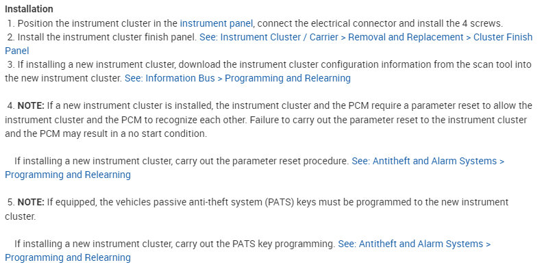

My illumination lights are out behind my temperature gauge and the fuel gauge. Can you direct me on how to get to the instrument panel? And what light I need to replace it?
Oct 16, 2021 at 11:43 PM
SQM
  • 6,383 POSTS

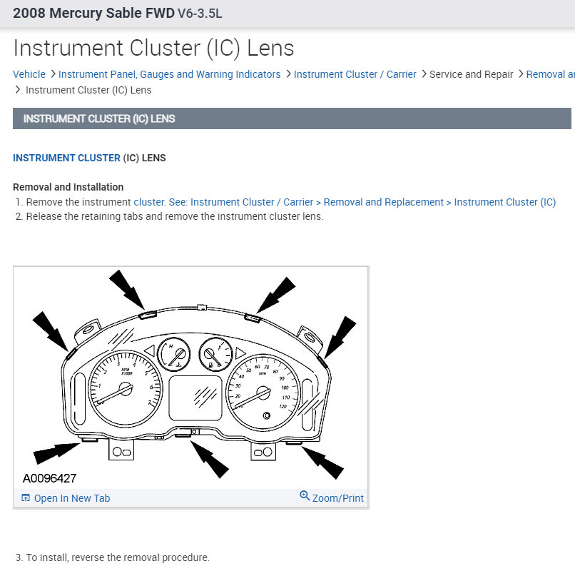

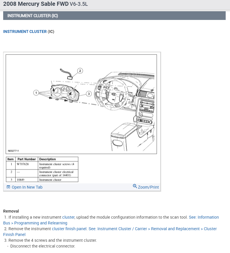

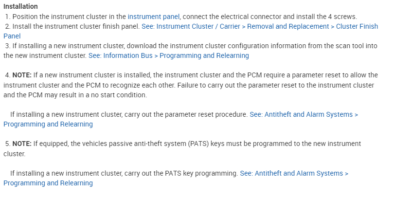

To get the cluster out you will have to remove the trim around it first, then remove the screws that keeps the cluster in place (see diagrams below). Then undo the harness from the top of the cluster to remove it.
Be sure to disconnect your battery before getting started.
The bulb will simply twist out of the back panel. The factory part #6L2Z13466A.
Of course, there are plenty of after-market equivalent you can get from parts store or online.
