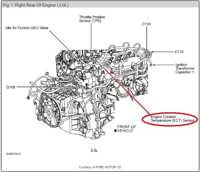

As soon as I turn the key to the on position the temperature gauge for the coolant goes to halfway point and stays no matter the temperature of the engine. I replaced the temperature sensor and still the same. I was wondering if my vehicle has a temperature sender too? If it does could this be my problem?

SENDER IS FOR THE GAUGE
YOUR CAR DOES NOT CARE IF YOU HAVE AN ACCURATE GAUGE! (IT IS THERE FOR YOU TO MONITOR FOR AN "OVERHEAT SITUATION") IT ( SENDER AND GAUGE) HAS NO INFLUENCE ON PERFORMANCE
THE SENSOR TELLS MR. COMPUTER THE ENGINE TEMPERATURE SO IT CAN CREATE THE BEST AIR/ FUEL MIXTURE (WHILE ALSO USING INPUT FROM THE OTHER SENSORS ON BOARD)
HERE IS THE "SENSOR" THAT TELLS THE COMPUTER THE TEMPERATURE.
http://shop.advanceautoparts.com/p/carquest-by-bwd-temperature-sensor-wt5067/15970002-P?searchTerm=coolant+temperature+sensor
BELOW I FOUND THE "SENSOR" IN A DIAGRAM FROM "PRODEMAND"
I WAS UNABLE TO FIND A DIAGRAM FOR THE "SENDER" (SORRY!)
THIS HELP ANY?
THE MEDIC

I believe I located it, but the problem is that it looks nothing like the part they sell at Autozone or online, it has a connection for a single wire, all the parts I have seen online have two wires. I unplugged it though thinking that if I did so the temperature should not move at all, but unfortunately still the same thing. I have been told that I could have a bad cluster, and may need replacing. What's your input on that?

I GOT ON THE FORD SITE
VERY COMPLICATED IN NAVIGATING IT
I WAS UNABLE TO FIND ANYTHING AFTER SPENDING OVER AN HOUR THERE
IT WOULDA BEEN NICE TO HAVE FOUND SOMETHING, EVEN NICER IF I COULDA FIGGERED THE DARN SITE OUT, I WAS MORE LOST COMING OUT THAN GOING IN
HERE'S WHAT I FOUND AS FAR AS "LOOKS" GO (2 WIRE)
