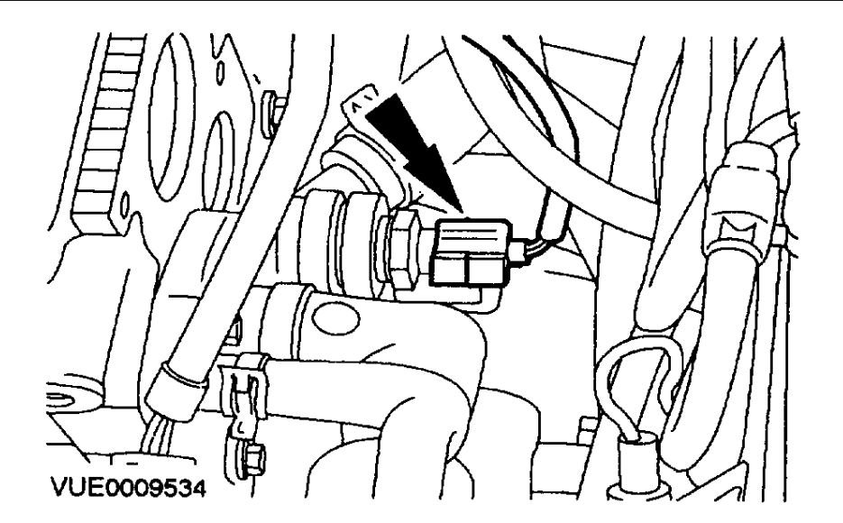

My cooling fans will not start up unless I unplug the temperature sensor. The gauge does not work at all. I am not sure if the same sensor is responsible for both signals(fan and gauge).
I probed the wires to the temperature sensor and started the car. There was a constant 4.6 volts that did not change significantly as the car warmed up to operating temperature. unless I unplugged the temperature sensor, then it would rise to about 5 volts.

Yes, it sounds like the sensor is bad. The voltage is correct but the sensor is sending the wrong signal to the PCM.
Replace the sensor.

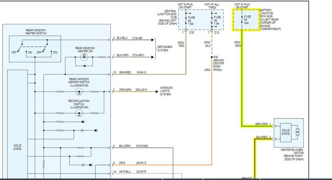

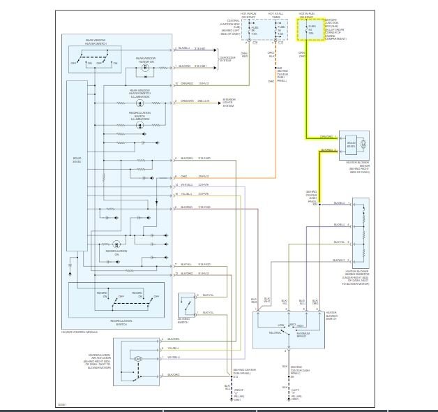

As far as the blower, I attached a diagram for you to view. Verify the fuse has power to both sides and you have power to the motor.

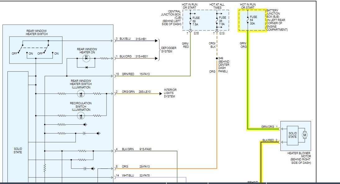

I am trying to check for power to the blower motor, but I cannot find the color of wires that are in the wiring diagram. My blower motor has two yellow wires with a green trace, a black/orange wire and a green/black wire. I think the green and black wire might be ground. When I tried to use my meter to find the power wire, I turned the key and the fan on with the blower unplugged, I probed all four pins in the harness one at a time. there was no power in the harness. I then turned off the key and checked the fuse...it was burnt and there was still a little smoke rising from under the fuse box. I don't know if I burnt the fuse probing the harness or if there is a direct short somewhere. If that is the correct and complete wiring diagram I must be looking at it wrong. Can you check if the wiring diagram is the right one?
Jun 23, 2019 at 6:20 AM
Yes, that is the correct diagram for the car.

Thanks, I guess I just don't know how to read it then. According to what I am seeing, should I be looking for 12 volt power at the green/orange and ground at black/red. Is that correct? I have only located two harnesses. One goes to the resister and one as far as I can tell goes to the blower motor and I don't see those colors of wires. I have seen a green/orange wire in the fuse box in the correct location for the blower motor.

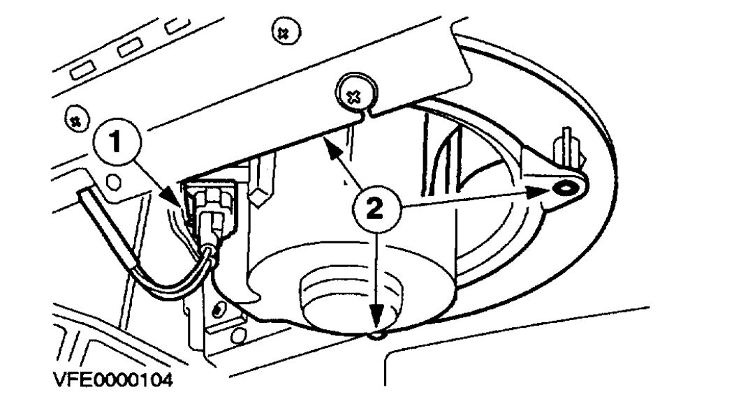

Can you post a picture of the blower motor connector?
Jun 23, 2019 at 6:57 AM
DAVEMALLARY
  • 14 POSTS
I found the wires. I don't know what that other connector is that I thought was the right one. I also most likely found the problem. There was a lot of water in the fan. This car has been sitting for several years and somehow what looks like rain water has been getting in. Thanks, hopefully a new motor will take care of the problem.
