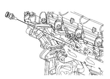

So the temp gauge used to go to 210 which is normal for this car. Every now and then it fluctuates between 0-210. And everything still works, Also every now and then the ac button will flash and not turn on and the temp gauge will be at 0. When I turn the car off, the fans stay running for safety. Doesn't pull any codes.

This sounds like a classic engine coolant temperature sensor issue. I would swap out the sensor and see what happened, drain the coolant first. Here is the location. Check out the images (below). Please let us know what happens.

So it finally pulled a code. Coolant engine sensor. So I replaced that, and the thermostat just in case. So far so good.
