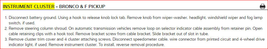

My temperature gauge is not working in my 83 F100. I have grounded the wire from the sending unit to ground and the gauge did not move. How do I remove the gauge cluster in order to check continuity of the wire from sending unit to the gauge? Thanks

Here is what I found on removing your Cluster. I have attached a step-by-step picture. Hope this helps and thanks for using 2CarPros.
